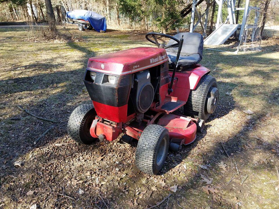

johnnymag3 2,646 #8 Posted April 29, 2021 Great....He wants 5 dollars for both, and they are rust free. I am looking to put them on my new to me 416-8 Single thumper 1 1 Share this post Link to post Share on other sites
johnnymag3 2,646 #9 Posted April 29, 2021 I am getting tractor heavyyyyyyyyyy.....Oh well....whats another one 1 1 Share this post Link to post Share on other sites
