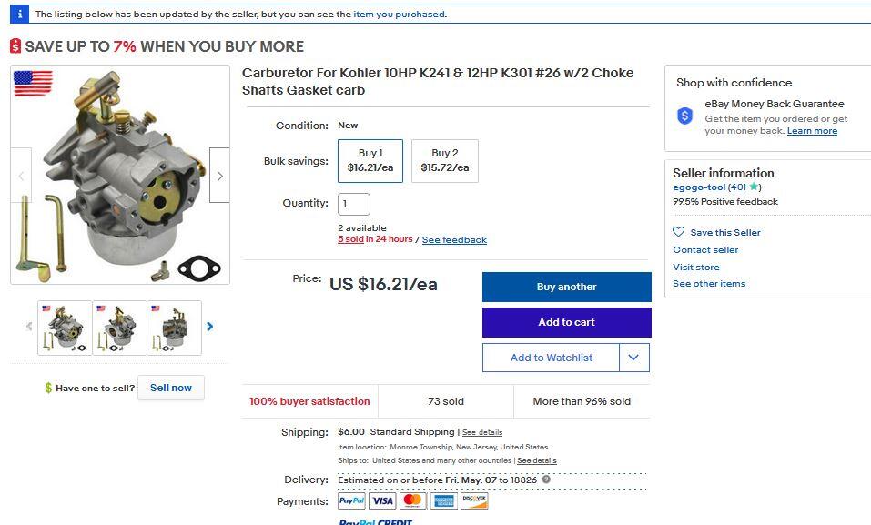

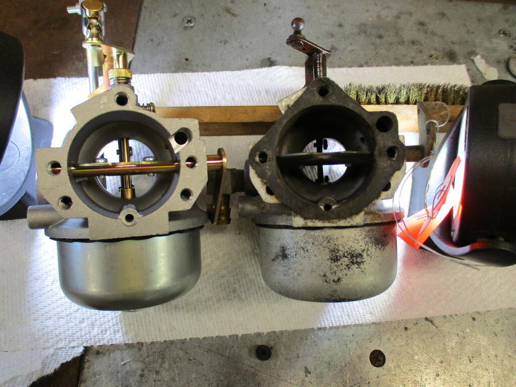

pfrederi 20,891 #1 Posted April 29, 2021 I know some have luck with Chinese carbs some of don't Blew $20 on an ebay K2421- K301 carb complete with US flag in picture (like I believed that) even had an extra choke shaft.. Showed up quick So I did some measurements compared to a for real old Kohler K301 carb labeled with #26, the correct carb for a 301. The nice looking cheapie carb wasn't even close size wise. Measured the throat the Kohler carb measured .8115 (Spec for #26 is .812 I am not the most accurate measurer in the world. The Cheapie measured 1.149 (which is close to a #30 carb) Difference is obvious in picture. By the way the float was set at 7/32 not 11/64 specified.... You pays your money you take you chances.... I may save this POS for a 14hp as the measurements are closer to the size they need. 2 6 Share this post Link to post Share on other sites

oldredrider 2,553 #4 Posted April 29, 2021 1 hour ago, pfrederi said: I know some have luck with Chinese carbs some of don't Blew $20 on an ebay K2421- K301 carb complete with US flag in picture (like I believed that) even had an extra choke shaft.. Showed up quick So I did some measurements compared to a for real old Kohler K301 carb labeled with #26, the correct carb for a 301. The nice looking cheapie carb wasn't even close size wise. Measured the throat the Kohler carb measured .8115 (Spec for #26 is .812 I am not the most accurate measurer in the world. The Cheapie measured 1.149 (which is close to a #30 carb) Difference is obvious in picture. By the way the float was set at 7/32 not 11/64 1 hour ago, pfrederi said: But, did you try it? Does it work? Need the "rest of the story". 1 Share this post Link to post Share on other sites

pfrederi 20,891 #6 Posted April 29, 2021 13 minutes ago, oldredrider said: But, did you try it? Does it work? Need the "rest of the story". Nope not wasting my time. Going to clean up the old one...The venturi size is so far off it may run but probably not well. When my next 14 hp is in for maintenance I may try it 1 Share this post Link to post Share on other sites

Tuneup 1,459 #8 Posted April 29, 2021 So, larger bore so less air velocity and signal. If it has large main and pilots, maybe not an issue. You'll know when you bolt it on. Share this post Link to post Share on other sites
