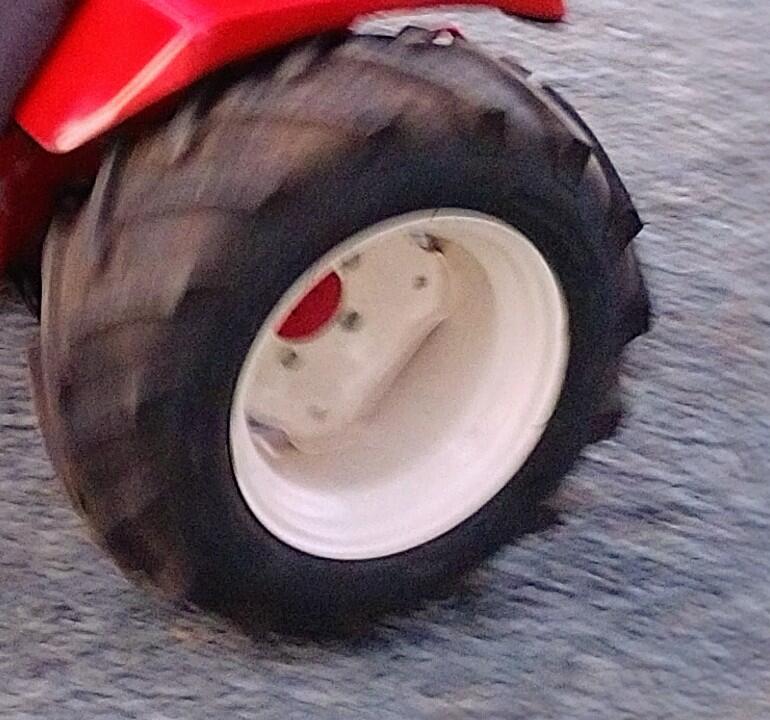

kpinnc 18,745 #10 Posted May 2, 2021 23x8.5-12 ags on standard 310-8 wheels will look like this. Mine are white, but you can see the fitment: Share this post Link to post Share on other sites
mort 24 #11 Posted May 3, 2021 When you are referring to a high offset are you referring to that 3" measurement on the above picture from Wednesday 9:02 am? The tires with rims that I am looking at the guy said they definitely fit Simplicity tractors. They are Kenda 23 X 10.5 -12 (4 ply) with 5 lugs with a 4.5" lug pattern/31/8" center hole. They look to be offset but I don't know how much. Do you think they will work? Mort Share this post Link to post Share on other sites
littleredrider 409 #12 Posted May 3, 2021 They have less offset than WH does, so might be able to push the hub out some. I have a set of 8.5" wheels off a Cub, they fit, but if don't push the hub out they will rub on the tank brackets. I had them on a 518 or 520, don't remember, but same tractor anyways. Share this post Link to post Share on other sites
