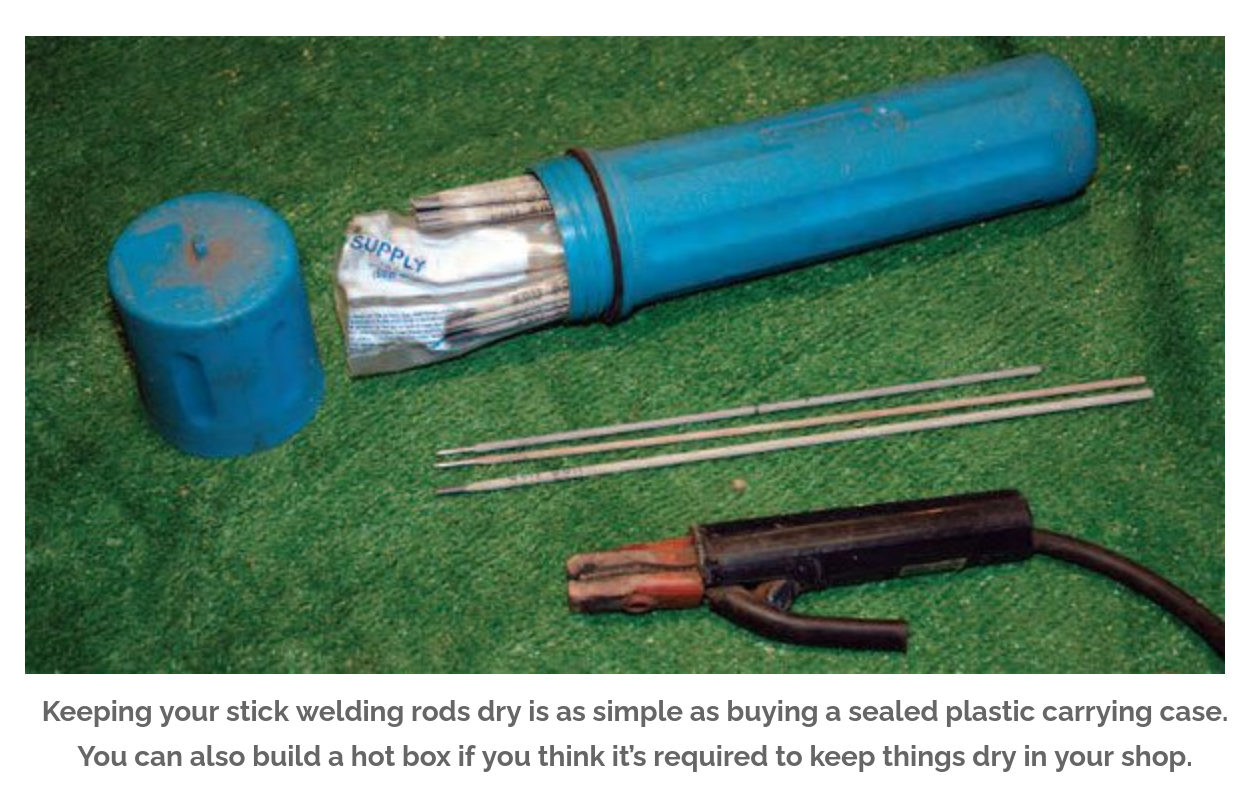

bc.gold 3,406 #5 Posted April 27, 2021 The key to good welds, practice and dry welding rods, in the old days the pipe line welders had a metal tube attached to the exhaust heat from the exhaust would keep the rods free of moisture. Welding shops use a rod oven for the same purpose, some backyard welders use a small fridge with a light bulb for the same purpose but I found these containers with the screw on tops work just a well for long term rod storage. 2 Share this post Link to post Share on other sites

bc.gold 3,406 #7 Posted April 27, 2021 1 hour ago, ebinmaine said: I keep my welding rods in the temperature and humidity controlled basement of the house. The humidity is actually the very reason why I use 7014 instead of 7018. I use 7018 which is a low hydrogen rod with excellent tensile strength, keep them free of moisture is important, your 7014 rods have a iron powder coating which actually adds as filler these rods can withstand high humidity. As for the 60 series welding rod we call these farmer rods. The E6013 welding rod is a multi-purpose rod suitable for welding of mild steel, galvanized steel, and some low alloy steels. Although its coating generates a very stable, forceful spray-like arc, this electrode is not as deep penetrating as the E6011 which can penetrate thick or unclean material. 2 Share this post Link to post Share on other sites
