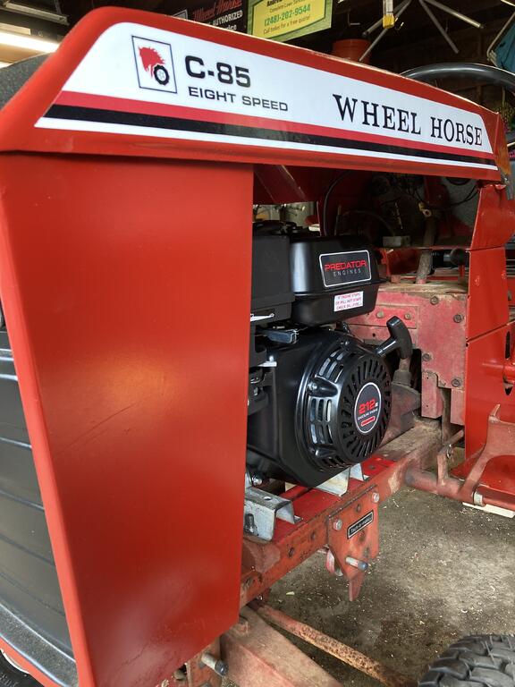

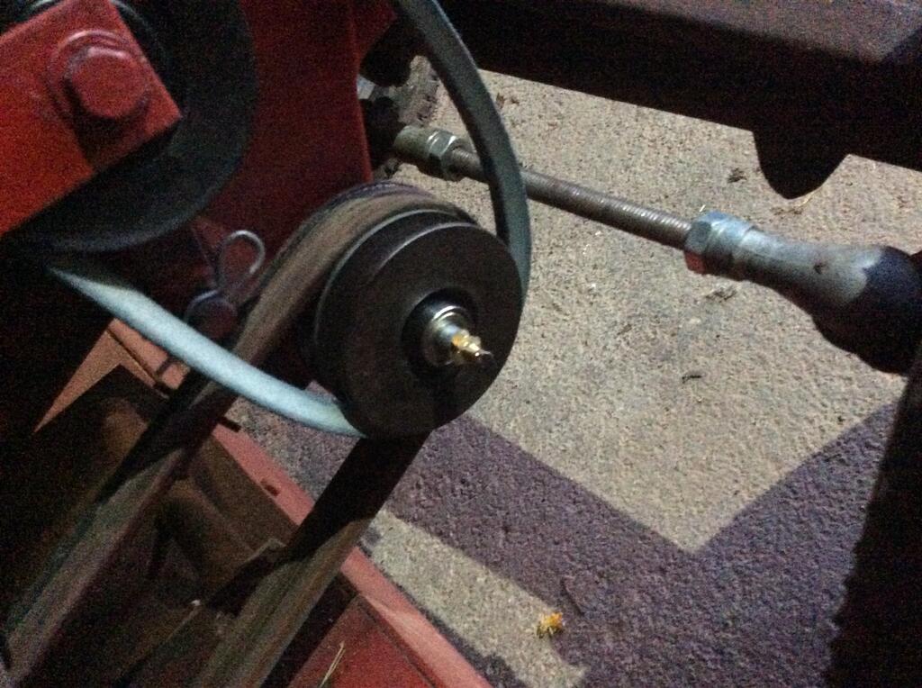

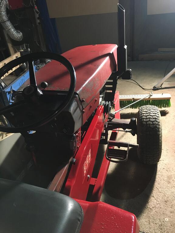

SylvanLakeWH 32,279 #128 Posted May 29, 2021 So I opted for a Predator… Batteries alone would have been a lot more…then converter etc… Electric conversion will await another day / tractor… Question: this Predator has a 3/4” shaft. Make more sense to sleeve it to 1” and use WH pulleys or just get a 3/4” pulley… thoughts? 1 Share this post Link to post Share on other sites

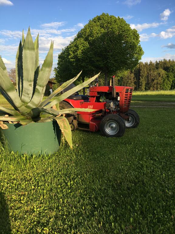

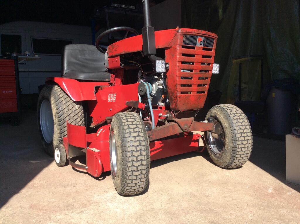

Tractorhead 9,217 #129 Posted May 29, 2021 Good choice. i use mine with 3/4“ and snaped a 70 mm taper Pulley on it. It was much cheaper with that diameter here, what is only a little larger as the Original my Teccy had, that was a 65mm. No Problems at all. only the Belt for the mowerdeck wears a little faster while mowing higher Grass, but the Engine didn‘t stall. 2 1 1 Share this post Link to post Share on other sites
Maxwell-8 4,371 #130 Posted May 30, 2021 (edited) On 5/29/2021 at 10:31 PM, SylvanLakeWH said: So I opted for a Predator… Batteries alone would have been a lot more…then converter etc… Electric conversion will await another day / tractor… Question: this Predator has a 3/4” shaft. Make more sense to sleeve it to 1” and use WH pulleys or just get a 3/4” pulley… thoughts? If a sleeve is easily available, I would go that road. Maybe you can get the PTO working. + WH pulleys are cast-iron, not that cheap metal. But in Europe, you have to get them custom made. Edited May 30, 2021 by Maxwell-8 1 1 Share this post Link to post Share on other sites
Tractorhead 9,217 #131 Posted May 31, 2021 19 hours ago, Maxwell-8 said: If a sleeve is easily available, I would go that road. Maybe you can get the PTO working. + WH pulleys are cast-iron, not that cheap metal. But in Europe, you have to get them custom made. As long as it was just for a Ride arround, a Taperpulley will be doing just fine. btw, they are also Cast iron not any sheet Metal, take a closer look at my Pictures.👍 1 1 Share this post Link to post Share on other sites

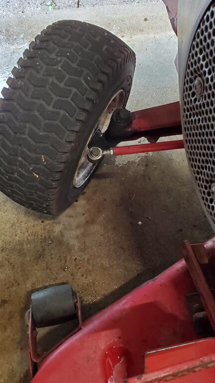

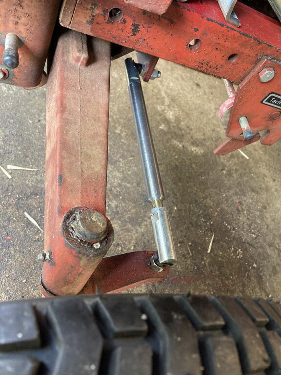

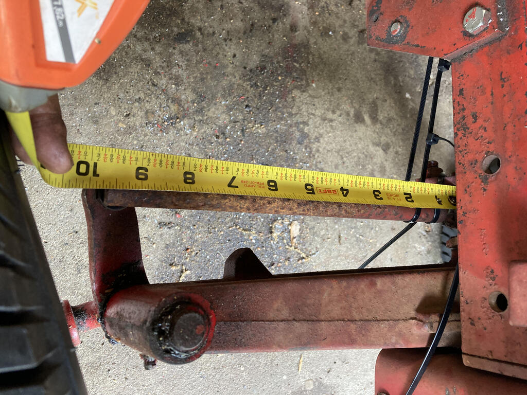

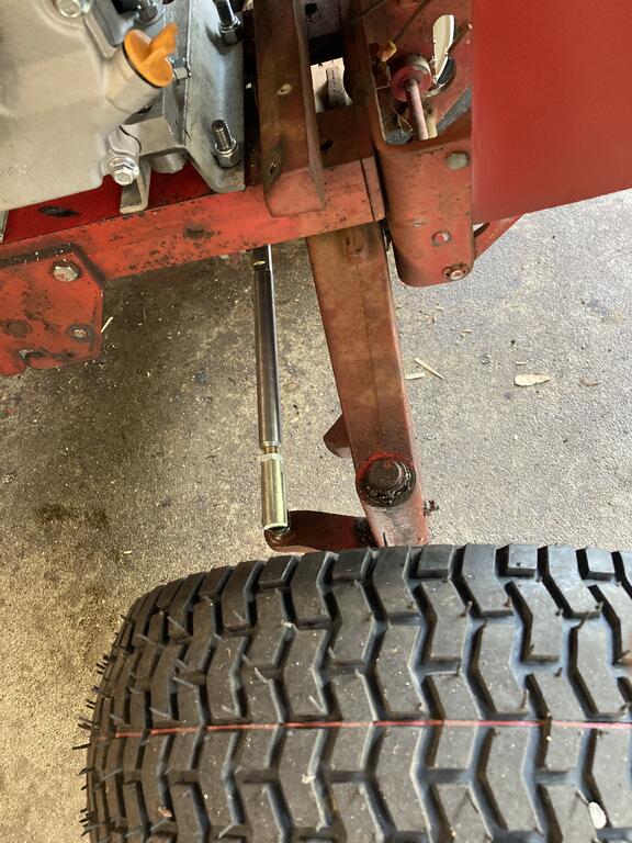

SylvanLakeWH 32,279 #132 Posted June 5, 2021 Predator swap a success! Bit of fine tuning but she really goes… Gotta adjust clutch - wheelies are not my thing anymore… Also gonna need tie rods… one came off and the zip ties are nice - they’re black so they match the hood - but I’ll do it right, I guess, if I have to… Good tie rod sources out there? Looking for options… 2 1 Share this post Link to post Share on other sites
bds1984 1,518 #133 Posted June 5, 2021 You can find direct replacements on Amazon OR you can get some helm joints and use them on your old tie rods. I didn't want to pay the $$$ for new tie rods for my C175. I shortened the original tie rod and tapped it out so now I have better joints AND can adjust the toe in/out. 1 1 Share this post Link to post Share on other sites

Tractorhead 9,217 #136 Posted June 6, 2021 (edited) I used 2 tie rod ends on the outside for a Golf Cart. The connection is made from a M10 inox threaded rod. that lasts and is free of play. A little drill up to 10mm was needed for a perfect Fit. price was for both sides 12$ for the rodends and 4$ for the Threaded rod Edited June 6, 2021 by Tractorhead 2 1 Share this post Link to post Share on other sites

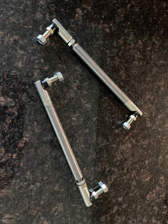

WHX?? 57,904 #137 Posted June 7, 2021 Lookin good Sylvia ... Lowell can hook you up with tie rods. On the pulley I got a place @Racinbob turned me on to get finnished pullies in whatever bore you want and whatever od you want. Get you a link you want. 1 1 Share this post Link to post Share on other sites

SylvanLakeWH 32,279 #142 Posted June 12, 2021 Goodies from Lowell arrived in today’s mail…! Thanks Wheelhorsepartsandmore!!! 2 Share this post Link to post Share on other sites
SylvanLakeWH 32,279 #143 Posted June 12, 2021 Installed the new tie rods from wheelhorsepartsandmore. Work perfect! Thanks to Lowell for the quick service!!! 1 Share this post Link to post Share on other sites

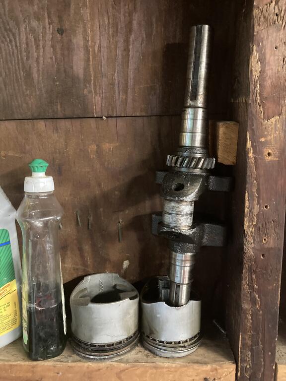

oliver2-44 11,710 #144 Posted June 12, 2021 On 5/27/2021 at 11:04 AM, Handy Don said: "And so we say a fond farewell to ...". Guess you can save the externals in a box and recycle the rest. On 5/27/2021 at 10:19 AM, SylvanLakeWH said: Proper burial forthcoming… Will use the shroud for a wall clock so all’s not lost… @SylvanLakeWH saved the shroud for his wall clock and that box of externals came to Texas to dress out a bare block a friend gave me. So no reusable kohler parts went to waste. I guess he's left with a holy block and camshaft left for a proper burial. 1 1 Share this post Link to post Share on other sites

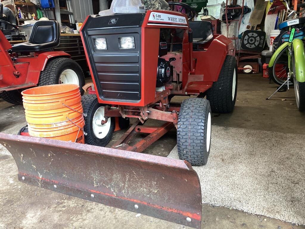

SylvanLakeWH 32,279 #145 Posted June 12, 2021 (edited) Picked up a blade off CL today… needs a bit of work but will be put on the c 6.5 and ready for the snow…! Edited June 12, 2021 by SylvanLakeWH 1 Share this post Link to post Share on other sites
cschannuth 3,821 #146 Posted June 12, 2021 1 hour ago, SylvanLakeWH said: Picked up a blade off CL today… needs a bit of work but will be put on the c 6.5 and ready for the snow…! You will love that thing for pushing snow. That light engine up front improves the traction on the rear and it really moves. I even have an upsized pulley on my 606 rat and it’ll push snow as fast as you’re brave enough to go. 1 1 Share this post Link to post Share on other sites

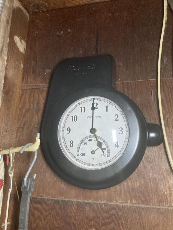

SylvanLakeWH 32,279 #147 Posted June 12, 2021 4 hours ago, oliver2-44 said: @SylvanLakeWH saved the shroud for his wall clock and that box of externals came to Texas to dress out a bare block a friend gave me. So no reusable kohler parts went to waste. I guess he's left with a holy block and camshaft left for a proper burial. So as sort of an update… Here’s the parts wall of shame… And the clock… brand new… uhm… cheap… and no longer works… lasted a whole week… so as not to waste energy and time thinking about it… I thought of Jimmy Buffet… 5:00 o’clock somewhere right? Well from now on it’s always 5:00 o’clock in the SL&WHN RR garage… no more battery changes and no more daylight savings time changes…! 1 2 1 Share this post Link to post Share on other sites
SylvanLakeWH 32,279 #148 Posted July 14, 2021 Added one of Lowell’s front blade brackets so I could hook up the front blade… ready for snow!!!!! 1 2 Share this post Link to post Share on other sites
