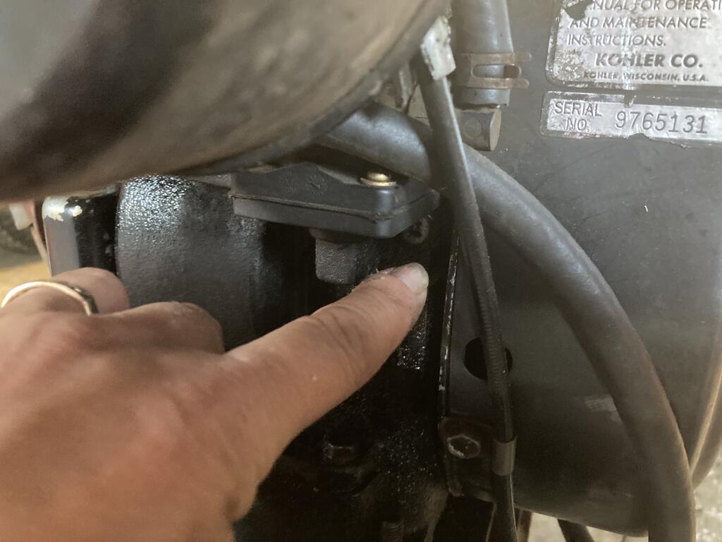

SylvanLakeWH 32,753 #76 Posted May 27, 2021 Sorry, should have been more specific… pointing to area in the pic below: Share this post Link to post Share on other sites
pfrederi 21,267 #77 Posted May 27, 2021 (edited) Fuel pump gasket Looks like a plastic pump they use a thin red odd shaped o ring type seal. make sure it stayed in place a touch grease may help hold it. If there are flaws in the block sealing surface they are not very forgiving. You might try a regular fuel pump gasket first, then the thin red o ring seal in addition... Edited May 27, 2021 by pfrederi 1 1 Share this post Link to post Share on other sites

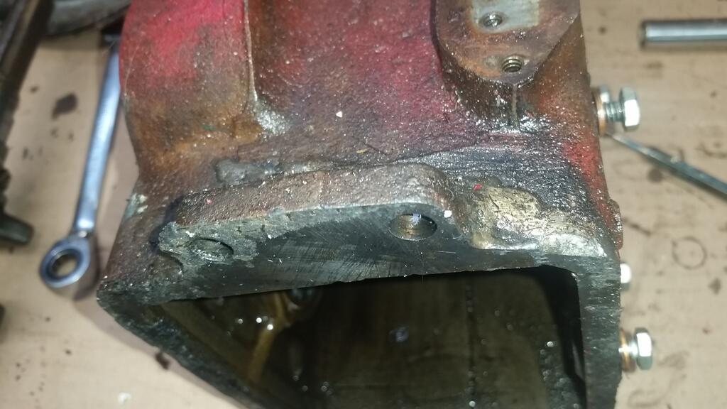

SylvanLakeWH 32,753 #78 Posted May 27, 2021 I’ll check that out… thank you @pfrederi. Seems like a lot of oil for a fuel pump gasket…? Going along fine then the engine started steadily bogging, then quit with a crunch… now just spins with starter motor, seems like without any resistance… if that makes sense… will investigate… 1 Share this post Link to post Share on other sites

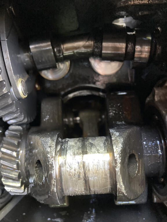

WHX?? 58,310 #79 Posted May 27, 2021 Oh oh ....sounds like maybe a rod went ...possible ventilated block ? Oh no say it ain't so. You did check the oil didn’t you? Time to pop the head and see if piston moves up and down but I fear the worst from what you are saying Sylvia. I don't like the crunch sound. Hopefully I'm dead nuts wrong 1 Share this post Link to post Share on other sites
SylvanLakeWH 32,753 #80 Posted May 27, 2021 22 minutes ago, WHX24 said: Oh oh ....sounds like maybe a rod went ...possible ventilated block ? Oh no say it ain't so. You did check the oil didn’t you? Time to pop the head and see if piston moves up and down but I fear the worst from what you are saying Sylvia. I don't like the crunch sound. Hopefully I'm dead nuts wrong That's what I fear... Yes I changed the oil and verified its level... (It actually wasn't that bad). Didn't seem to be burning oil either... Was running perfectly and then boom... Share this post Link to post Share on other sites
WHX?? 58,310 #81 Posted May 27, 2021 Yikes ... pop the head guy let's see what shakes. Let's just keep in mind all is not lost tho. 2 Share this post Link to post Share on other sites

Maxwell-8 4,371 #88 Posted May 27, 2021 Did the engine run lean? Why would it blow up? Strange location to bust thru the block if it trow a rod. 1 Share this post Link to post Share on other sites
squonk 48,272 #89 Posted May 27, 2021 If the rod hit the cam, that's the side for a hole. 1 1 Share this post Link to post Share on other sites

WHX?? 58,310 #92 Posted May 27, 2021 2 hours ago, Maxwell-8 said: Why would it blow up? Number of reasons.... ran in he past with little to no oil, scored big end, fatigued rod, abusive PO..... it happens all too often. 1 1 Share this post Link to post Share on other sites

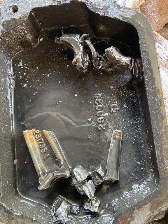

SylvanLakeWH 32,753 #93 Posted May 27, 2021 Toast for breakfast… No butter… No jam… 6 Share this post Link to post Share on other sites

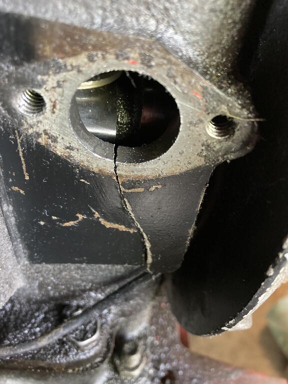

Gregor 4,848 #94 Posted May 27, 2021 OK We gotta see the inside of that thing. That seems like an odd spot to me.A little Elmers glue, call it a day. 3 Share this post Link to post Share on other sites
WHX?? 58,310 #95 Posted May 27, 2021 Crapola ... nothing to do with the issue Sylvia but did the fuel pump have an offset arm on it? 4 minutes ago, Gregor said: . That seems like an odd spot to me Agreed Greg.... one would of thought the cam would have snapped but protected that area? 1 Share this post Link to post Share on other sites

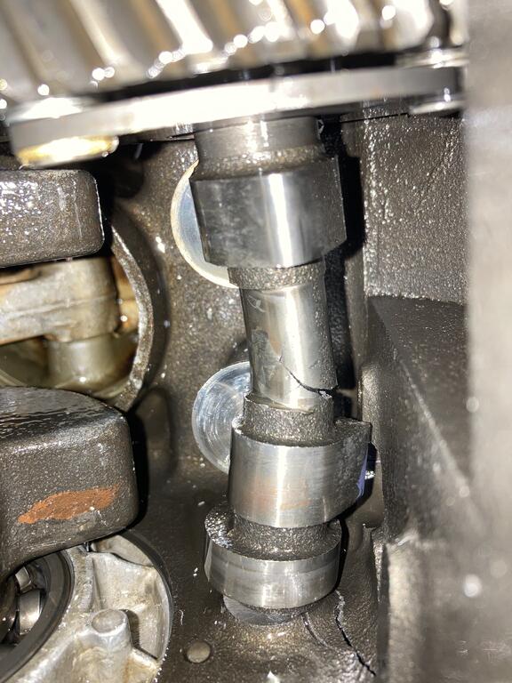

Gregor 4,848 #96 Posted May 27, 2021 Valve stem snapped? 1 Share this post Link to post Share on other sites

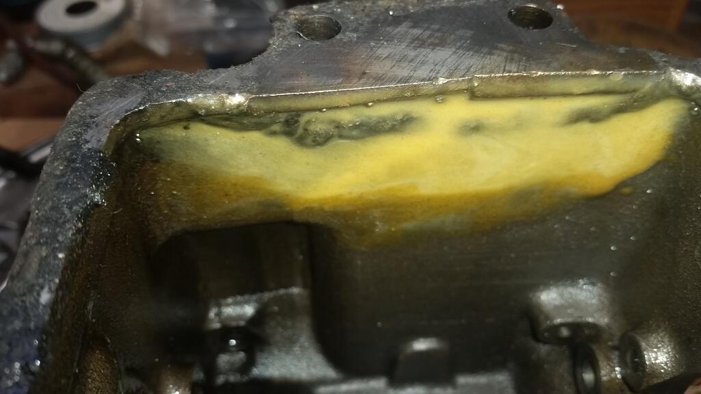

WHX?? 58,310 #97 Posted May 27, 2021 2 minutes ago, Gregor said: Valve stem snapped? 23 minutes ago, Gregor said: little Elmers glue, ok... JB weld! Not off topic here but this is what a PO did to a K91 block I have. Some kind of epoxy on the inside. How it ever broke here is beyond me. 1 Share this post Link to post Share on other sites
SylvanLakeWH 32,753 #98 Posted May 27, 2021 Well… I’m thinking JB weld might work… then again maybe not… Oh well… 4 Share this post Link to post Share on other sites
WHX?? 58,310 #99 Posted May 27, 2021 Triple crapola... yep best off looking for a donor motor now .... you'd have too much into that one. 1 Share this post Link to post Share on other sites
