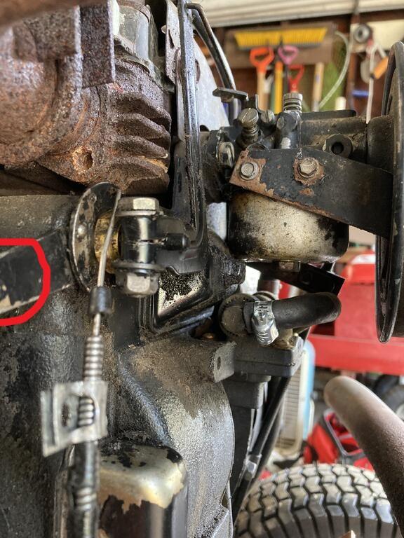

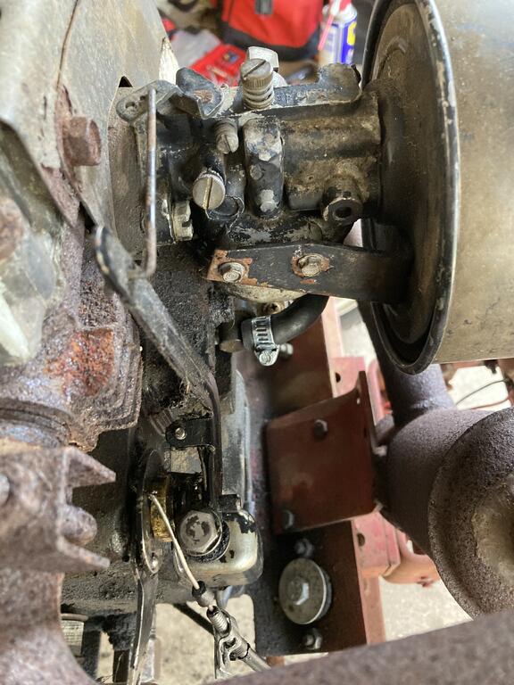

SylvanLakeWH 32,753 #52 Posted May 18, 2021 Little help please… Was running well. Then no throttle. Idle to high no change. Runs fine idle but no throttle. So went through the adjustment process in manual and no change. Cable is also slipping and does not seem correct for the governor adjustment arm… anyone have a k 181 you could post some pics on what it should look like? Here’s some pics of my problem: Share this post Link to post Share on other sites

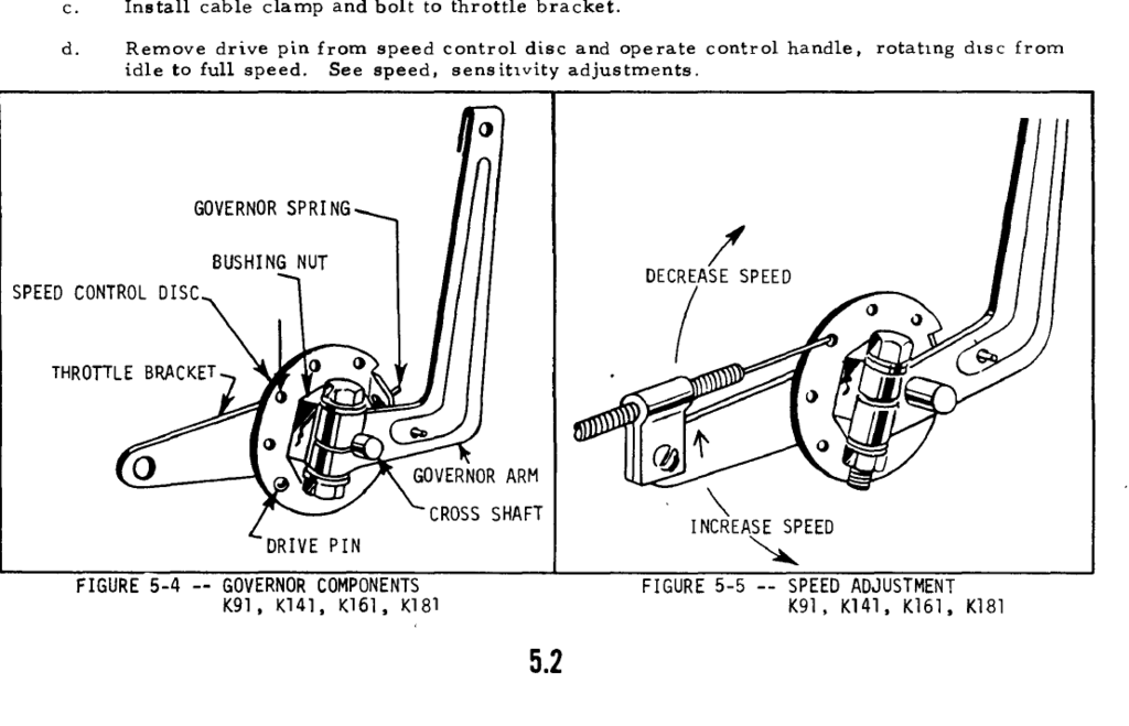

WHX?? 58,310 #54 Posted May 18, 2021 Throttle cable should be clamped to this arm. That arm can be moved by loosening the brass nut behind guv arm. That's what sets the max rpm. Check that the spring loop is in the slot of the plate with the holes in it. The other holes are for fine tweaking. 1 1 Share this post Link to post Share on other sites

SylvanLakeWH 32,753 #59 Posted May 19, 2021 3 hours ago, WHX24 said: Throttle cable should be clamped to this arm. That arm can be moved by loosening the brass nut behind guv arm. That's what sets the max rpm. Check that the spring loop is in the slot of the plate with the holes in it. The other holes are for fine tweaking. 3 hours ago, WHX24 said: 7 HP but same difference I see what you are saying, but when I tighten the arm with the brass nut it prevents the throttle plate (with holes in it) from turning… Also not sure what you’re referring to when you say the spring loop needs to be in the slot of the hole plate…? Appreciate the guidance… Share this post Link to post Share on other sites

WHX?? 58,310 #61 Posted May 19, 2021 The plate with the holes should be free to rotate around a boss on the brass nut. The arm that the cable attaches to should be pinched UNDER that boss so it can't move. you may have to remove the guv arm to verify all this is correct. The spring thingy dealy bob with the hook should be in that bent slotted thingy on the plate with the holes. The other end of the spring should be hooked on the guv arm. You should be able to if that is correct with having to take the arm off. You take the arm off you will need to reset it per the manual. Capiche?!? 1 Share this post Link to post Share on other sites

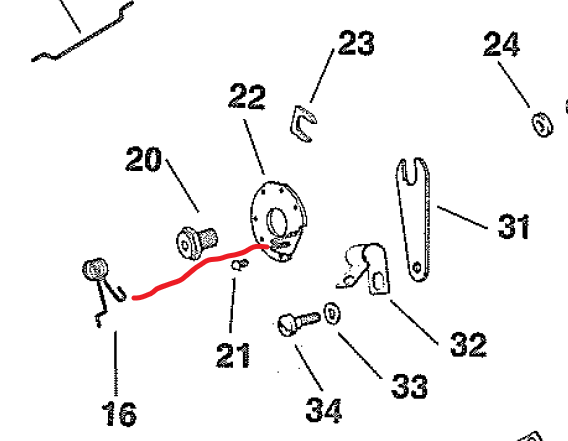

WHX?? 58,310 #62 Posted May 19, 2021 (edited) Not sure what that drive pin #21 is for never really noticed it on any of mine?? I can see it in your pic. Edited May 19, 2021 by WHX24 Share this post Link to post Share on other sites
peter lena 10,100 #63 Posted May 19, 2021 @WHX24, think I am looking at your cure to the " throw " to the speed control disc, your cable mount is on the OUTER SIDE of your last cable support giving it more strength and drive to move the stetting , think that is worth a try , by @ SLYVANLAKEWH . your close to vertical cable throw does not start the speed disc movement, more of a side thrust will get it going easier, pete 1 Share this post Link to post Share on other sites
peter lena 10,100 #64 Posted May 19, 2021 @SylvanLakeWH, think I would try to get the most out of a cable thrust or drive , your vertical position , it pushing UP , NOT TO THE SIDE , TO TURN THE DISC , think experimenting with that movement and added lubrication , will let you find your spot, pete 1 Share this post Link to post Share on other sites

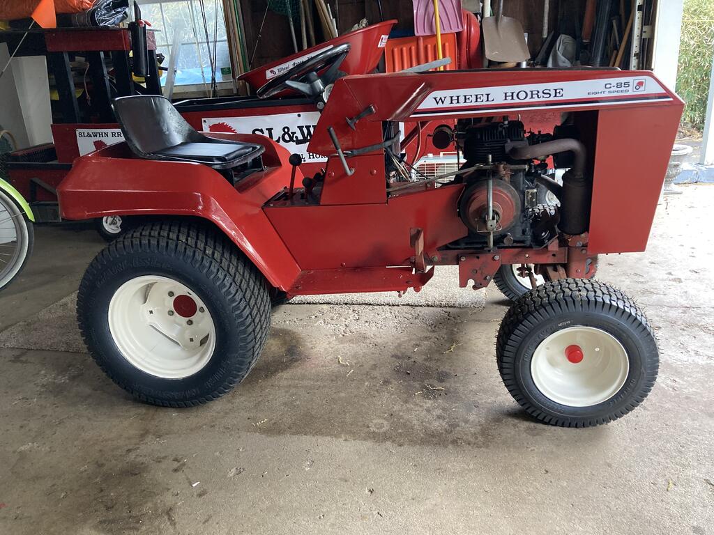

SylvanLakeWH 32,753 #65 Posted May 19, 2021 Well she “works”… Many thanks to @WHX24 and @peter lena for the help and guidance!!! Took her around the hood tonight and she runs great!!! Looks kinda good in the cleaned up garage… but… doesn’t seem to be any room for the better half’s car… hhhmmm… Fun project!!! 4 4 Share this post Link to post Share on other sites

peter lena 10,100 #69 Posted May 20, 2021 @SylvanLakeWH , glad it turned out for you ! thanks for the feed back, , your horses and set up looks good , just ask , pete 1 Share this post Link to post Share on other sites

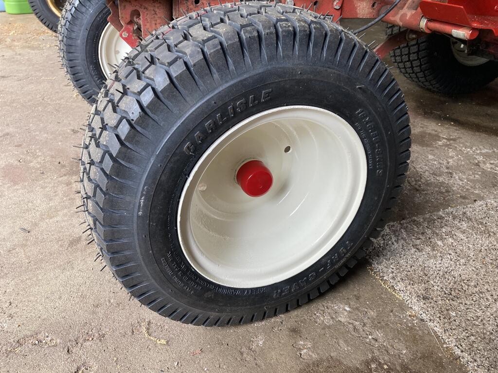

SylvanLakeWH 32,753 #70 Posted May 21, 2021 Hub caps… Red, of course… Details…details…details… 1 3 Share this post Link to post Share on other sites
WHX?? 58,310 #71 Posted May 21, 2021 Fender pan looks real sharp Sylvia, Hard to believe that's an orginal. 1 Share this post Link to post Share on other sites
