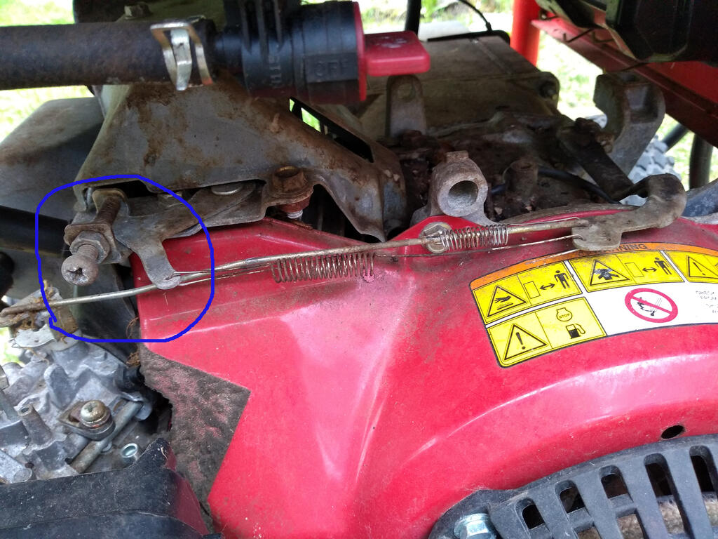

Handy Don 16,972 #30 Posted May 2, 2021 On 4/26/2021 at 12:51 PM, Chestnut said: I've had and fixed the dirty carb surging issues on several small engines, but the Subaru Robin on my generator didn't change after several cleanings. It actually was the governor on this one. My neighbor's Robin is surging. What did the governor need? Share this post Link to post Share on other sites

Chestnut 315 #32 Posted May 2, 2021 10 hours ago, Handy Don said: My neighbor's Robin is surging. What did the governor need? The screw on the left adjusts the length (tension) of the spring to the governor arm. There's a stop nut holding the screw in position. I just loosened the stop nut and made a small adjustment to the screw with the engine running. Good idea to mark the screw position before you start. I could hear it smooth out as I went. I can't remember whether I had the inductive tachometer when I did it, but I have one now and I'd use it if I had to do it again. 10 hours ago, Handy Don said: If fuel injection was cheaper, they'd all be using it! It's coming. My mother in law had to replace her lawn tractor a few years ago. The Cub Cadet she bought has EFI. Share this post Link to post Share on other sites
Handy Don 16,972 #33 Posted May 2, 2021 4 hours ago, Chestnut said: The screw on the left adjusts the length (tension) of the spring to the governor arm. There's a stop nut holding the screw in position. I just loosened the stop nut and made a small adjustment to the screw with the engine running. Good idea to mark the screw position before you start. I could hear it smooth out as I went. I can't remember whether I had the inductive tachometer when I did it, but I have one now and I'd use it if I had to do it again. It's coming. My mother in law had to replace her lawn tractor a few years ago. The Cub Cadet she bought has EFI. Thanks, now I can offer to help him out! On generators I just plug my VOM into the AC outlet and look for where it hits 60hz and the right voltage. Share this post Link to post Share on other sites
