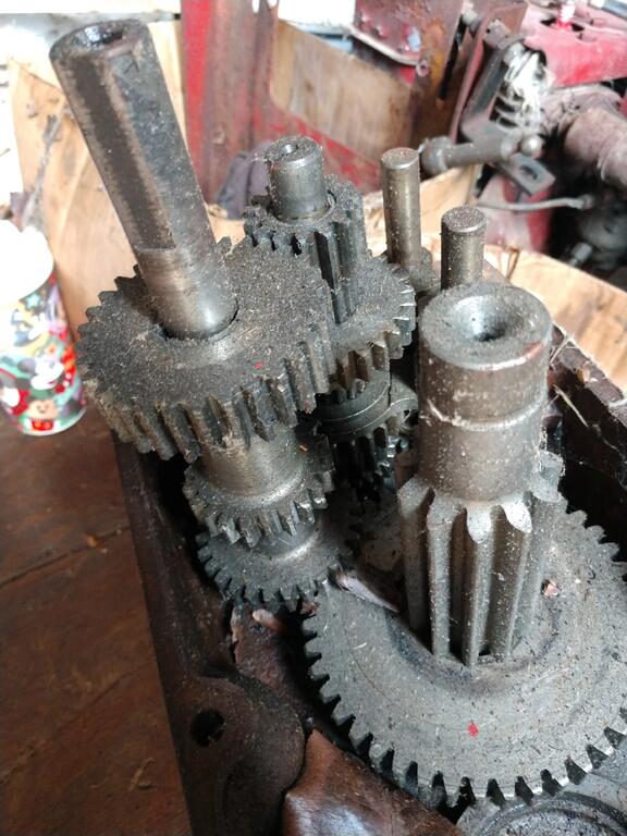

kpinnc 18,859 #101 Posted May 2, 2021 I have these if you need them. The original owner drove it with a busted axle bearing, so the diff end caps and axles were ruined. The rest of the gears look fine. Dirty, but decent shape. 1 Share this post Link to post Share on other sites

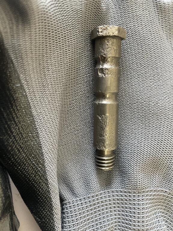

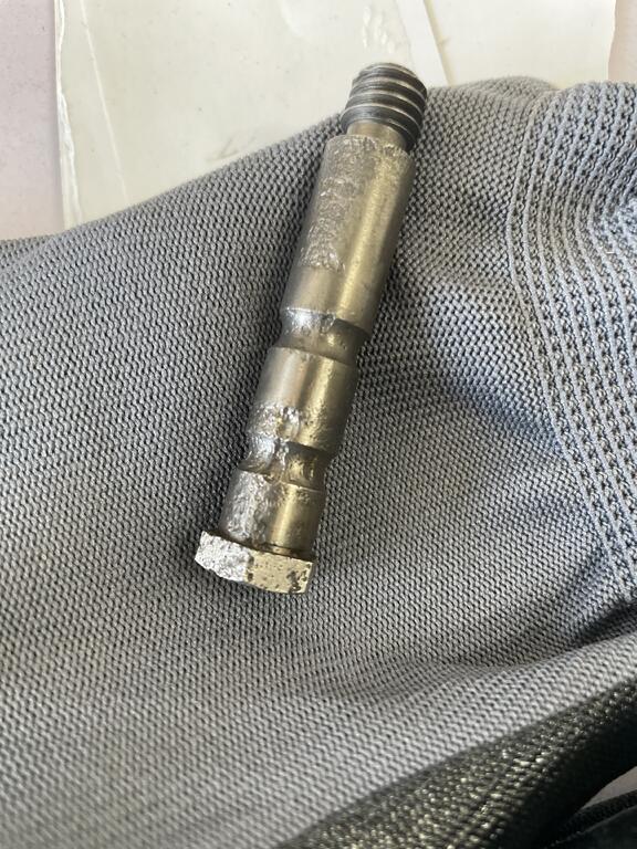

Wellingtontx 69 #107 Posted May 30, 2021 Started rebuild and examine the indent bolt for low/high and questioning whether I should order a new part. What say the Experts ? thanks Duke Share this post Link to post Share on other sites
stevasaurus 23,786 #108 Posted May 30, 2021 You would probably be OK with that. It's the grooves that mater here. If you decide to keep that bolt, I would replace the 1/4" ball for sure. I think I would replace the bolt if I could easily find one. Actually, TORO may have new ones...it would be worth a call. You can find those balls for cheap at ACE and such places. Share this post Link to post Share on other sites
Wellingtontx 69 #109 Posted May 30, 2021 Thank you prompt reply. I do have the replacement balls on hand. The bolt can be ordered - but a little pricey. I think I may put a hold on things and just break down and order the bolt. Only want to rebuild once. LOL 1 Share this post Link to post Share on other sites
stevasaurus 23,786 #110 Posted May 30, 2021 Duke, that whole piece comes as one unit from TORO...$57. Takes about 2 or 3 days to get. Share this post Link to post Share on other sites
Wellingtontx 69 #111 Posted May 30, 2021 Trying to find on Toro. Any idea on what part number they use ? I have tried 3-40; 7209 and 11636. Share this post Link to post Share on other sites
stevasaurus 23,786 #112 Posted May 30, 2021 Try using #3503. Share this post Link to post Share on other sites
Wellingtontx 69 #113 Posted May 30, 2021 Mmmm. 3503 comes up as the fork shift, part 3-50. I will keep looking. Thanks Stevd Share this post Link to post Share on other sites
stevasaurus 23,786 #114 Posted May 30, 2021 That is what you want...it is a one piece unit. Not sure what schematic you are looking at. 3-33 is just a page number with a part numbered. When you go to the 3-33 you will see Part # 3503...that is the hi/low shift fork assembly. $57 On the other hand, there are plenty of guys that have changed out that part, they might have the bolt that comes with that. Just need to ask in the Classifieds, and in here if you want. Share this post Link to post Share on other sites
Wellingtontx 69 #115 Posted May 30, 2021 OK ! Thanks Steve Share this post Link to post Share on other sites
stevasaurus 23,786 #116 Posted May 30, 2021 OK...I see what you are looking at...3-57 is the détente bolt...that is TORO Part #7213. that is just the bolt...that will fix what you have. 3-33 is the whole unit...TORO Part #3503. Does that make sense?? Share this post Link to post Share on other sites
stevasaurus 23,786 #117 Posted May 30, 2021 Part #3-33 is the full part of the sum of 3-57, 3-59, 3-61 & 3-60. Share this post Link to post Share on other sites

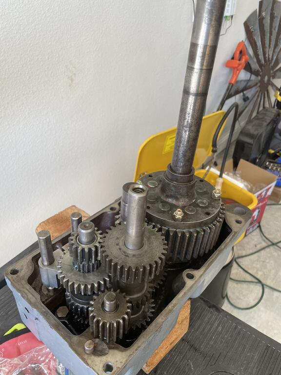

Wellingtontx 69 #120 Posted June 13, 2021 Finally got a chance to put it together. Still have some work to do. Thanks to everyone for their help and much needed advice. Duke 1 2 Share this post Link to post Share on other sites
Oldskool 6,678 #121 Posted June 13, 2021 21 minutes ago, Wellingtontx said: Finally got a chance to put it together. Still have some work to do. Thanks to everyone for their help and much needed advice. Duke Now that's looking alot better then what you started with. Not much more to do. 1 Share this post Link to post Share on other sites

stevasaurus 23,786 #124 Posted June 14, 2021 90 wt gear oil is the oil of choice. 80/90 wt is just fine. Your transmission looks fantastic...nice job. Once you close it up, turn the input shaft counter-clockwise in all gears before you put it back in the horse. If it all works, and it looks like it will, add 2 qts and start out easy until the oil works itself in. Share this post Link to post Share on other sites
