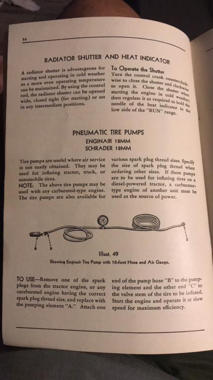

Lane Ranger 12,094 #1 Posted April 24, 2021 This is a surprise to me and maybe you too! In the old days of farming a flat or low tire could be a problem. This was before air compressors were widely available. International Harvester had a special attachment that hooked up to a spark plug port . It was a hose with gauge that was used to pump up the tire with air compressed by motor turning over. How’s that for ingenuity! 1 4 1 Share this post Link to post Share on other sites
ranger 1,862 #2 Posted April 24, 2021 (edited) I had one in the early 1970s, as you say, it replaced a spark plug and used the “Pulse” from that cylinder to operate a diaphragm to pump clean air from outside of the engine. Same principle as some fuel pumps. Never did work very well. Doug. Edited April 24, 2021 by ranger 1 Share this post Link to post Share on other sites

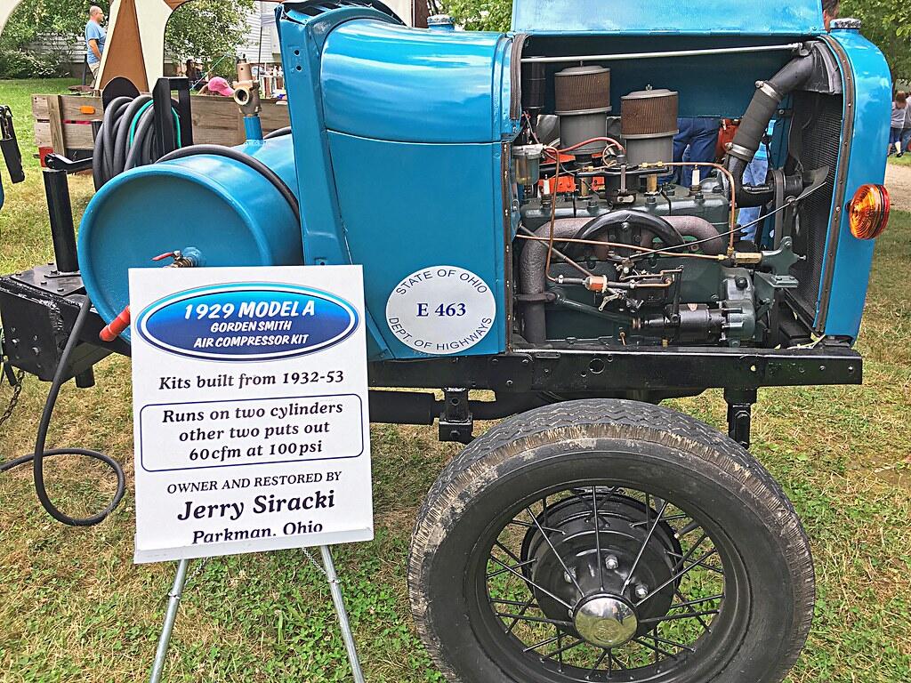

bds1984 1,518 #4 Posted April 25, 2021 Many Ford Model A engines were set-up for air compressor use. Cylinders 2 & 3 were the compressors that were powered by 1 & 4. VW Beetle engines have also been set up like this, too. 4 1 2 Share this post Link to post Share on other sites
