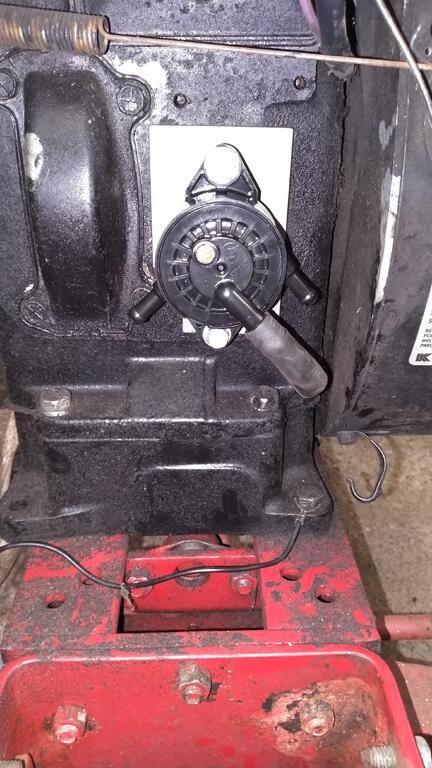

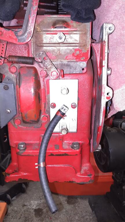

Bill D 3,158 #17 Posted May 6, 2021 On 5/2/2021 at 9:23 PM, bds1984 said: After mowing yesterday and running the tractor for an hour, I did not have the stalling issue I experienced before. The electric pump has taken care of that issue, however, I am not a fan of it driving my voltage gauge crazy. On another note, has anyone ever installed a vacuum pulse fuel pump on a K or Magnum series engine that previously had a mechanical pump? If so, where did you tap into the engine for the vacuum/pulse? In the past I have been tempted to braze/solder a 1/4" hose barb onto one of the valve covers of my KTs/Magnum Twins so I could utilize a vacuum pump. Any thoughts? I have been making these plates to use vacuum pumps on the K/M series. I've done it on two different M12 engines and it works great. No need to solder a pipe on the valve cover of your KT 17. Simply remove the old pump and make a small plate to cover the opening. If the old pump gasket stays intact and stuck to the block, you won't even need to make a gasket. Buy a 1/8" pipe tap and tap a hole in the center of the plate for a barbed fitting. The plate I made is made of stainless steel. No painting required. Use any good quality vacuum pump. Pumps used on Briggs and Kawasaki engines work well. As a side note, use a longer hose between the engine and the pulse port on the pump to prevent oil from coming out of the breather on the pump. Bill Share this post Link to post Share on other sites

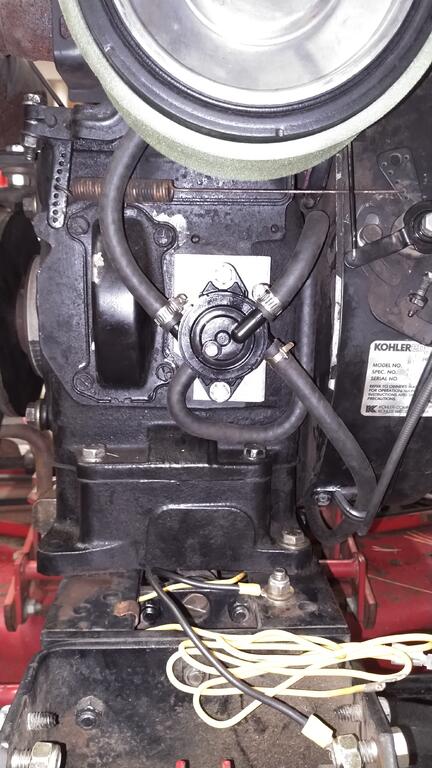

Bill D 3,158 #18 Posted May 6, 2021 Another picture. Pump is a Kawasaki pump. Longer hose between the engine and pulse port on the pump prevented oil from coming out if the breather port in the pump, the brass colored disc in the picture. Bill Share this post Link to post Share on other sites
bds1984 1,519 #19 Posted May 6, 2021 (edited) On 5/6/2021 at 2:18 PM, Bill D said: I have been making these plates to use vacuum pumps on the K/M series. I've done it on two different M12 engines and it works great. No need to solder a pipe on the valve cover of your KT 17. Simply remove the old pump and make a small plate to cover the opening. If the old pump gasket stays intact and stuck to the block, you won't even need to make a gasket. Buy a 1/8" pipe tap and tap a hole in the center of the plate for a barbed fitting. The plate I made is made of stainless steel. No painting required. Use any good quality vacuum pump. Pumps used on Briggs and Kawasaki engines work well. As a side note, use a longer hose between the engine and the pulse port on the pump to prevent oil from coming out of the breather on the pump. Bill Thanks Bill. I am working on this setup as we speak. Well, waiting on the tap to get here. Prime has turned into 3-4 days for many items for me now. I made a plate from 1/4" steel earlier today and have the hose barb, just not the tap. What I cannot quite figure out is what port in fuel in and which is out. There are no markings at all but shouldn't be too difficult to figure out. Edited May 10, 2021 by bds1984 Share this post Link to post Share on other sites
Bill D 3,158 #20 Posted May 6, 2021 There are small arrows cast into the inlet and outlet. They are hard to see but they are there. The pulse line is on top of the pump, inlet on the right, outlet on the left. Bill Share this post Link to post Share on other sites
theoldwizard2 2 #21 Posted May 10, 2021 On 5/6/2021 at 5:34 PM, Bill D said: There are small arrows cast into the inlet and outlet. They are hard to see but they are there. The pulse line is on top of the pump, inlet on the right, outlet on the left. Bill Correct ! The metalic colored hole on the topic is thevent for the pulse line. This pump is common on some B&S engines. The original design/manufacturer is Mikuni. Prices range from about $15 - $50, so shop wisely ! Share this post Link to post Share on other sites
bds1984 1,519 #22 Posted May 10, 2021 I'm well aware of there being arrows on pumps. The M18 on my 520 has a vacuum pump I installed many years ago has arrows but the pumps that just arrived do not so it looks like I'll be experimenting. I guess that is what happens when a guy tries to save a few dollars... Share this post Link to post Share on other sites
bds1984 1,519 #23 Posted May 21, 2021 Well, I took a gamble with the vacuum fuel pump installation and fuel flows correctly given their being no indication of flow. So now I am off to mow in the nearly 90-degree heat today. After rebuilding the center spindle and replacing the idler pulley on the deck, cutting the grass is SO much quieter. Share this post Link to post Share on other sites
