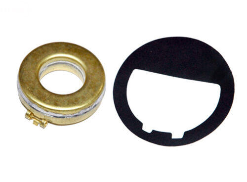

Bentoolong 94 #29 Posted April 29, 2021 1 hour ago, seuadr said: hey i recognize that machine! i saw it a couple days before you picked it up when @ACman was showing me around. Looks like a project for sure, but a solid machine! That's it. When I saw it I got a tractor rescue response and I knew what I had to do. It is a solid machine. It won't win any beauty contests but that isn't what these tractors are for. I changed my mind and ordered a carb overhaul kit instead of a aftermarket carb. These kits come with a float baffle gasket but my carb currently doesn't have one. I'm not even sure how its held in place. I've had a small carb apart before and I know where it goes but in this case, I'm not sure how it would be held in place. I know it goes in the upper part of the float bowl before the float gets installed. Is this a case of vendors just sending more than the required amount of parts to accommodate variations in carbs. I think some of these engines (K241) had Carter products and some had Walbro. Bentoolong Share this post Link to post Share on other sites
pfrederi 20,869 #30 Posted April 29, 2021 Walbro carbs do not use the slash shield....Don't know why Share this post Link to post Share on other sites
Bentoolong 94 #31 Posted April 29, 2021 So I'm still not sure if I should attempt to use this. How can I ID the carb I have? Could someone take a look at the pics above and advise? I'm not ruling out that my carb needs one but a PO just didn't use it. Thanks Share this post Link to post Share on other sites
pfrederi 20,869 #32 Posted April 29, 2021 8 minutes ago, Bentoolong said: So I'm still not sure if I should attempt to use this. How can I ID the carb I have? Could someone take a look at the pics above and advise? I'm not ruling out that my carb needs one but a PO just didn't use it. Thanks Looking at your carb with High speed needle on top it is a kohler carb and should have the splash shield. O ring goes in the housing first then the splash shield the bowl clamps it in place. Share this post Link to post Share on other sites
