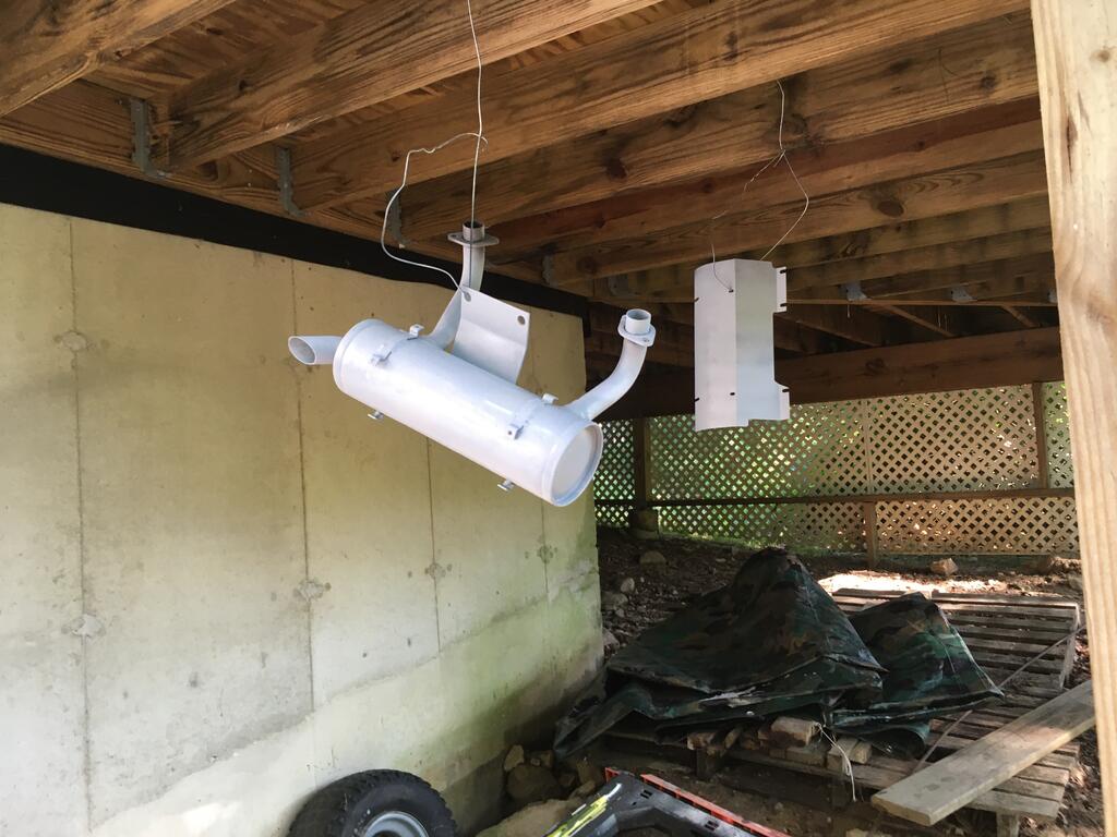

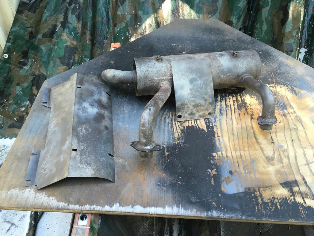

WheelHorse520H 710 #134 Posted July 28, 2021 Did some sandblasting today once the rain cleared… well it was more of a drizzle than anything. For some reason some of the primer didn’t come off or the metal has been discolored which is why it has the weird pattern. Now I am priming the exhaust again. 2 Share this post Link to post Share on other sites

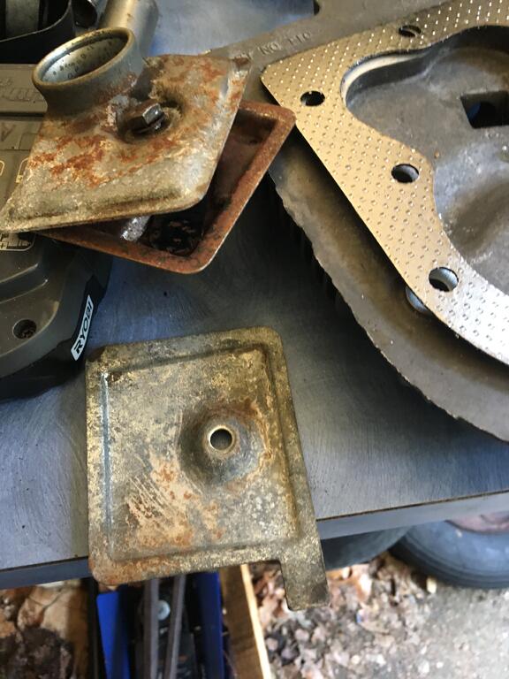

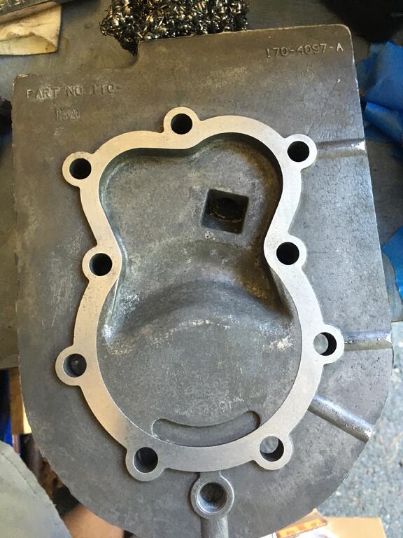

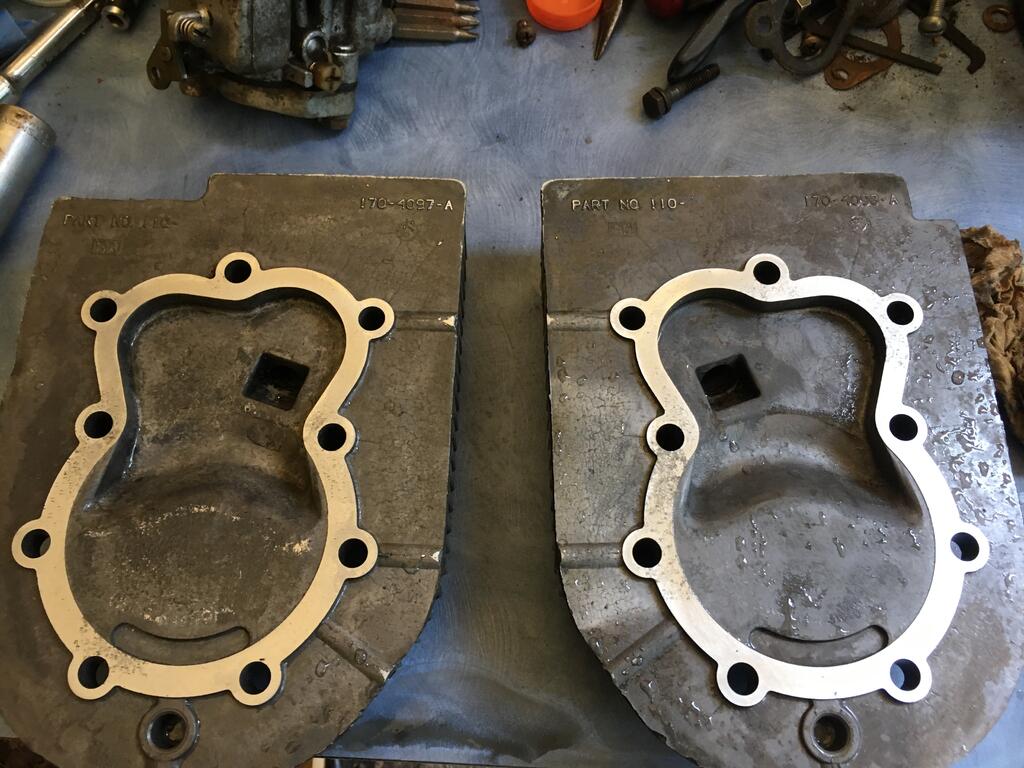

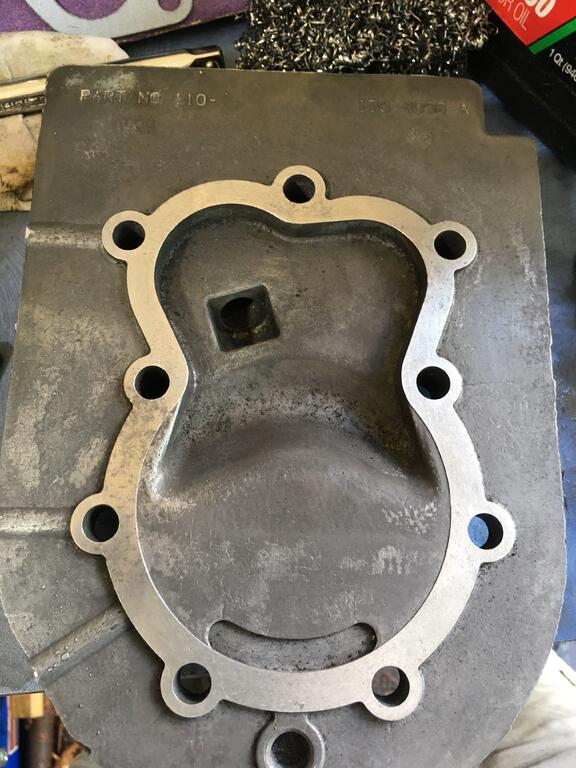

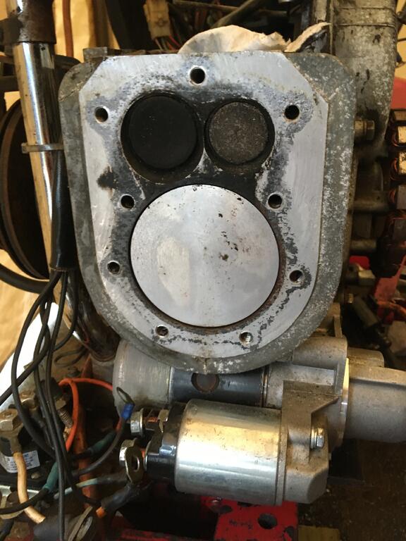

WheelHorse520H 710 #135 Posted July 29, 2021 (edited) I made the heads as true as I could, the dark areas are little pits. I think they are good to go back on, I got my gaskets a few minutes ago. Is there anything I should do to clean the mating surface on the engine block? Also, the valve covers rusted a little, should I worry about that? Edited July 29, 2021 by WheelHorse520H 1 Share this post Link to post Share on other sites

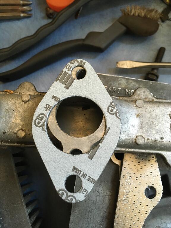

WheelHorse520H 710 #136 Posted July 29, 2021 Glad I went through the gaskets, the one between the carb and intake is too big. Suggestions? Share this post Link to post Share on other sites
Handy Don 17,490 #137 Posted July 29, 2021 (edited) Isn't there a spacer that raises the carb up off the manifold? That gasket looks like the one between the carb and the spacer, not the spacer and the manifold. The external rust on the valve covers isn't serious, but you should clean the gasket-facing surfaces. Also, you have the manual so follow the torque specs carefully when reassembling--the valve cover nuts are little more than finger tight! Edited July 29, 2021 by Handy Don 1 Share this post Link to post Share on other sites
Jeff-C175 7,211 #138 Posted July 29, 2021 1 hour ago, WheelHorse520H said: the valve covers rusted a little, should I worry about that That won't affect the performance, only the appearance, so it's up to you how good you want it to look! Share this post Link to post Share on other sites
WheelHorse520H 710 #139 Posted July 29, 2021 (edited) 51 minutes ago, Handy Don said: Isn't there a spacer that raises the carb up off the manifold? That gasket looks like the one between the carb and the spacer, not the spacer and the manifold. Yes, that would be it. I did not see it at first. 48 minutes ago, Jeff-C175 said: That won't affect the performance, only the appearance, so it's up to you how good you want it to look! Honestly they’re so far down you barely see them. Is it okay to put the cylinder heads back on even though they are not perfect? Edited July 29, 2021 by WheelHorse520H Made a mistake. Share this post Link to post Share on other sites
lynnmor 9,042 #140 Posted July 30, 2021 Obviously that gasket is totally wrong, the correct gasket will have a hole that is larger than necessary, but the bolt holes need to be correct. I always clean and paint the valve covers because water can puddle in the depressions and cause rust. The block has burrs raised up around the bolt holes, I use a countersink and cut them to just over the bolt diameter. I then run a tap in those holes to clean the threads so that the bolts can be properly torqued. I use one drop of oil on the bolt threads per Onan manual. The same countersinking and tapping is also done on all the intake and exhaust holes as well. Do not cheat on the torque specification, they have a tolerance and you should use the average, it is easy to strip the threads with just a little too much. 2 Share this post Link to post Share on other sites
WheelHorse520H 710 #141 Posted July 30, 2021 13 minutes ago, lynnmor said: Obviously that gasket is totally wrong, the correct gasket will have a hole that is larger than necessary, but the bolt holes need to be correct. I believe it is the one in between the carb and the spacer but I did not take it apart there. 15 minutes ago, lynnmor said: I always clean and paint the valve covers because water can puddle in the depressions and cause rust. I assume you only paint the outside because the inside has oil circulating. 17 minutes ago, lynnmor said: The block has burrs raised up around the bolt holes, I use a countersink and cut them to just over the bolt diameter. I then run a tap in those holes to clean the threads so that the bolts can be properly torqued. I use one drop of oil on the bolt threads per Onan manual. The same countersinking and tapping is also done on all the intake and exhaust holes as well. To be clear (mostly so I don’t make a mistake) you do this process for the intake, exhaust, valve covers, and the cylinder heads. Correct? Please see post 135 about the gasket surfaces on the engine block and the cylinder heads. Thanks, Andrew Share this post Link to post Share on other sites
lynnmor 9,042 #142 Posted July 30, 2021 8 hours ago, WheelHorse520H said: I believe it is the one in between the carb and the spacer but I did not take it apart there. I assume you only paint the outside because the inside has oil circulating. To be clear (mostly so I don’t make a mistake) you do this process for the intake, exhaust, valve covers, and the cylinder heads. Correct? Please see post 135 about the gasket surfaces on the engine block and the cylinder heads. Thanks, Andrew Do you have two pairs of bolts holding the carburetor on????? Of course there is no need to paint the inside. Cleaning tapped holes is good practice. I did see your post and saw the burrs. Share this post Link to post Share on other sites
WheelHorse520H 710 #143 Posted July 30, 2021 1 hour ago, lynnmor said: Do you have two pairs of bolts holding the carburetor on????? Yes, photos to follow later today. 1 hour ago, lynnmor said: Of course there is no need to paint the inside. Just had to be sure. 1 hour ago, lynnmor said: Cleaning tapped holes is good practice. I am not sure if I have a tap(s) the right size, what else can I do if I don’t? 1 hour ago, lynnmor said: I did see your post and saw the burrs. And you think they are okay to put on? Also do I need to clean the block or is that okay too? Thanks for all the help, Andrew Share this post Link to post Share on other sites
WheelHorse520H 710 #144 Posted July 30, 2021 10 hours ago, lynnmor said: I use one drop of oil on the bolt threads per Onan manual. What page? Share this post Link to post Share on other sites
lynnmor 9,042 #145 Posted July 30, 2021 1 hour ago, WheelHorse520H said: What page? Page 4-1 under the heading "Assembly Torques" in the first paragraph. I hesitate to recommend this, but I use a good quality flat file to dress the block surface. Without the proper skills, damage can result. Share this post Link to post Share on other sites
WheelHorse520H 710 #146 Posted July 30, 2021 4 minutes ago, lynnmor said: in the first paragraph. Ahh, thank you. 5 minutes ago, lynnmor said: I hesitate to recommend this, but I use a good quality flat file to dress the block surface. Without the proper skills, damage can result. I can tell you right now, I do not have the skills for that, is there anything else I can do? Share this post Link to post Share on other sites
lynnmor 9,042 #147 Posted July 30, 2021 11 minutes ago, WheelHorse520H said: I can tell you right now, I do not have the skills for that, is there anything else I can do? Use some fine steel wool and remove much of the dark spots. 1 Share this post Link to post Share on other sites
WheelHorse520H 710 #148 Posted July 30, 2021 2 hours ago, lynnmor said: Use some fine steel wool and remove much of the dark spots. Done. There are a few little spots left but I think it’s good. Paint on the valve covers is drying, installing those in 1 hour. I will try to separate the spacer on the carb so you can see what @Handy Don was talking about. 1 Share this post Link to post Share on other sites
