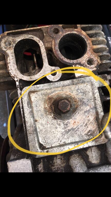

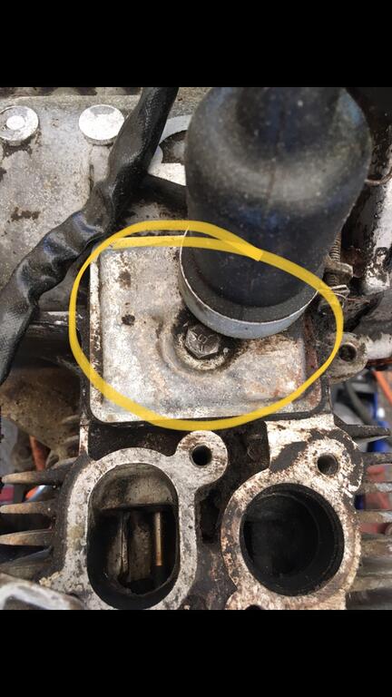

lynnmor 8,914 #92 Posted July 17, 2021 39 minutes ago, WheelHorse520H said: The seals on the back of the intake valve is clean, no seals needed right? You can’t tell by looking at the seal, what you are looking for is a heavy, black substance caked on the valve. Personally I don’t mess around when I have them tore down and simply remove the valves and grind them, then cut the seats and reinstall with fresh seals. I understand that most don’t want to go that far and don’t have the tools to do it right, 1 Share this post Link to post Share on other sites
WheelHorse520H 710 #93 Posted July 17, 2021 1 hour ago, lynnmor said: You can’t tell by looking at the seal, what you are looking for is a heavy, black substance caked on the valve. Ok, let’s start from the beginning here, I am confused. I am looking in the little box under the spot the valve covers came off (the yellow circles), correct? Then I should look at the part of the valve stem that goes into the spring, right? Share this post Link to post Share on other sites
lynnmor 8,914 #94 Posted July 17, 2021 No, you can see the back side of the valve in that oval shaped hole just above your yellow circle. I can see it in the photo but it isn’t quite clear enough to make a determination. 1 Share this post Link to post Share on other sites
WheelHorse520H 710 #95 Posted July 18, 2021 2 hours ago, lynnmor said: No, you can see the back side of the valve in that oval shaped hole just above your yellow circle. I can see it in the photo but it isn’t quite clear enough to make a determination. That would be the cause of my confusion, I was looking under the valve cover. Will check that out, but I was able to order the gaskets individually from Colburn power for only a couple of bucks more and I don’t have to wait a few weeks to order them. 1 Share this post Link to post Share on other sites

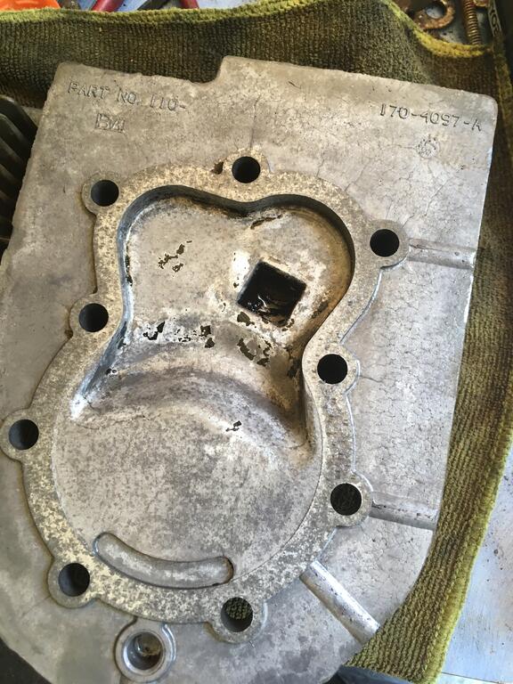

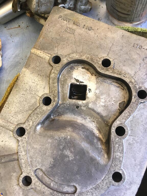

WheelHorse520H 710 #99 Posted July 20, 2021 I picked up some heavy duty oven cleaner this morning and cleaned the cylinder heads. Although there are a few spots that are dirty, should I worry about these and clean them more or not bother? Pictures below ⬇️ Also, I did make sure to not let the oven cleaner sit too long. 1 Share this post Link to post Share on other sites
lynnmor 8,914 #100 Posted July 20, 2021 I would scrape off the black spots using a putty knife or small chisel, just don't gouge the gasket surface. A little more oven cleaner in the spark plug holes might be good. 1 Share this post Link to post Share on other sites
