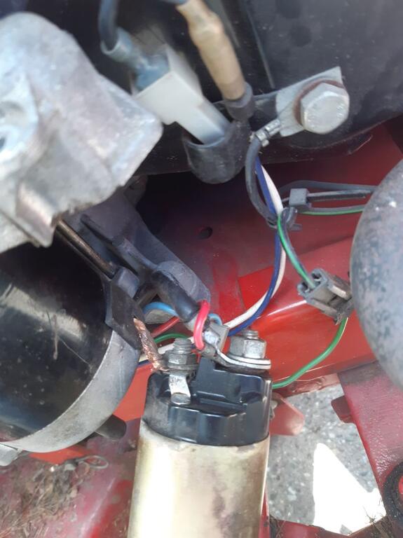

bertusjan78 0 #1 Posted April 23, 2021 (edited) hello i am from holland and have a toro wheel horse 212-5 and enjoing it but now ik is not starting i pulled the solonoid and when i manually press the plunjer it starts !! but now when i put the solonoid back the starter motor starts running ( not engaging the motor just the elektric motor ) so maybe the solonoid is broken and shorts the plus to the motor but what is that lever inside ?? where the top plastic cap is to be in ? i cannot open it to put it in and when i tried to take out the starter itself the backbolt wil not go al the way down and i can not see how to take the starter itself out to open it and test its working can someone help ? kind regards bertus Edited April 23, 2021 by bertusjan78 update fotos Share this post Link to post Share on other sites

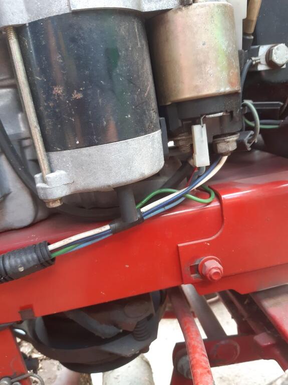

bertusjan78 0 #3 Posted April 23, 2021 hello thank you for your answer i have to look up the numbers but the starter is mounted different from the files the solenoid is boulted with 2 nuts from the top but the starter itself is boult douwn from untherneeth with 2 very long screws ( long bolt and nut ( but the back bolt wil not be removed when loosend and even then the starter will not drop far enough to be removed as seen on the photo the front bolt can be removed but there is one at the back and the starter wil not drop enough to be removed it seems the whole motor needs to be removed first ( i cannot believe that ) is rests on the red chassis Share this post Link to post Share on other sites

bertusjan78 0 #5 Posted April 23, 2021 (edited) here you see a side view with solenoid removed and startermotor still in place it can only be removed by screws on the bottom but even then it cannot drop enough te be removed becouse the chassis is in the way and how to get the top of the solonoid ( that plastic peace into the vork witch is on the inside top housing ? is that a lever that goes from solonoid to startermotor like a bendix in a normal automotive ?? Edited April 23, 2021 by bertusjan78 upload foto Share this post Link to post Share on other sites

Unicorna 0 #7 Posted June 12, 2021 On 4/23/2021 at 5:50 PM, gwest_ca said: This illustration shows shorter bolts holding the starter on. Two coming down from the top. https://www.partstree.com/models/32-12o501-212-5-toro-lawn-tractor-1990/starter-22/ Garry Also a nut holding oil tube from underneath side of starter. You need to remove cowl from top of motor. Just had mine off. Problem with mine was you have to make sure that you get the plunger inside Grove in starter. Can't just push it in. Share this post Link to post Share on other sites
Unicorna 0 #8 Posted June 12, 2021 On 4/23/2021 at 5:51 PM, bertusjan78 said: here you see a side view with solenoid removed and startermotor still in place it can only be removed by screws on the bottom but even then it cannot drop enough te be removed becouse the chassis is in the way and how to get the top of the solonoid ( that plastic peace into the vork witch is on the inside top housing ? is that a lever that goes from solonoid to startermotor like a bendix in a normal automotive ?? Top of solenoid is not a nut. That goes into the plastic fork inside the housing on the starter. To reinstall solenoid. The starter housing has to be removed from motor. I just did this on my 212. Took forever to figure it out. New solenoid did the same as the old one. Now I have a spare. Share this post Link to post Share on other sites
bertusjan78 0 #9 Posted June 13, 2021 hello and sorry for my late reply whe fixed the problem first silly me i tried to take the startermotor of but i dit dismantled id with the litle srews after some time sitting at the tractor i decided whell lets take it all appart motor everything and when we took the top of i saw the nuts for holding the starter in place so pfffffffffff luck the we took it down separated the realy cleaned evrthing inside with sandpaper and the starter run perfectly and now the relay was removed i could put the plastic pin / head in its right place so in the top vork then we started whell sometimes it did and sometimes not after checking the wiring i descoverd that the white power wire to te startersrelay ( where youre right foot is unther the hood ) was nog making a bad connection after examination it turned oud that all the female pins who are unther the realy were to wide and not connecting good for good messureases i orderd a new solonoid an replaced all the connectors and i starts perfectly !! as seen unther a happy camper thans a lot for helping out stay safe and thnx again !! best regards bertus Share this post Link to post Share on other sites
