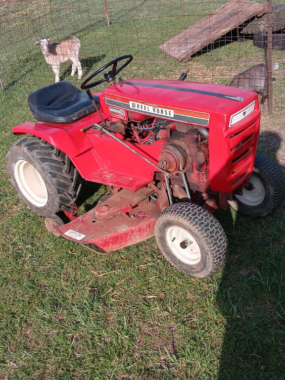

Adamw89 0 #1 Posted April 23, 2021 I have a charger 10 hydromatic wheel horse. I had to pull it back in the garage so i turned the nut ontop of the axel under the seat so it rolled freely. I turned the nut back in now it wont move and wheels remain unlocked Share this post Link to post Share on other sites

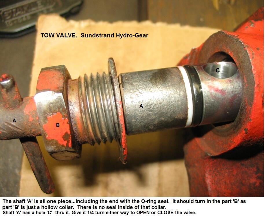

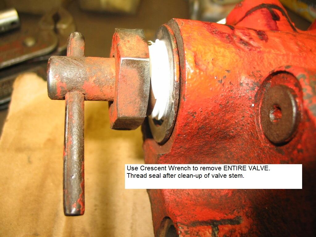

daveoman1966 3,884 #4 Posted April 23, 2021 Was the tractor runnng and moving correctly BEFORE you pulled it back to the garage? This is the push VALVE on top of the Hyd Pump End Cap. Is this what you turned to allow the tractor to roll freely? You would only have to turn the ROLLPIN just 90 degrees to allow free-roll. However, you still need to roll it SLOWLY. ps... These are the only pic of the PUSH valve I have...from a pump refurb of a few years agol. Share this post Link to post Share on other sites

Ed Kennell 47,554 #9 Posted April 23, 2021 7 hours ago, Adamw89 said: top part is missing with the pin. Looks like you need a new valve. Post a picture of your valve. 1 Share this post Link to post Share on other sites
