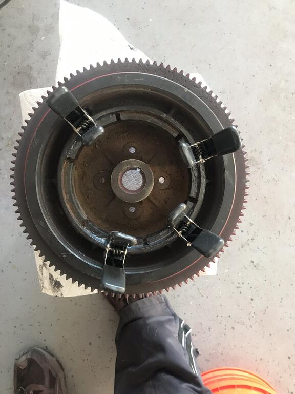

81blackhood
I used JB Weld on mine.  31C5F8CC-38B3-4B10-811F-9C9784D7E2DF.jpeg.7d5fd6ed6395d1e0dffc608e07d52979.jpeg
