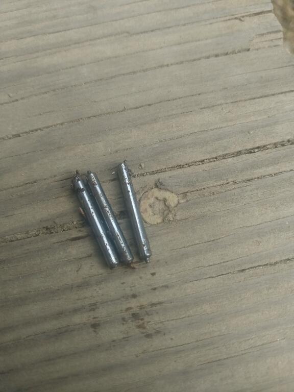

Irhon 2 #1 Posted April 21, 2021 Title really says it all. Was pushing some loose dirt when my GT-14 wheel horse quit moving. Hydraulics still worked fine. I lifted the back off the ground with the lift and grabbed the left rear wheel when to my surprise I could remove the wheel and axle. The shaft is broke about a 1/4" past the beginning of the splines. When i pulled the axle a handful of needle bearings also fell out. So now I'm searching for a new axle and have no idea where i might find one Share this post Link to post Share on other sites

stevasaurus 23,254 #12 Posted April 21, 2021 You might need more then an axle. Your axle broke right in front of your axle gear and maybe some pinions are damaged. I'm going to guess those needle bearings you found mean you have the #111199 needle bearing and not the #1533 ball bearing holding your differential carriage. This file is pinned at the top of the Transmission Section. 2 Share this post Link to post Share on other sites

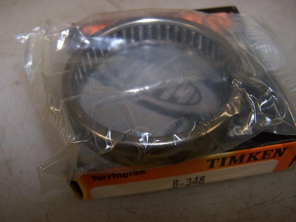

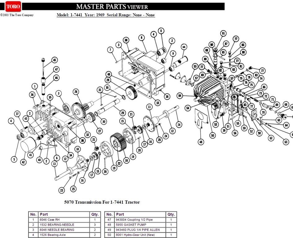

pfrederi 18,598 #14 Posted April 22, 2021 (edited) I believe the big bearing that the end of the differential rides on is B-348 WH#8048+3 in parts explosion Edited April 22, 2021 by pfrederi 2 Share this post Link to post Share on other sites
Irhon 2 #15 Posted April 22, 2021 After looking at the picture I'm leaning more towards #4 on the diagram. Needles in B-348 look too big 1 Share this post Link to post Share on other sites

pfrederi 18,598 #17 Posted April 22, 2021 They look like Outer axle bearings #1526 Torringtnn B-1816 Share this post Link to post Share on other sites
stevasaurus 23,254 #18 Posted April 22, 2021 I believe there is a service order in the manuals section that gives the serial number of the series when they went to the needle bearing. It was because of availability of the ball bearing (1533). You may or may not have it depending on that service order. I only mention it because you pulled out needle bearings...they could be from your outer axle bearing?? Kay Sara Sara...you'll find out when you open it. Share this post Link to post Share on other sites
