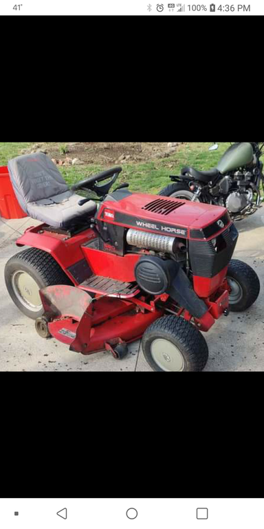

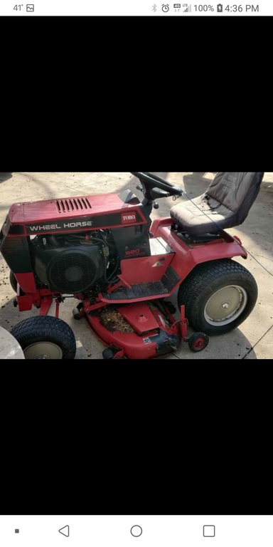

I know it's all about what a buyer and seller agree on, but doesnt this seem like a good deal IF all is in working order? Seller claimed it is.
Its a 96 520 with about 825 hours. Deck looks repaired on left side.  Im looking at it in a couple hours. Seller is asking $800. I know to check for the electrical gremlins 9 pin etc. I'm hoping to use this as plow tractor and not mowing because of heat. I do like my 416H a lot and Onan's don't have the best rep in a WH, but if maintenance is good, they seem to be 1500 hour motors at least.

I could get it for 400 but the deck doesn't lift and it kept blowing a fuse after shutting down.
Gauges dont work either.

If you can knock a few C-notes off the asking price since it's not fully functional, you'll be fine as long as you don't mind tackling the repairs. The fuse issue is probably some stray voltage going where it shouldn't due to a pinched wire and/or bad ground. Non-functioning gauges on a 520 is almost always an issue with the infamous 9-pin connector (or a bad repair to it by a previous owner). A thorough going-through of the wiring can correct a multitude of problems. They do have a bot more wiring than the older, simpler tractors, but there's nothing particularly difficult or over-complicated about them.
Is the hydro drive strong? The standard trick is to hook it to a tree with some chain and see if it will break the rear wheels loose and try to pull anyway. That means the pump is working OK. As long as the pump is good, the lift cylinder can be rebuilt if the problem is in there. (Wheelhorsepartsandmore.com has the seal rebuild kit) Other problems with the lift can be mechanical -- as simple as the lift chain and/or trunnion needing attention. Even the pump can be repaired or a replacement had with the resources here.
If a good inspection of the tractor shows that the faults are really simple repairs, then even full asking price wouldn't be bad -- with TLC that's a machine that will do whatever you want it to.
On 520s, one of the secrets to keeping the heat at bay is to make sure the cooling fins are clear of stuffed-in grass clippings and critter nests. Might require taking the tins off the engine to make sure. There should be a soft gasket that goes around the oil filter and plugs the gap all around it. If it's not there, get a replacement and put it on. It's important for keeping the correct airflow around the back cylinder. I like to leave off the plastic add-on PTO guard so that there's nothing blocking air exiting freely around the engine. There's no safety interlock on it, and it's just a hasty tacked-on piece to satisfy the lawyers in the 90s. Keep the fan intake clear of thick buildup of leaves and clippings -- 520's take a few more stops to sweep that off than the others -- and you really shouldn't have to worry about engine heat. It's not as bad as it's been sometimes made out to be.
More important to the health of the 520 is keeping the gunk and clippings off of the hydro pump fins, and make sure the plastic fan under the right fender is intact. The hydro needs it to stay cool. Also, better to run a 520 at full throttle under load so the engine and hydro fans are doing their jobs, and oil pressure is up all the way.

Some need to be run for a minute to get the hydraulics to work.  Did you check the oil level in the transmission?  Electrical problems are frustrating but usually are cheap to fix, first start undoing the usual homeowner blunders.

@lynnmor, I actually forgot to check the hydro Oil. I had it in mind then started looking at some splices in the wiring. It was warmed up enough to lift it though. It was barely responding. Not making the usual noises. It very well may have been low.
