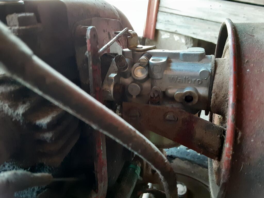

Jason Miller 24 #12 Posted May 8, 2021 I have a Walbro carb. Share this post Link to post Share on other sites

tunahead72 2,662 #16 Posted May 10, 2021 I'm no expert on these things, but if I'm reading the Kohler K181 parts list and carb reference manual correctly, the kit number that Achto just gave you is the correct kit for your carb. It should work, but it's pricey, and includes a lot of parts that you won't use. Walbro has their own kit K1-WHG that MAY work. The only way to know for sure is to look for markings on the carb. You should see WHG somewhere, and a Kohler part number probably on the top or bottom of the mounting flange. If you end up removing the carb again, look for a 2-digit number inside the main bore (engine side), and numbers on the throttle and choke plates. Stens also has a couple of kits that might work. But none of this really addresses why your carb is actually flooding, even with a new needle. You didn't say how it was cleaned (soaked thoroughly, or just sprayed?). My best guess right now is (like Achto mentioned earlier) that there's probably passageways inside the carb that are still clogged and need to be opened up. The seat could also still be dirty, that should come clean with a thorough soaking in carb cleaner, but you can also polish it gently with a Q-tip (either by hand, or inserted into a drill at low speed). 1 Share this post Link to post Share on other sites
Jason Miller 24 #17 Posted May 12, 2021 So this is where I’m at. Went to engine shop took my plug looked fouled and it was wouldn’t spark- from all the gas flooding it. Got new plug. He looked up the Walbro kit $10 but no seat not needle in it?? Also the Kohler one you mentioned $55. He suggested as you did to clean the seat with qtip. I think that’s what I’ll do. did go home and put new plug in fired right up runs great just extremely high idle for some reason I can’t get this carb to adjust well at all. But on plus side it runs. I closed fuel line after running to prevent filling carb with gas until I get this thing fixed. 1 Share this post Link to post Share on other sites
tunahead72 2,662 #18 Posted May 12, 2021 On 5/8/2021 at 4:04 PM, Jason Miller said: You might try adjusting your carb to its initial settings and see if that improves things. In your photo, you'll see three screws facing you. The one in the center, at the top, is the idle speed screw. Try turning that counterclockwise a little, maybe 1/2 a turn at a time, to lower the idle speed. The screw to the left of that one is the idle fuel needle. Turn that fully clockwise until it just lightly bottoms out -- don't force it, or you could damage the tip of the needle. Count the number of turns as you do this, so you know where it was set to begin with. Then turn it back out counterclockwise 2-1/2 turns; that's the recommended initial setting from the carb reference manual. And the screw at the bottom right is the main fuel needle. Turn that clockwise until it bottoms out lightly (count the number of turns here too), then back out counterclockwise 3/4 of a turn. By the way, I wouldn't try to clean the seat with the carb still mounted to the engine. It's difficult to get to, you'll have to remove the bowl and the float, and you could lose or damage the needle in the process. If you can't get this carb to stop flooding, I think the next step would be to remove the carb, give it a good inspection and thorough soak in carb cleaner, and replace the bowl gasket. We can help you through this process if you decide to go that way with it. Share this post Link to post Share on other sites
