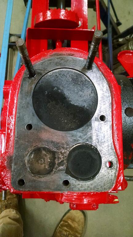

rmaynard 17,432 #1 Posted April 20, 2021 When I bought my 1967 REO Lawn Skiff back in February I was hoping that the engine ran. Previous owner said that it ran last year, but could not get it to start before I picked it up. So I started by rebuilding the carburetor. Then, because the sale included some NOS valves and rings, I decided that I would undertake a refresh. There was a lot of oil in the combustion chamber when I took the head off. So here is why I ask if I am crazy. There are not a lot of parts available for this engine, V60-70066C. This spec number is not even listed in the Tecumseh list of engines. I have cleaned and disassembled the engine, removed all internal components, and found the following: 1. Rings - how do you inspect rings and declare them bad? They looked normal, none broken. 2. Cylinder - glazed, but no scores or scratches. 3. Valves - other than a lot of carbon build-up, they look fine. 4. Crankshaft and connecting rod - journals are not scored. I did not check clearance using Plastigauge. 5. Oil pump and oil passages - pump looks good, all oil ports and passages are open. I ball-honed the cylinder to achieve as nice cross-hatch. The new rings were installed. The valves that were sent with engine were supposedly the right ones, but they were a different style. The old ones used a pin at the bottom if the stem, the new ones had a slotted retainer. The new ones had a .002 smaller diameter stem which allowed a bit more slop in the guides than the old ones, so I am reusing the old valves. They cleaned up nicely. After waiting a month for a set of NOS gaskets to arrive, I'm about to reassemble. Will let you know how it goes and if I am truly crazy after all. 4 Share this post Link to post Share on other sites
WHX?? 57,461 #2 Posted April 20, 2021 14 minutes ago, rmaynard said: Rings - how do you inspect rings and declare them bad? Check ring end gaps on both old and new rings would be my advice. I like to check the old rings to give me an idea of what the wear on things is. Comparing the old ring end gap against the new and comparing to specs is good practice. 2 Share this post Link to post Share on other sites
squonk 47,419 #3 Posted April 20, 2021 Cylinder walls. I've seen lots of them that looked nice but were either out of round, tapered out of spec or both. Of course if that was the case with yours you'd need it bored and an oversize piston that might even not be available. Tecky parts are drying up fast. I would have liked to see how it ran (if it would start) before deciding on a rebuild now but that's me. As the old saying goes you can't spoil a rotten egg. 2 Share this post Link to post Share on other sites
Achto 32,104 #4 Posted April 20, 2021 (edited) 2 hours ago, rmaynard said: 1. Rings - how do you inspect rings and declare them bad? They looked normal, none broken. If the top of the piston was clean, (no carbon on it) or a majority of it was clean. Then you were getting oil past the rings. If the old rings are cast and not chrome moly look at the edge of them. If more than half of the edge of the ring is shiny silver this indicates wear. Chrome moly rings start out life with a silver edge, so they are kind of hard to read in this manner. The top of the piston on a good running engine with good rings should look similar to this when you pull the head. Edited April 20, 2021 by Achto 3 Share this post Link to post Share on other sites

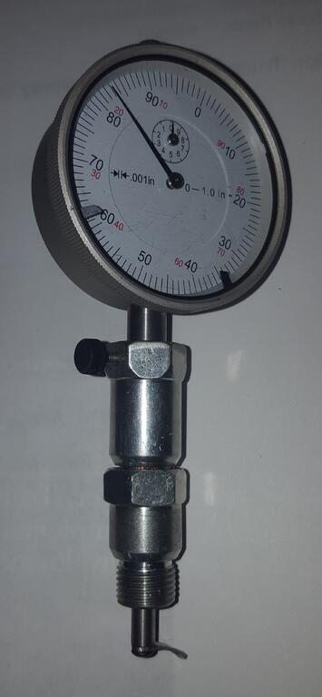

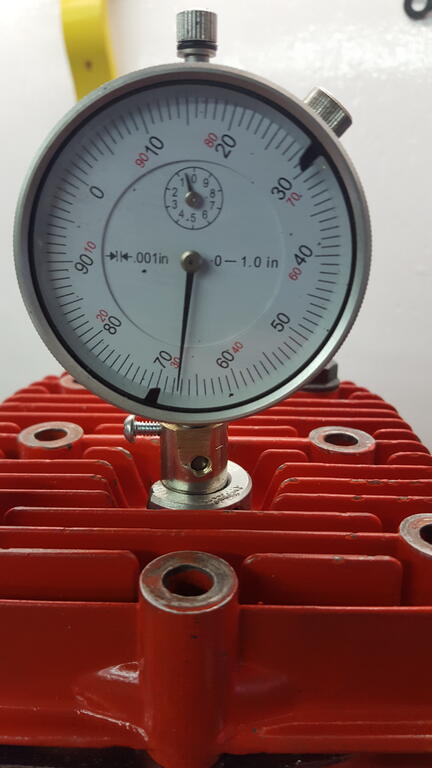

Gregor 4,848 #17 Posted June 7, 2021 (edited) What you need is a handy dandy Tecumseh Timing Tool. No pulling the head, to set the timing. With my motor, I had spark at low RPM, spinning it with a drill. I had no spark when I sped it up. For the record, My H70 is VERY hard to pull start, so I don't. Edited June 7, 2021 by Gregor Share this post Link to post Share on other sites
Handy Don 16,961 #18 Posted June 7, 2021 14 minutes ago, Gregor said: What you need is a handy dandy Tecumseh Timing Tool. No pulling the head, to set the timing. With my motor, I had spark at low RPM, spinning it with a drill. I had no spark when I sped it up. For the record, My H70 is VERY hard to pull start, so I don't. Is that a standard dial indicator with a custom probe? Share this post Link to post Share on other sites
Gregor 4,848 #19 Posted June 7, 2021 1 minute ago, Handy Don said: Is that a standard dial indicator with a custom probe? Standard dial indicator, mounted into a custom made adapter. Screws into the park plug hole, with a small tab, that extends over the piston.I made several of them. Gave a couple away to people to test, sold the rest. I have one left, but it's mine. 1 1 Share this post Link to post Share on other sites

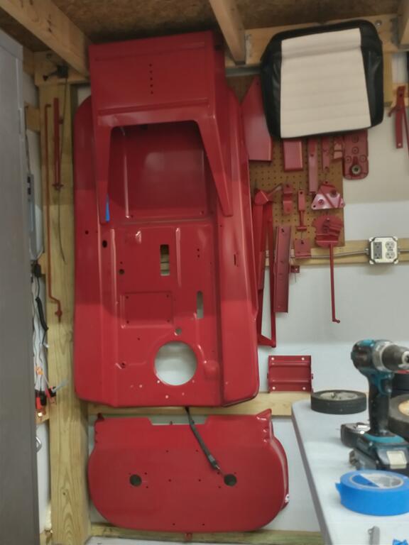

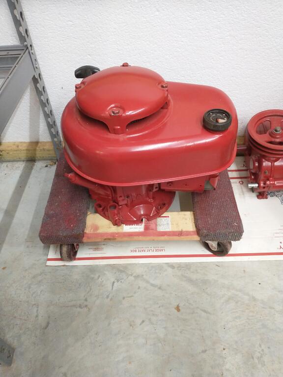

rmaynard 17,432 #23 Posted October 3, 2023 (edited) Well here it is, October 3, 2023, over two years later. My progress? None. Engine hasn't been started since I left it in 2021. I moved at the parts off of the table and on to the wall to make more room for the latest 701. I'm looking at options for heating the pole shed, and if that happens, I'll get back to the restoration and reassembly this winter. Edited October 3, 2023 by rmaynard 1 1 Share this post Link to post Share on other sites

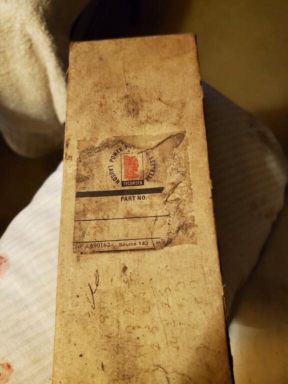

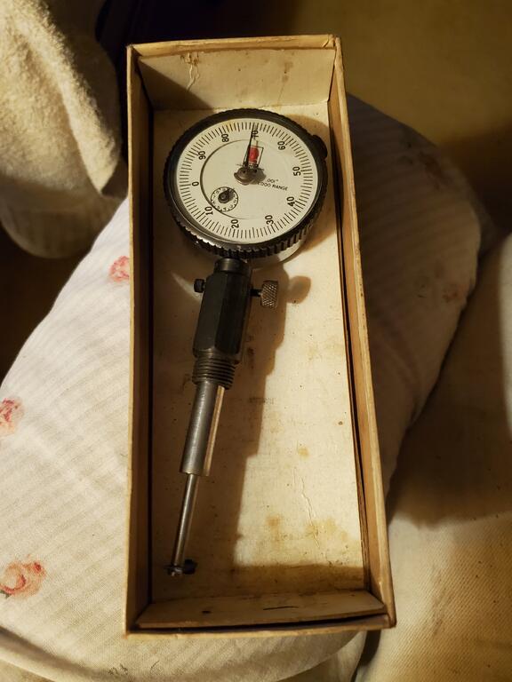

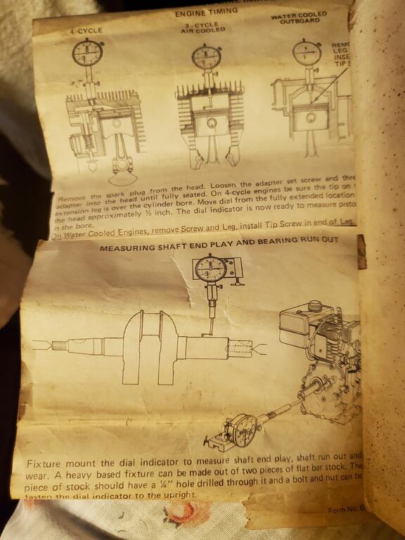

23 Reo 235 #24 Posted October 3, 2023 Nice looking motor. Share this post Link to post Share on other sites
Moparfanforever 933 #25 Posted October 3, 2023 I have had this for more years than I can count. I guess this is one of those fancy schmansy things ?? Share this post Link to post Share on other sites
