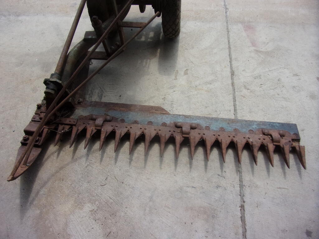

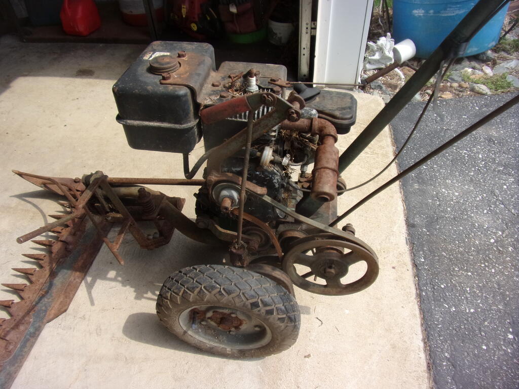

Ed Kennell 47,158 #1 Posted April 18, 2021 I worked on the National sickle mower a bit today. Pulled the tin on the 3HP briggs (only 3 bolts) and cleaned the flywheel and the coil. Put it back together and still no spark. I would like to pull the flywheel to check the key and the points. Am I correct in thinking the aluminum housing that contains the ratchet for the pullstart is also the nut that holds the flywheel on? Does this thing screw off and is it a right hand thread? And yes, I am Briggs ignorant. 2 Share this post Link to post Share on other sites

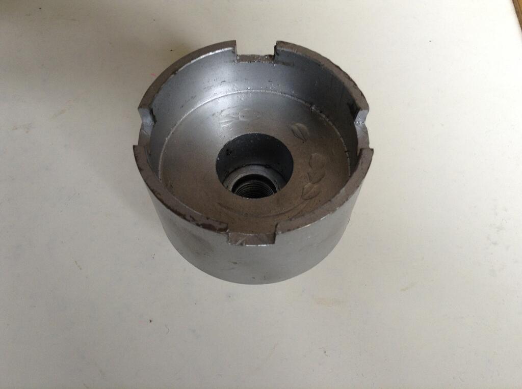

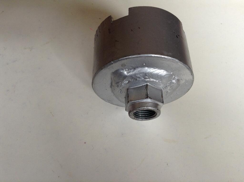

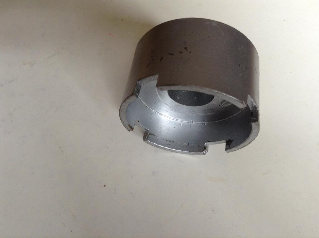

ranger 1,862 #9 Posted April 19, 2021 Beware hitting the ‘threaded ears’ with a hammer, you can easily distort them, and then find the screws that hold the mesh screen won’t then fit. The tools aren’t that expensive to buy, or difficult to make. If you don’t have access to a lathe / mill, find a piece of tube that fits, cut the slots with an angle grinder, or hacksaw / file, drill a cross hole for a tommy bar, and go from there. If no suitable tube available, find something roughly the same size as the centre and weld ‘Fingers’ on to engage the ears. Or find an old socket, cut the slots, you’ll then be able to use a torque wrench to re-tighten. You may not use it often, but it’s there if you need it! Doug. Share this post Link to post Share on other sites
Ed Kennell 47,158 #10 Posted April 19, 2021 31 minutes ago, ranger said: find a piece of tube that fits, cut the slots with an angle grinder No lathe, but I do weld. My plan exactly to cut the slots on the correct size pipe and weld on a nut. Thanks Doug. 2 Share this post Link to post Share on other sites
