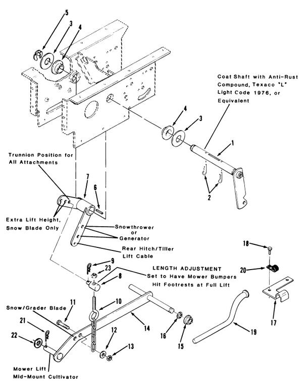

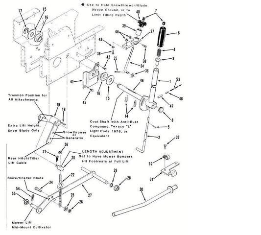

NYJack 9 #5 Posted April 18, 2021 (edited) Ed, you hit it........thank you11 But not out of the woods yet. OK, I went out, started it up and watched. I always think it is the worse thing it could be....... the ram is working, but deck not moving. I looked more into it and there is a chain hooked to the lift bar with an eye bolt on the other end with an adjustable fitting that was just laying there. It obviously needs to somehow hook up to the lever I can barely see moving when the ram moves. I can see where a nub on the fitting may go into a hole in the lever, but it seems that it would just fall back out, no hole that I could see for a pin in the fitting. On my old 120-8 with manual lift, there was a long stud on the lift lever that engaged a slot on the mower deck attachment, no chain. Edited April 18, 2021 by NYJack Share this post Link to post Share on other sites

Ed Kennell 46,985 #7 Posted April 18, 2021 (edited) Oops, Garry has the correct one. There should be a hole for the hairpin clip. Note it goes in the rear hole in the lift lever. Edited April 18, 2021 by Ed Kennell 1 Share this post Link to post Share on other sites
NYJack 9 #8 Posted April 18, 2021 THANK YOU GUYS! THIS IS A GREAT PLACE! I must have missed seeing the hole for the pin- under the tractor and trifocals can be difficult. 3 1 Share this post Link to post Share on other sites
