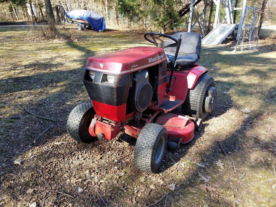

johnnymag3 2,646 #1 Posted April 18, 2021 (edited) Looking for some ideas here. Battery will drain down when parked. 889 hours, 16 HP Kohler 416-8 Wheel Horse. I never had this problem before and trying to find out what the deal is with this newly aquired Tractor.......... Edited April 18, 2021 by johnnymag3 Share this post Link to post Share on other sites
