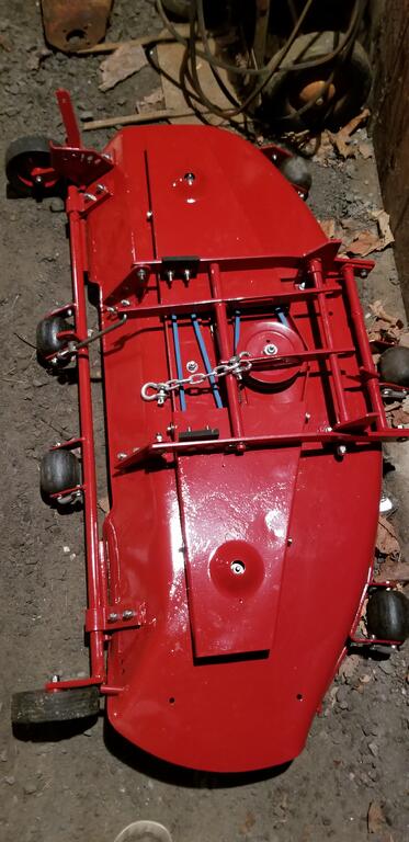

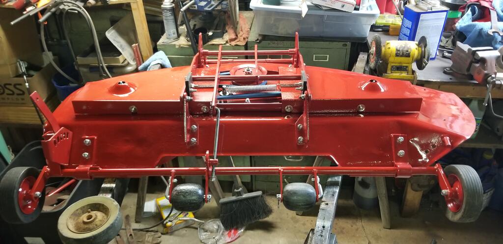

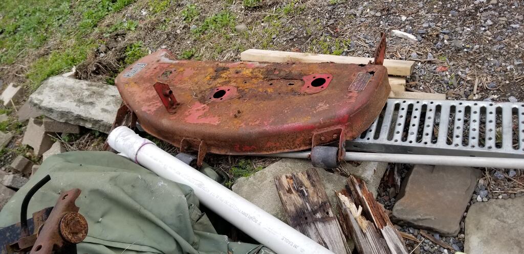

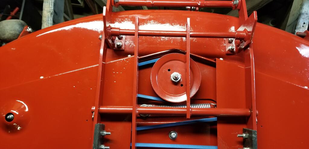

gt14rider 1,278 #1 Posted April 18, 2021 Hey all, I was given a couple of 48" decks, was told there junk, I could use for parts. Started stripping them down and the next thing you know this is what I got. Didn't get many before pics. 1 12 1 Share this post Link to post Share on other sites
Darb1964 1,174 #2 Posted April 18, 2021 That's how you do it, nice job. There is more from where that came from!! 1 Share this post Link to post Share on other sites
gt14rider 1,278 #3 Posted April 18, 2021 The wife says OH BOY! Share this post Link to post Share on other sites
Darb1964 1,174 #4 Posted April 18, 2021 My ears aren't ringing, the C-141 is now in my yard just in case I forget to mention it. Put a battery in and it did wake up a little, didn't push it because I hadn't cleaned it up. C-160 Auto been getting the bugs out. Just for general information,but selected ears. Share this post Link to post Share on other sites
oliver2-44 11,694 #5 Posted April 18, 2021 That deck sure looks like junk to me. I can't believe you put me red paint on it. Looks like you might have even wasted some welding rods on it. You better send it to me before the neighbors see it! Share this post Link to post Share on other sites
gt14rider 1,278 #6 Posted April 18, 2021 Think I'll just scrape it. Share this post Link to post Share on other sites
seuadr 490 #7 Posted April 18, 2021 I can't believe you tricked me into looking at your junk! FOR SHAME SIR! 1 Share this post Link to post Share on other sites

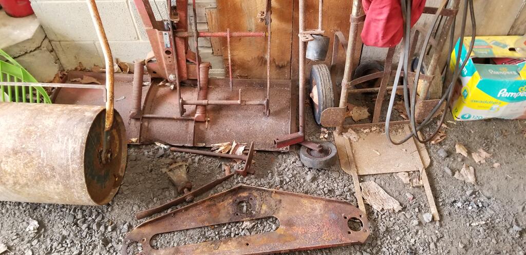

Jeff-C175 7,211 #8 Posted April 19, 2021 (edited) TWINS! I'm pretty much finished with mine too! Need second coat of paint on the covers, but other than that, ready to mow. Oh... and I've got new labels coming from Terry soon. Mine didn't look NEARLY as bad as yours though! The top of the deck sheet metal was 'bowed down' between the pulleys and I wasn't successful in attempts to straighten it so I opted for four more carriage bolts to pull it up. The idler bar was riding low and the idler pulley very close to the reinforcing sub-chassis. Those four bolts pulled everything "up tight and outta sight". Edited April 19, 2021 by Jeff-C175 Share this post Link to post Share on other sites
gt14rider 1,278 #9 Posted April 19, 2021 Mine had a twist in it , was able to persuade it to play nice. BMFH and a torch, made a jig to hold and help twist back. if you look close at all the dents, looks like PO was mowing rocks. Share this post Link to post Share on other sites
