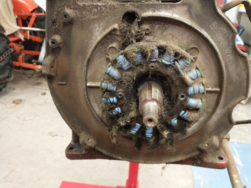

squonk 47,422 #15 Posted April 16, 2021 Here's one that nobody thinks about. Pull the flywheel and clean off the stator! 1 1 Share this post Link to post Share on other sites
