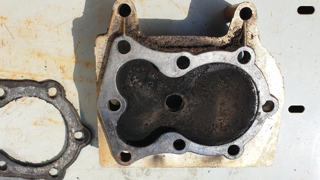

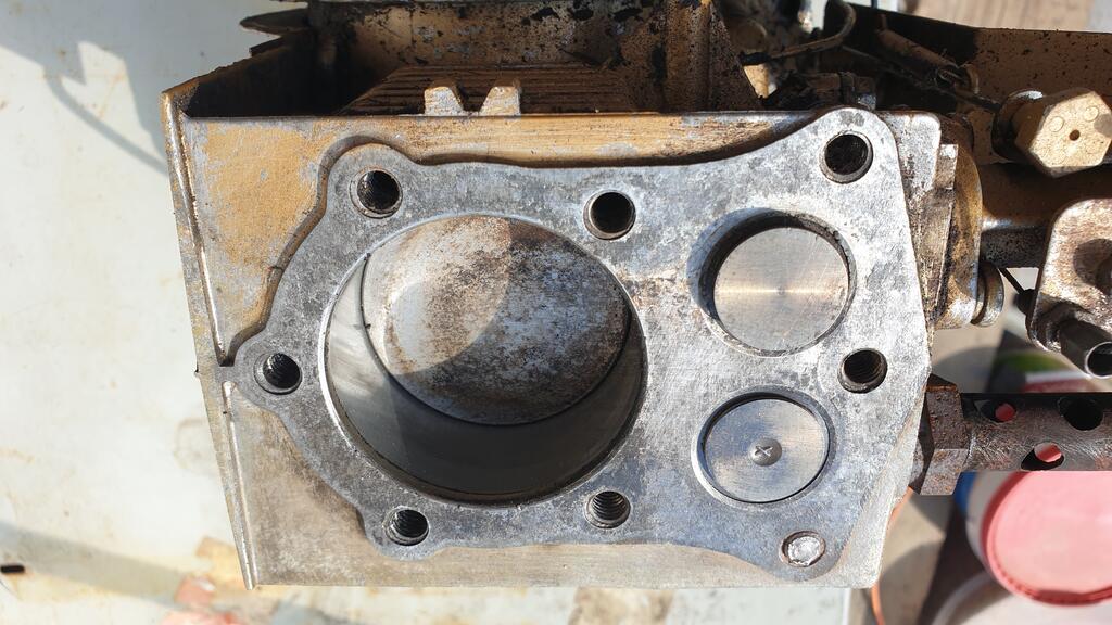

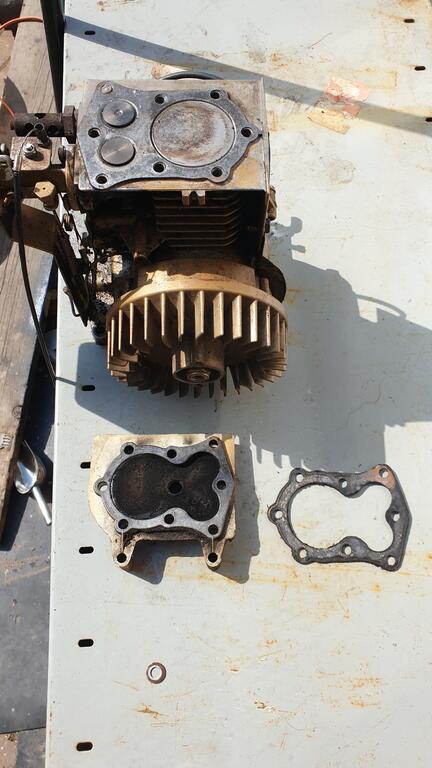

Mickwhitt 5,259 #9 Posted April 17, 2021 This is the removal of a lawn mower cylinder head which should have been straight forward. Here you see the engine block, cylinder head and gasket laid out. The combustion chamber with its coating of carbon which needs to be carefully removed. Its only aluminium so nothing too aggressive. Here is the face of the cylinder block. I cleaned this before taking the photo. Valves look OK. But you can see the cylinder head bolt close to the exhaust port has snapped in the block. That's because this bolt is subject to the most heat and so is prone to seize in place. Removing it will be a pain as it will need drilling and tapping out. The cylinder walls don't look worn or scored, but if you want to check the piston rings we are into a much more involved process. As we said before the gasket is history after one use so get a new one. A simple job on the face of it but taking the head off can be like opening a can of worms. 1 Share this post Link to post Share on other sites

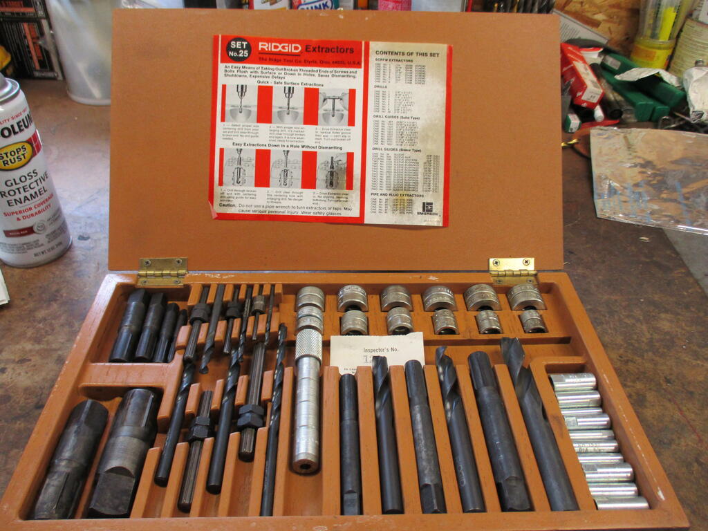

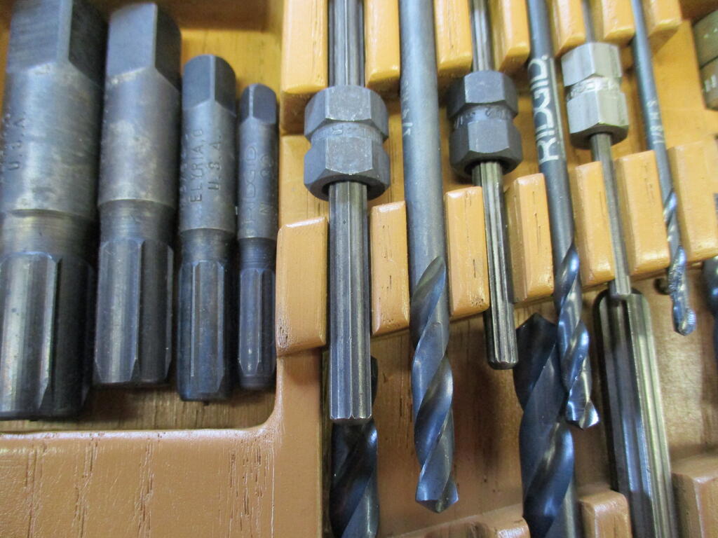

pfrederi 21,185 #13 Posted April 17, 2021 15 minutes ago, ranger said: I’ve also never had much luck with “Easyouts”, by the very fact they are tapered means they will tend to ‘expand’ the part you are trying to extract, thus tightening it in the hole! I do have a set of extractors which resemble “Torx” bits. You first drill a hole, then hammer the appropriate size extractor into the hole and unscrew. I have had mixed results with these. I suspect any of these types of extractor are really only meant to be used on fasteners which have failed in service, for whatever reason, and not for fasteners snapped during removal due to rust, etc,? I have seen people using “Torx” bits as extractors, with considerable success, again, only on fasteners which had failed in service! On occasions I have had to completely drill out a broken stud, I have fabricated a drilling jig, picking up from adjacent holes where possible. This I have found to be the only reliable way to ensure minimal damage to original threads present. It also helps greatly if you have access to ‘Left Hand’ drill bits! It takes relatively little time to ‘Cobble’ together a rudimentary drilling jig from scrap compared to the time you could spend trying to repair the damage caused if the drill bit ‘Wanders’, especially if you’re using a hand drill. Doug. This Rigid set uses the "Torx" looking extractor. They have worked for me sometimes but not all.... 1 Share this post Link to post Share on other sites
