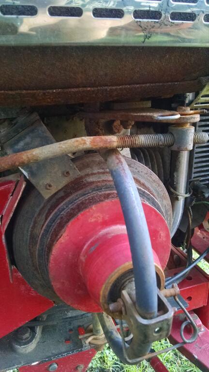

Achto 32,095 #3 Posted April 14, 2021 1 hour ago, big red mower said: Now my problem is does the triangular piece go on top or the bottom of that bracket that bolts to the engine? If it goes on top i don't have room or i have the wrong bracket. Here is a pic of the set up on my 520, kinda hard to get a good picture with the muffler in the way. Triangle piece is on the top on mine. Hope this helps. Share this post Link to post Share on other sites

big red mower 5 #6 Posted April 14, 2021 Achto The bracket that i got sets alot closer to the muffler than the one in the photo,Would it cause any problems mounted in the lower position?, It seems to work Thanks for the welcome guys. Big red mower 2 Share this post Link to post Share on other sites
seuadr 490 #7 Posted April 15, 2021 9 minutes ago, big red mower said: Achto The bracket that i got sets alot closer to the muffler than the one in the photo,Would it cause any problems mounted in the lower position?, It seems to work Thanks for the welcome guys. Big red mower Can you share a picture? 2 Share this post Link to post Share on other sites

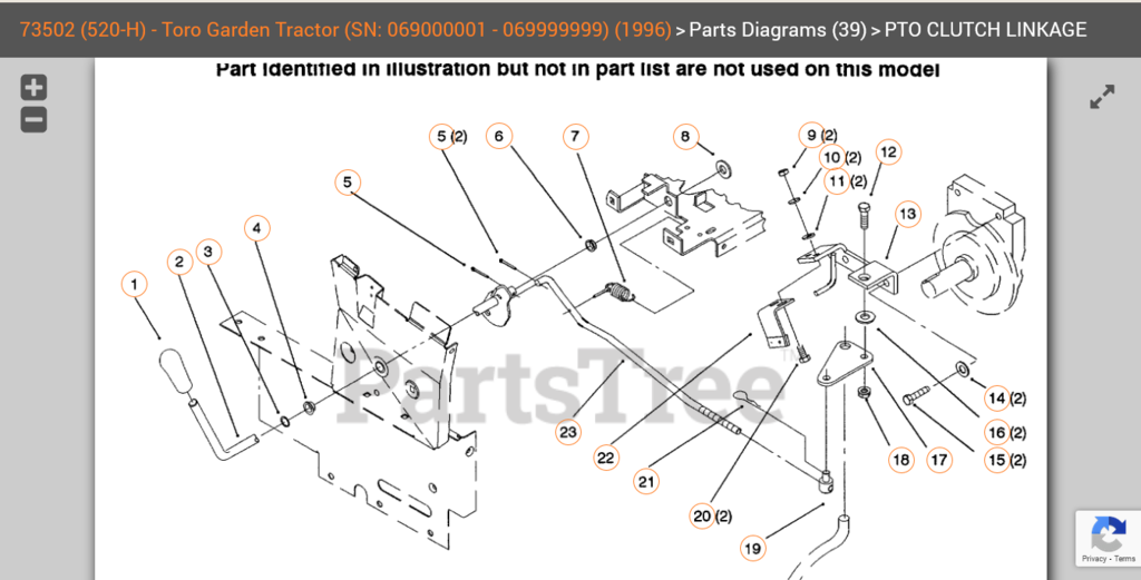

Horse Newbie 7,405 #8 Posted April 15, 2021 59 minutes ago, Achto said: Triangle piece is on the top on mine. Hope this helps. @big red mower I'll jump in here and add my 2 cents worth...on the exploded view of the parts diagram it appears to me that the triangle shaped piece goes on the bottom of the bracket that bolts on the engine... @Achto may have thought that you were asking if the triangle shaped piece went on the top or bottom of the PTO hoop... 2 Share this post Link to post Share on other sites
Lee1977 7,709 #9 Posted April 15, 2021 My bracket is mounted on the bottom side of the bracket. It's a 1989 520-H. 2 1 Share this post Link to post Share on other sites
big red mower 5 #10 Posted April 15, 2021 Mine is mounted like the pictures 1 Share this post Link to post Share on other sites
