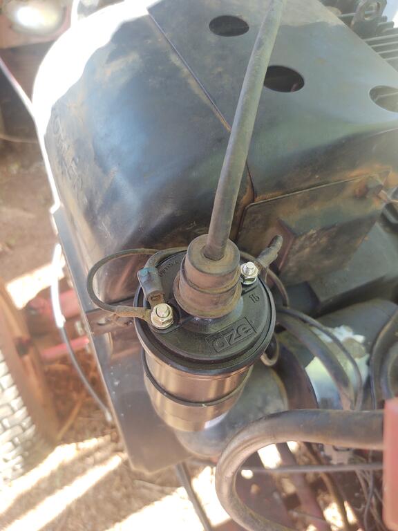

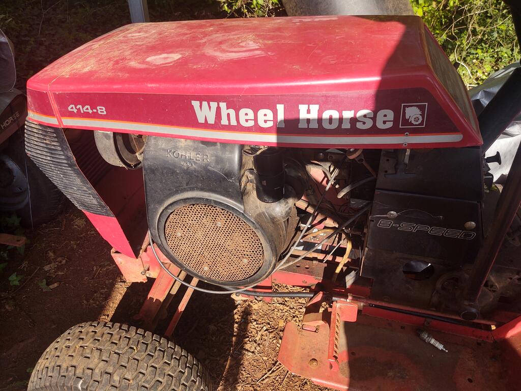

TC10284 113 #1 Posted April 12, 2021 I have a 414-8 with K321. I get no spark out of it. I have put on a new ignition coil but no luck. I also checked the points and they looked ok as far as I could tell. I used a nail file to clean them just in case. I put in a new spark plug. I'm testing spark with an inline spark tester, as well as looking for spark on the plug. It turns over fine, just cannot get any spark. Share this post Link to post Share on other sites

gwest_ca-(File Mod) 11,741 #4 Posted April 12, 2021 Have a test light or voltmeter? The (+) coil terminal needs constant battery voltage in START and RUN The (-) coil terminal will have battery voltage when the ignition points are open. When the points are closed there should be 0 volts. So as the engine cranks the voltage will be on and off once for every 2 rotations of the crankshaft. If that is not happening the points are not opening, not closing or are not making electrical contact when they are closed. Clean the points again. The condenser should be connected to the coil (-) terminal. Let us know what you find. Garry 3 Share this post Link to post Share on other sites

squonk 44,625 #7 Posted April 13, 2021 PTO and seat switch can knock out spark. First thing to do is check for 12volts at the coil positive. If you have it then at the coil negative you Must have 12 volts on and off as the engine is spinning. 1 Share this post Link to post Share on other sites

squonk 44,625 #10 Posted April 13, 2021 This probably won't make sense but: If you have a voltmeter. With key on you should have 12 volts at the coil " +" If you do Then move to the coil "- " Take out the spark plug. Turn the engine clockwise flywheel side by hand. You should have 0 volts at the meter most of the time while you are turning the engine. ( Point's closed ) Keep turning the engine. When the points open you will get 12volts on your meter. Keep turning the engine. The meter should go back to 0 volts when the points close again. If the meter never reads 12 volts the points aren't opening or are so dirty the electricity is traveling thru the gunk. If the meter reads 12volts all the time, the points aren't closing or are corroded enough electricity can't get to ground thru the points or the points bracket itself isn't grounded. Same thing with a 12volt test light. The light should be off most of the time the motor is turning. And light up briefly when the points open. 3 Share this post Link to post Share on other sites
TC10284 113 #11 Posted April 13, 2021 2 hours ago, squonk said: This probably won't make sense but: If you have a voltmeter. With key on you should have 12 volts at the coil " +" If you do Then move to the coil "- " Take out the spark plug. Turn the engine clockwise flywheel side by hand. You should have 0 volts at the meter most of the time while you are turning the engine. ( Point's closed ) Keep turning the engine. When the points open you will get 12volts on your meter. Keep turning the engine. The meter should go back to 0 volts when the points close again. If the meter never reads 12 volts the points aren't opening or are so dirty the electricity is traveling thru the gunk. If the meter reads 12volts all the time, the points aren't closing or are corroded enough electricity can't get to ground thru the points or the points bracket itself isn't grounded. Same thing with a 12volt test light. The light should be off most of the time the motor is turning. And light up briefly when the points open. It makes great sense and I'll give that a try asap. Thanks! Share this post Link to post Share on other sites
TC10284 113 #12 Posted April 14, 2021 6 hours ago, squonk said: This probably won't make sense but: If you have a voltmeter. With key on you should have 12 volts at the coil " +" If you do Then move to the coil "- " Take out the spark plug. Turn the engine clockwise flywheel side by hand. You should have 0 volts at the meter most of the time while you are turning the engine. ( Point's closed ) Keep turning the engine. When the points open you will get 12volts on your meter. Keep turning the engine. The meter should go back to 0 volts when the points close again. If the meter never reads 12 volts the points aren't opening or are so dirty the electricity is traveling thru the gunk. If the meter reads 12volts all the time, the points aren't closing or are corroded enough electricity can't get to ground thru the points or the points bracket itself isn't grounded. Same thing with a 12volt test light. The light should be off most of the time the motor is turning. And light up briefly when the points open. OK so here's what I did. I hope I did this correctly. Turned key switch to Run. Connected positive of coil to positive of multimeter. Connected negative of multimeter to engine block. Got 13v. Moved multimeter positive from positive of coil to negative of coil. Got 13v. Took out spark plug. Turned flywheel over clockwise by hand. The voltage never dropped. I could get it to drop to around 12.5v the faster I spun it by hand. I tried cleaning the point contacts again with the nail file but no change. Pics: https://pic8.co/a/7d2c86ea-5b4c-47ba-af72-1b10792792fe Share this post Link to post Share on other sites
squonk 44,625 #13 Posted April 14, 2021 Points are very dirty and look burnt. I also see what looks to be dead grass inside the pivot. Replace the points and condenser and retry. Set the points gap at .020 when the pushrod is at the longest point. As you rotate the engine, you will see the did extend. You may have to hold it into the engine to feel it. 1 Share this post Link to post Share on other sites
