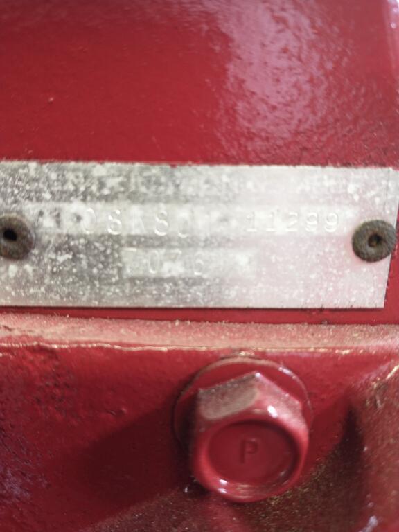

Hylton 1 #15 Posted April 11, 2021 Tough one. OSKSO 11299 7076 Share this post Link to post Share on other sites

gwest_ca-(File Mod) 11,853 #19 Posted April 11, 2021 Engine made by Kohler in 1973 for Gravely https://www.partstree.com/models/k301-47482-kohler-k-series-engine-made-for-gravely-12hp-9kw/ **- OSKSO* 1977 tractor model number 71-08K801 Click on the picture in each link Garry 1 Share this post Link to post Share on other sites
