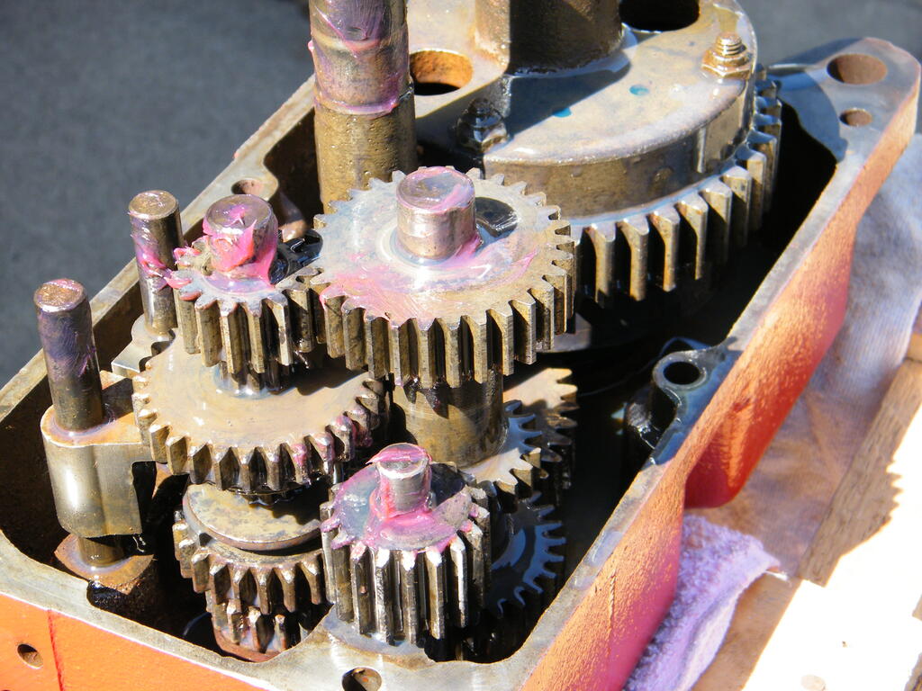

TractorChild97 158 #1 Posted April 11, 2021 I have split open an 8 speed out of an old tractor I got recently. I split it open and checked the needles bearings and cleaned up the gears. I absolutely cannot get this trans put back together. Iv split other 8 speeds in the past and never had this hard of a time. Any advice would be super appreciated! Share this post Link to post Share on other sites

stevasaurus 23,620 #8 Posted April 11, 2021 Things to look for... 1. Are the reduction and pinion gears even on the cluster gear and input shaft?? 2. Did you add any shims to the input shaft or under the 11/44 toothed gear?? 3. Is there any debris around or in the holes or studs that align the case halves?? 4. The nuts on the differential should be facing up, except for the 10 pinion LS differentials. (which face down) 5. Check to see if all of your inside bearings are flush with the inside of the case half. 6. Sometimes, using the 4 corner bolts to evenly and delicately force the case halves to close. (last resort) 7. Is it 1/8" all the way around?? Reduction and pinion gears are even. 3 1 Share this post Link to post Share on other sites

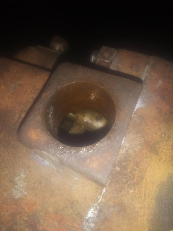

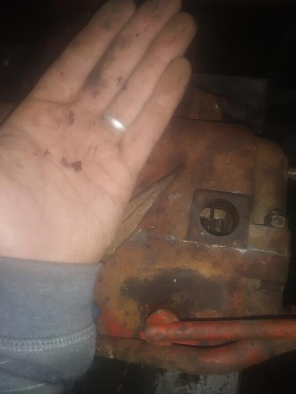

TractorChild97 158 #13 Posted April 13, 2021 This set screw broke off. Looks like a drill rethreading coming soon. Share this post Link to post Share on other sites
stevasaurus 23,620 #14 Posted April 13, 2021 If you can grab that with something, it may turn right out...they are not usually that tight in there. If that is a regular dog point set screw, it is hardened steel. It doesn't drill easily. 1 Share this post Link to post Share on other sites
TractorChild97 158 #15 Posted April 14, 2021 Got it!! 1 Share this post Link to post Share on other sites
TractorChild97 158 #16 Posted April 14, 2021 @stevasaurus Needle nose pliers got it right out 1 Share this post Link to post Share on other sites
