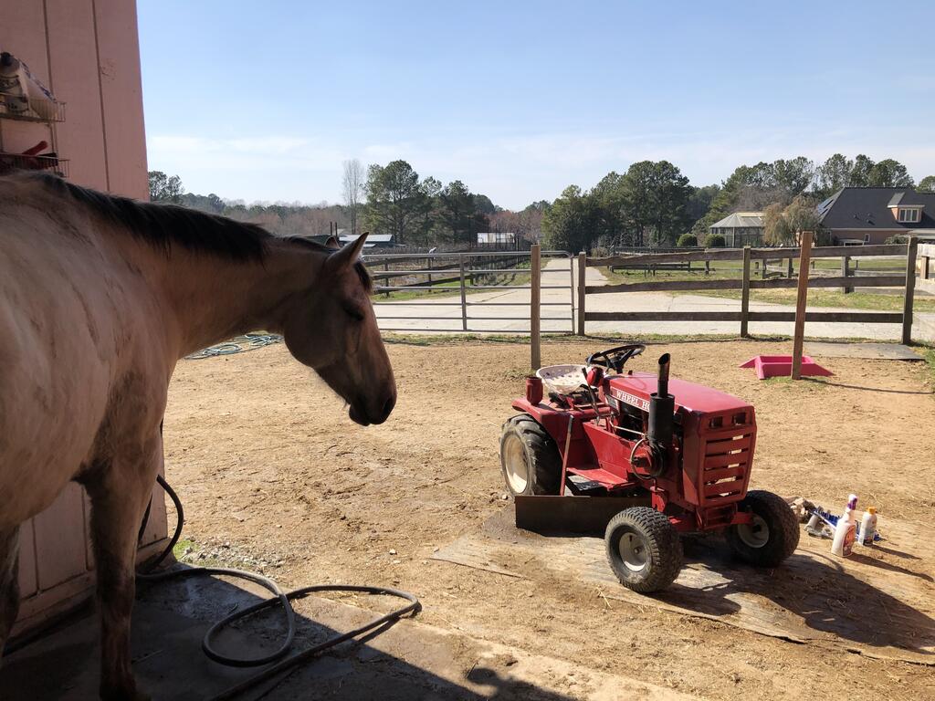

krystolo 504 #1 Posted April 10, 2021 The way my stack is set up now, it’s right at face level. So, when I’m driving my tractor in the sunshine, I get an unpleasant “wind” of exhaust fumes. Is there a way to raise the stack or reroute it so it doesn’t blow in my face? 1 Share this post Link to post Share on other sites
wallfish 20,637 #2 Posted April 10, 2021 Turn it 180* so the pipe is down. The horse checking out the horse, good pic! 5 Share this post Link to post Share on other sites

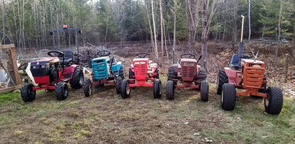

ebinmaine 80,766 #3 Posted April 10, 2021 11 minutes ago, wallfish said: horse checking out the horse, good pic Calendar shot! The trucker and 5 year old in me says taaall stack and shiny. Cinnamon horse C160 has a piece of chrome bathroom pipe I cut to add on. 5 Share this post Link to post Share on other sites
The Tuul Crib 7,354 #4 Posted April 10, 2021 Palomino? Share this post Link to post Share on other sites
ranger 1,862 #5 Posted April 10, 2021 Just find a nice piece of stainless tube slightly larger and longer than whats on there, slip it over existing pipe and clamp it. Stainless exhaust pipe is quite thin so doesn’t weigh too much and is usually not too expensive. Doug. 3 Share this post Link to post Share on other sites

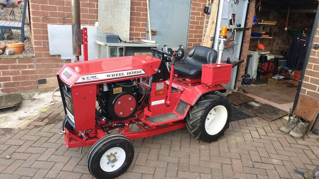

Mickwhitt 5,259 #6 Posted April 10, 2021 Yes, lengthen the top tube and I put a 45 degree elbow on mine to direct the exhaust to one side and keep rain out. I did route it down as mentioned above but didn't like it, soot on the chassis etc. And it messed with the plow frame too. I made the stack from scratch from parts I bought from an on line exhaust supplier, really easy to do if you can braze or silver solder. Give it a go, they look really cool. 1 1 Share this post Link to post Share on other sites

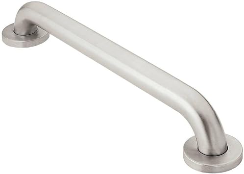

953 nut 69,556 #7 Posted April 10, 2021 A Grab Bar with the correct inside diameter could be added with one bend cut off and the flange removed from the end. Home Depot or Lowe's have them around $ 20.00, just watch out for low hanging branches. 1 Share this post Link to post Share on other sites

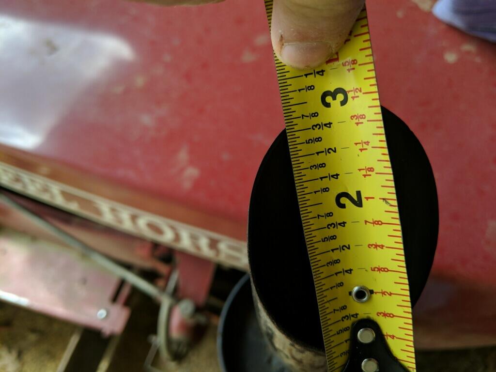

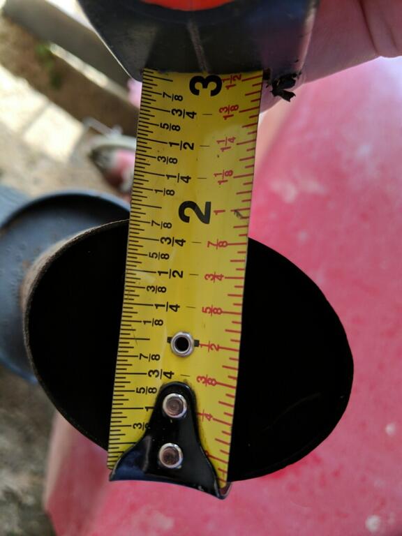

krystolo 504 #20 Posted April 19, 2021 The existing exhaust pipe is an oval! Advice on extending it? Share this post Link to post Share on other sites
ebinmaine 80,766 #21 Posted April 19, 2021 You should be able to make it much closer to round if you use judicious caution and some large water pump pliers or a c-clamp or something... There are also tools that are sold for expanding exhaust. Share this post Link to post Share on other sites
ranger 1,862 #22 Posted April 19, 2021 Is the whole length of pipe oval? If just the end section, you can buy as suggested, tools to expand exhaust pipes, or determine the diameter if the pipe was round. Grab a piece of timber, preferably hardwood, whittle one end to a longish taper and hammer it into the oval, (after removing the exhaust so you don’t damage anything on the engine). If the pipe is oval all the way along, then again determine the o/d ( measure the circumference calculate diameter, buy some pipe with I/d to suit, and gently dress new pipe with a mallet to the same form as existing exhaust). You won’t be able to clamp it, but if it’s long enough it shouldn’t come off on it’s own. Lots of older tractors had the exhaust exiting through a hole in the bonnet/hood with the silencer just sitting over the manifold outlet. (only way to open the hood). Doug. Share this post Link to post Share on other sites
ranger 1,862 #23 Posted April 19, 2021 Is the pipe actually oval, or is it because the end is cut at an angle? Doug. 1 Share this post Link to post Share on other sites
OldWorkHorse 3,156 #24 Posted April 19, 2021 Cut it down about half inch so it's a full circle then go to napa and buy 1.5" exhaust tubing and cut it to how ever high you want slide it over clamp or weld it on. What I do. 2 Share this post Link to post Share on other sites

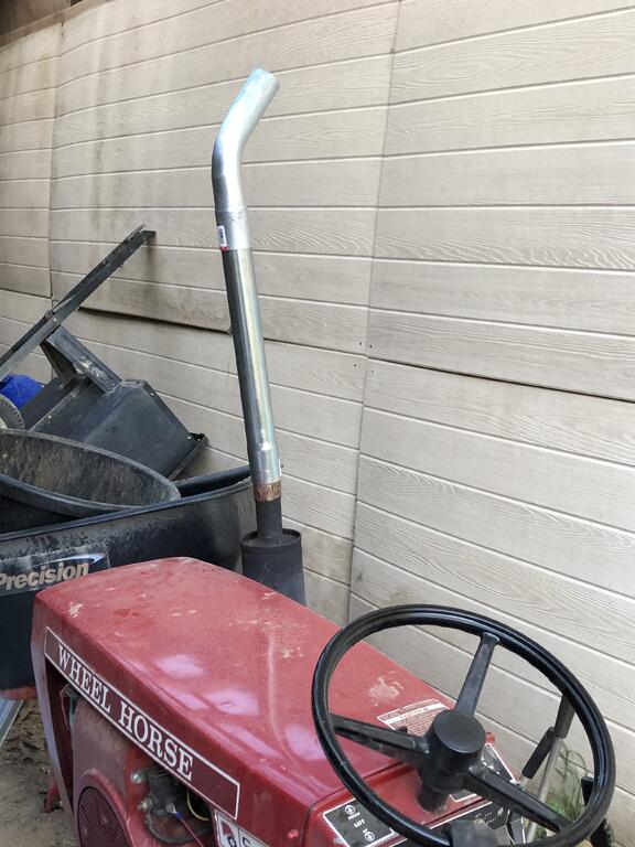

krystolo 504 #25 Posted April 23, 2021 Well, geez, that was easy. 🤦♀️ Walked in to Auto Zone in my high heels and business suit, asked the clerk for exhaust pipe for my tractor (got a weird look, but what evs) and bought a nice long section and a curvy bit for the top. Later, changed into my real clothes, took a trip to the farm, and got it all fitted up! I guess I need to clamp it? 3 1 Share this post Link to post Share on other sites
