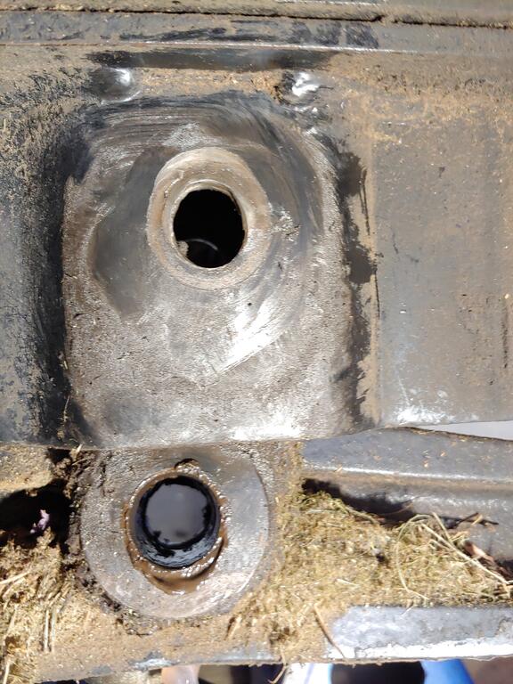

I have a damaged axle pivot. It seems like it could have been designed better. How should i go about fixing the wallowed out pivot hole in the frame?
I thought about welding or bushing, but i dont know how to redrill it out in the right spot?

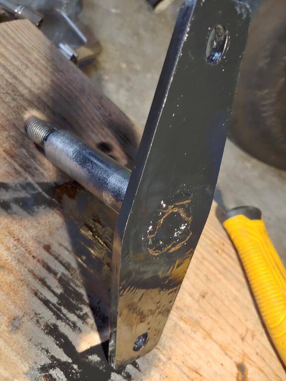

So i ventured out of my comfort zone today and got this fixed up.
@gwest_ca@gwest_ca i think it is  standard but it is large and it had a big 1/8" plate welded to it to stop rotation, but it also broke out of that.

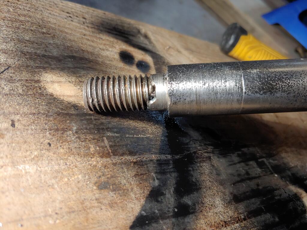

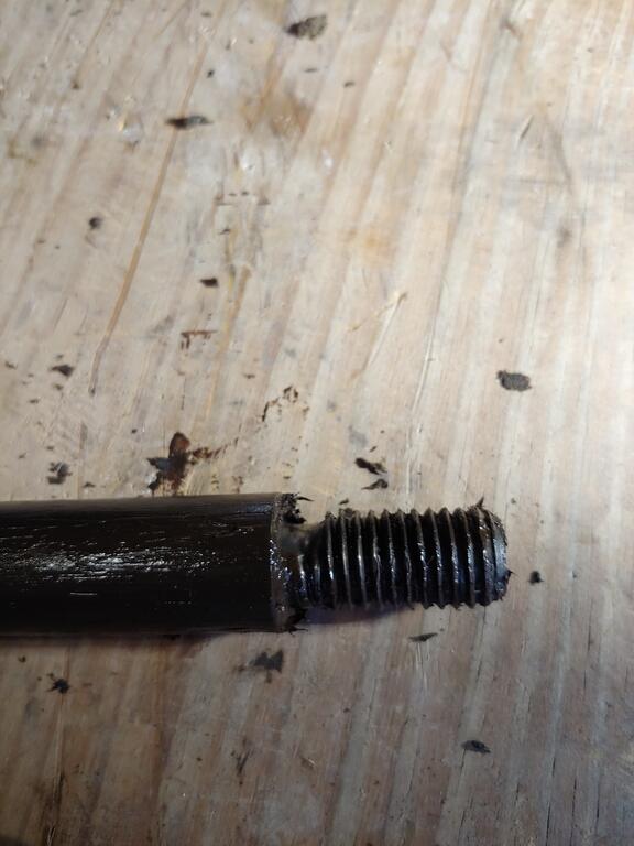

First I welded the shallow spots on the pin, chucked them up in my lathe and turned it down. (yes this is not a pretty fix, its a functional fix)

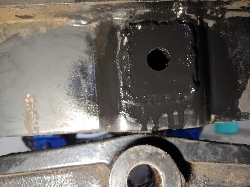

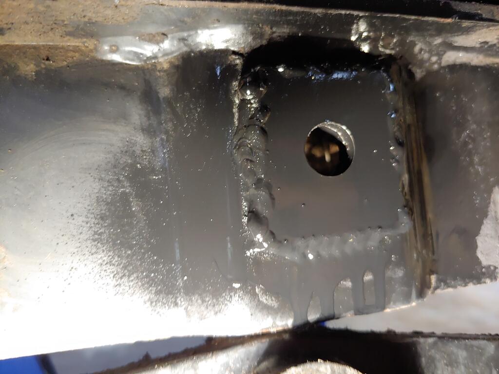

Then i welded up the oblong hole (no progress pics of this) and reamed it out with a carbide burr.
I drilled a good hole in another plate and welded it on to help spread the load out over more area. Looking back i should have welded up all the threads to this point on the pin.
The paint job is terrible but it will be functional.
20210410_180825_HDR.jpg.054198d5b336c005eedc8bc3e33d9a4a.jpg20210410_180807_HDR.jpg.d4d8565c32adc5d84951db021e0f247c.jpg
Welded the plate back on the pin and welded up a crack that formed.
All that is left is assembling it back.
