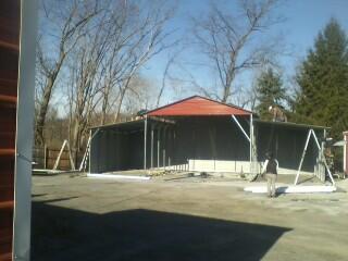

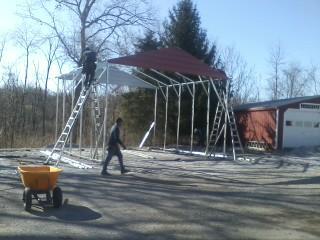

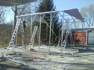

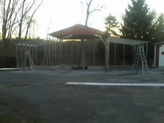

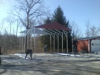

Pollack Pete 2,273 #1 Posted April 9, 2021 Finally,after being on order since this past early November,my new equipment building has arrived.I did all the site prep late last November before the ground froze and snow started falling.Crusher run floor.44 feet long.20 feet deep.Main part is 12 feet high.Leanto's are 10 feet high sloping down to 9 feet.Took a 4 man crew a total of 8 hours to erect.They got here at 2 PM yesterday and left at 7.Got here at 7 AM this morning and were done a little before 10 AM. Last pic is of the building finished except for the trim.Those guys were working fools.Gonna leave the front open,at least for now.Plan to put my backhoe,bulldozer,mini excavator,of course a few Wheel Horses,park my Daily driver Jeep Wrangler in it too.Will start to fill it up over the week end. 11 10 1 2 Share this post Link to post Share on other sites
roadapples 6,987 #3 Posted April 9, 2021 nice. How are the posts anchored.. Share this post Link to post Share on other sites
Pollack Pete 2,273 #4 Posted April 9, 2021 39 minutes ago, roadapples said: How are the posts anchored.. Bottom rails are drilled.They pounded in 4 foot long rebar with flat washers welded on top.Also several screw in type anchors that were screwed into the ground with a big honkin' 2 man electric drill , then bolted to the bottom building rails. I wouldn't want to run that drill all day. 1 1 Share this post Link to post Share on other sites
