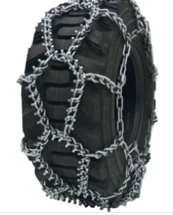

seuadr 490 #7 Posted April 9, 2021 (edited) 58 minutes ago, Ed Kennell said: to the If you plan to use the tractor mainly for snow blowing with chains, I would never buy ag tires. The turf tire will keep more of the chains in contact with the ground than the ag tire resulting in much better traction. depends on the chain pattern i guess. i've got "euro style" diamond chains looks a lot like these: and they sit pretty solid with the ground. with one headlight shroud it looks like your tractor is about to wink, @Ifixoldjunk Edited April 9, 2021 by seuadr 1 2 Share this post Link to post Share on other sites

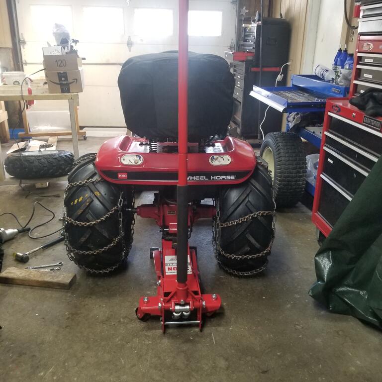

OldWorkHorse 3,156 #14 Posted April 11, 2021 (edited) I run AGs on my 314-8, 23x10.5-12 with chains they fit fine other then once in a blue moon a chain would just barly rub on the braket the fuel tank sits in so I ended up putting 2 inch spacers on her to stop the rub. Left tire in photo spaced right tire stock. Edited April 11, 2021 by OldWorkHorse Share this post Link to post Share on other sites
Ifixoldjunk 778 #15 Posted April 11, 2021 5 hours ago, OldWorkHorse said: I run AGs on my 324-8, 23x10.5-12 with chains they fit fine other then once in a blue moon a chain would just barly rub on the braket the fuel tank sits in so I ended up putting 2 inch spacers on her to stop the rub. Left tire in photo spaced right tire stock. Oh cool. So I’d definitely be able to clear at least 23x8.50-12s. Thanks a lot On 4/9/2021 at 9:41 AM, Ifixoldjunk said: Hi y’all! I’ve been in the process of fixing up a wheel horse 310-8. The original tires are pretty dry rotted and I’ve been thinking about running AG tires. My only issue is the original rear tires were 22x7.50-12 while I can only find 23x8.50-12s. Do you think I could get away with the larger tires and chains? I mostly use the tractor for the snowblower so chains are a must. I don’t want to put the new tires on and not have room for my chains. Thanks for any help✌️ I want to thank everyone for there input. I think I’ve finally decided on what tires I’ll get. I’ll probably post something about it once I get them. Thanks y’all 1 Share this post Link to post Share on other sites
