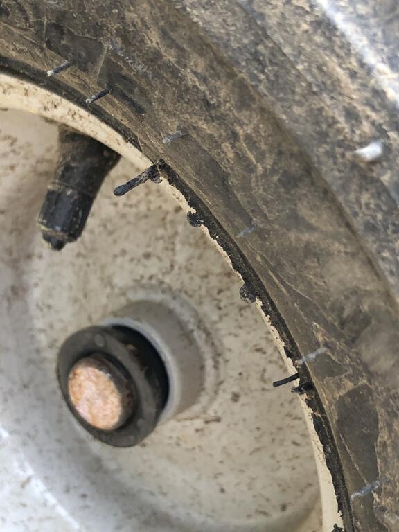

krystolo 504 #26 Posted April 9, 2021 @pullstart you are awesome! Thank you! I’ll have to go out tomorrow and pull apart the front end to see what I need. 1 Share this post Link to post Share on other sites

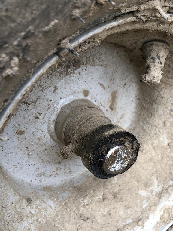

WHX?? 57,392 #27 Posted April 9, 2021 Betcha the nut was used as some kinda goofy spacer. Yes you are going to need one of these Krys... 1 year RedSquare support - RedSquare Support - RedSquare Wheel Horse Forum Pull the spindle off the axle, clean it up and get us a pic of that. Measure the length of the spindle that the rim sets on fron the welded washer out. . I 've got parts too if Kev doesn't Clean around this grease fitting and we'll have you grease it when she goes back together. 4 Share this post Link to post Share on other sites

Pullstart 70,702 #30 Posted April 9, 2021 @krystolo your name looks great in Red! Congrats on becoming a supporting member! are those 6” wheels? I can send you my 8’s but the tires are junk.. 4 Share this post Link to post Share on other sites
krystolo 504 #31 Posted April 9, 2021 56 minutes ago, WHX24 said: Definitely the wrong rim... healthy horse lookin after a sick one?!?!? Or did you put a carrot on the floor board?!?!? I see a possible calendar shot right ther! He's the curious one. He actually had his front hoof up on the seat at one point. LOL 4 Share this post Link to post Share on other sites

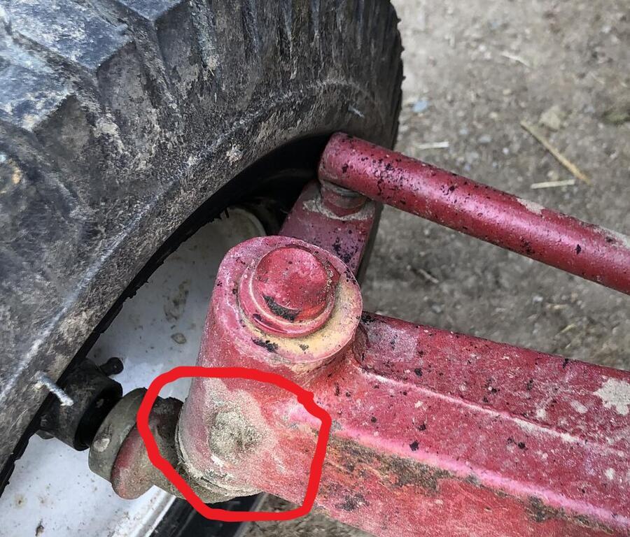

krystolo 504 #32 Posted April 9, 2021 20 minutes ago, pullstart said: @krystolo your name looks great in Red! Congrats on becoming a supporting member! are those 6” wheels? I can send you my 8’s but the tires are junk.. Yes, they are 6". I'm wondering if that's why the tires were rubbing on the tie rod. Will I need to take the wheels and tires to a tire shop to get them on the rims, or is that something I'm able to do with my handy screw driver and socket set? 1 Share this post Link to post Share on other sites
Achto 32,095 #34 Posted April 9, 2021 15 minutes ago, krystolo said: Will I need to take the wheels and tires to a tire shop to get them on the rims, or is that something I'm able to do with my handy screw driver and socket set? It ain't fun ! But you can change the tires at home with a couple of large screw drivers, once you get the bead to break. It may be less frustrating to take them to a shop. In my area it cost about $10 to $15 per tire to have them changed. Note: if Kevin sends you some 8" rims your 6" tires will not fit on them. 3 Share this post Link to post Share on other sites

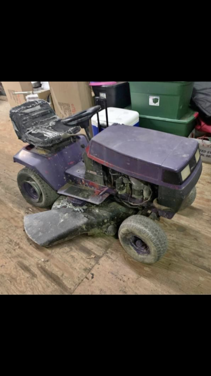

krystolo 504 #42 Posted April 9, 2021 I found this beast for $80. Think I can salvage the wheels, or better to just buy new? Seller isn’t sure about the model or year. Share this post Link to post Share on other sites
krystolo 504 #43 Posted April 9, 2021 13 minutes ago, pullstart said: If you feel like shipping me tires, I’ll mount em up for ya That’s so nice! Share this post Link to post Share on other sites
Tractorhead 9,217 #44 Posted April 9, 2021 3 minutes ago, krystolo said: I found this beast for $80. Think I can salvage the wheels, or better to just buy new? Seller isn’t sure about the model or year. That is a 211 or 212 Lawnmower made of sheetmetal, that is not to compare with any horizontalengine Wheelhorsesthey be completely different. front tyres are 6“ rears are 8“ Gearbox is just an Aluminumcase. 2 Share this post Link to post Share on other sites
953 nut 67,398 #45 Posted April 9, 2021 1 minute ago, krystolo said: found this beast for $80. Think I can salvage the wheels, or better to just buy new? Not sure but I think the rims and tires would fit but nothing else would fit your tractor. You would probably be beter off with the 8" rims like @pullstart has and new thre rib tires. The spindles you have are for 8" rims. 1 Share this post Link to post Share on other sites
Achto 32,095 #46 Posted April 9, 2021 6 minutes ago, krystolo said: I found this beast for $80. Think I can salvage the wheels, or better to just buy new? I'm sorry, I don't think that the parts from that one will fit on your tractor. Share this post Link to post Share on other sites
The Tuul Crib 7,354 #47 Posted April 9, 2021 8 minutes ago, krystolo said: I found this beast for $80. Think I can salvage the wheels, or better to just buy new? Seller isn’t sure about the model or year. Yikes !! 1 Share this post Link to post Share on other sites
krystolo 504 #48 Posted April 9, 2021 5 minutes ago, Achto said: I'm sorry, I don't think that the parts from that one will fit on your tractor. I was worried it would be a mismatch. Doesn't look solid like my Rosie. Share this post Link to post Share on other sites
krystolo 504 #49 Posted April 9, 2021 6 minutes ago, 953 nut said: Not sure but I think the rims and tires would fit but nothing else would fit your tractor. You would probably be beter off with the 8" rims like @pullstart has and new thre rib tires. The spindles you have are for 8" rims. Thought the tires looked small. I'd probably be in the same shape I'm in now. LOL Share this post Link to post Share on other sites

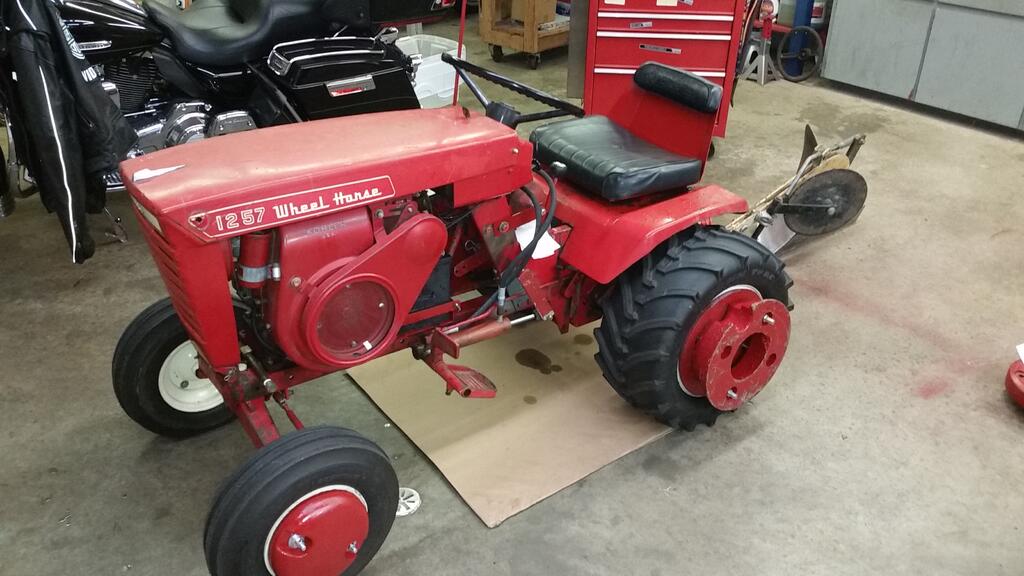

WHX?? 57,392 #50 Posted April 9, 2021 (edited) 50 minutes ago, pullstart said: If you feel like shipping me tires, I’ll mount em up for ya He's just sucking up Krys.... said the same thing to me just so he got invited to summer camp to drive lever steers and plow days to bum tires off me.... No those rims would not work... take the rims Kev is offering. This is what they would look like on your tractor with the very affordable tri ribs Dan mentioned, less the weights of course, and I think they would do well for how you are working the tractor. These are the ones I favor but 85 Georges a piece. Someday when I am man enough to have a C-160 these are what she'll get dang the cost. Edited April 9, 2021 by WHX24 1 1 Share this post Link to post Share on other sites
