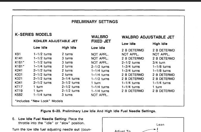

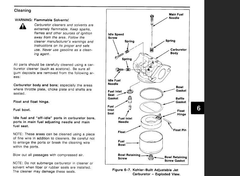

Machria 78 #33 Posted April 13, 2021 I still need to get my carb adjusted properly, it's "ok", but definitely not right. A bit of missing and backfiring, and now idling to high... can't seem to get it right. The manual talks about 2 different carbs, a Kohler carb, and a Walbro carb, my carb guy said I have the Kohler carb. The adjustment instructions in the manual tells you how to do both, but only pictures the walbro carb to go with the adjustment description. Here is a pic of my carb, and what I think is the correct screws. Just to be sure, do I have this correct? And, the idle speed screw, looks to work by simply hitting a small piece of metal sticking up, screwing it in, pushes it out which pushes the throttle open a bit and vice versa. That is all it is doing for idle speed right? The other thing is, I kinda screwed up the choke cable. I bent it trying to get it off, and now it doesn't really work to well opening and closing the choke. I wonder if there is a better way to attach the end of the wire/cable, to the choke "yoke" (or whatever it is called). It has a hole in it, I'm wondering if I can put a small bolt thru the hole, and attach the cable to the screw with a small loop at the end of the cable, instead of trying to get a proper bend to go thru the hole and stay there/work properly?? Share this post Link to post Share on other sites
pfrederi 21,183 #34 Posted April 13, 2021 Your assessment of idle speed is correct. Just an adjustable stop. 1 Share this post Link to post Share on other sites
