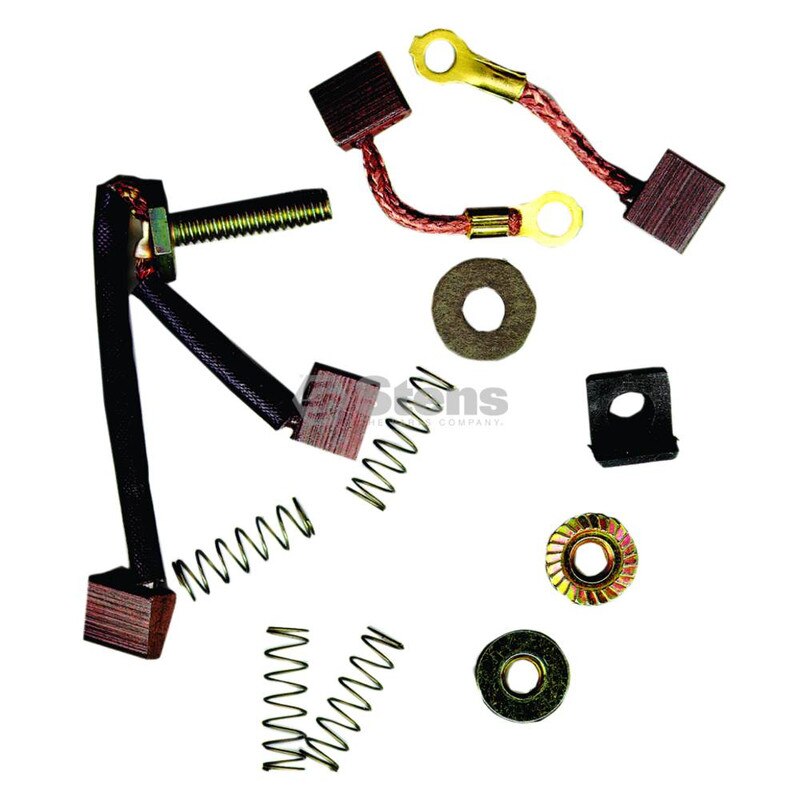

953 nut 70,324 #2 Posted April 8, 2021 This what you were looking for? https://www.stens.com/435-535-starter-brush-kit Share this post Link to post Share on other sites
gwest_ca-(File Mod) 12,532 #3 Posted April 8, 2021 Starter bushings wear oval because of the side load. This increases the friction and drag greatly so the starter slows down. This Canadian Stens dealer has a kit that includes the bushings but the part number is different and not recognized at the Stens site. https://www.bantasaw.com/catalog/viewproduct.asp?i=1475&p=5140 Garry 1 Share this post Link to post Share on other sites

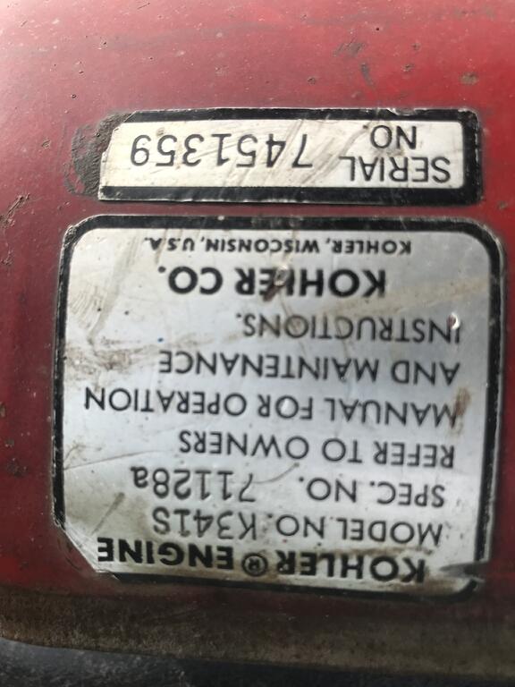

CB520HC 61 #6 Posted April 24, 2021 So out of curiosity this kit appears to be for a kt style starter? Or at least that’s how it is pictured? I have a k341 that that starter gave out in and am in need of a full rebuild kit for it brushes and bushings. Anybody know of a kit other than the $12 one from eBay?? Pic is the data tag off engine. Share this post Link to post Share on other sites
gwest_ca-(File Mod) 12,532 #7 Posted April 25, 2021 Here is a parts list that will give you original part numbers https://www.partstree.com/models/k341-71128-kohler-k-series-engine-made-for-wheel-horse-16hp-11-9kw/ Garry Share this post Link to post Share on other sites
