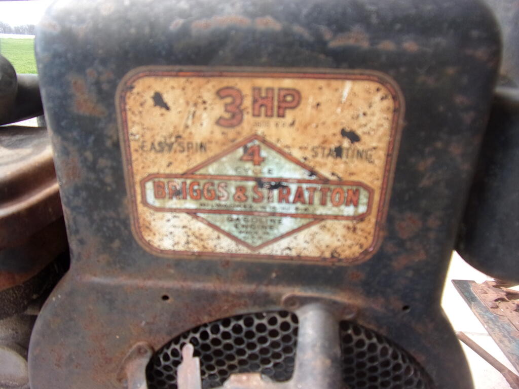

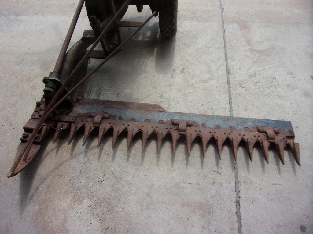

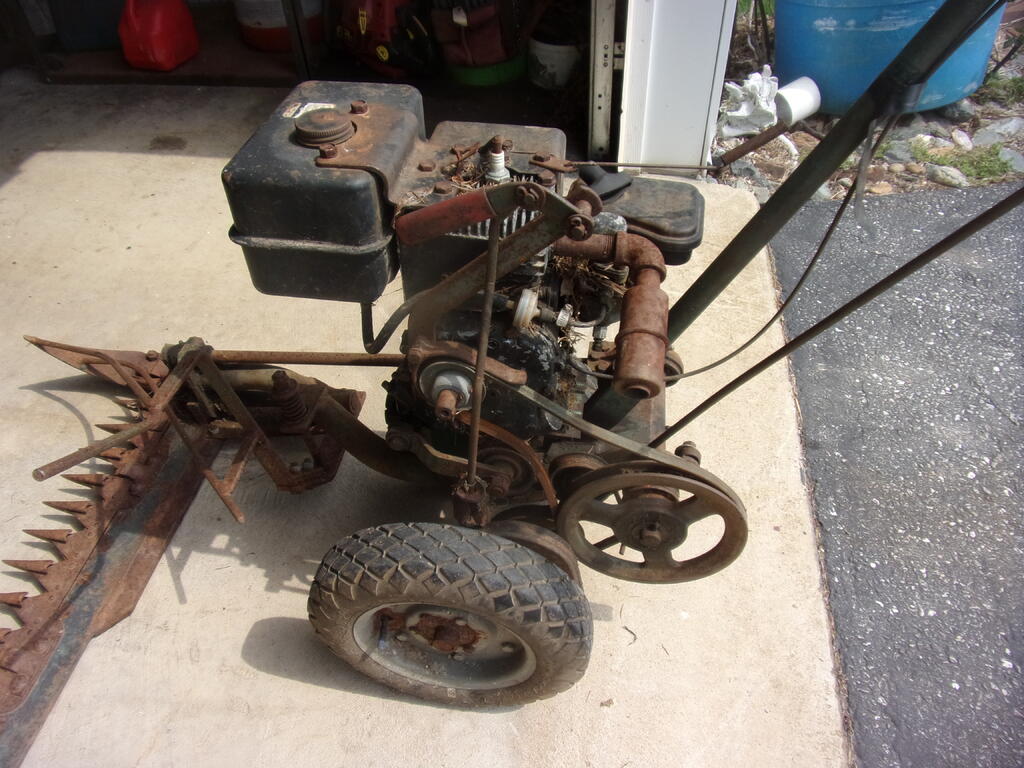

Ed Kennell 47,254 #1 Posted April 7, 2021 I don't know why I bought it. Certainly not looking for a project and I don't have any weeds to mow, but it is kinda cute and it's all there and all parts move. I just neeed to find some spark. 8 12 1 Share this post Link to post Share on other sites

Achto 32,630 #3 Posted April 7, 2021 8 minutes ago, Ed Kennell said: I just neeed to find some spark. Cut the wire that goes to the points and replace your coil with a Briggs solid state coil part # 793281 or aftermarket equivalent. No reason to pull the fly wheel and no more points to worry about. 5 2 1 1 Share this post Link to post Share on other sites

WHX?? 58,052 #7 Posted April 7, 2021 I think its pretty cool. Dan beat me to it Ed. I got the same motor in 5 HP flavor on the driveway blower & got tired of pulling the flywheel just to dollar bill the points. All it ever took to get it running after setting over winter. 'Sides crank threads were taking a beating and didn't have the correct spanner for the nut. Put the solid state on and never looked back. No can do Silvia .. my girls have already got that moniker on Pullstart's sickle. 4 1 Share this post Link to post Share on other sites

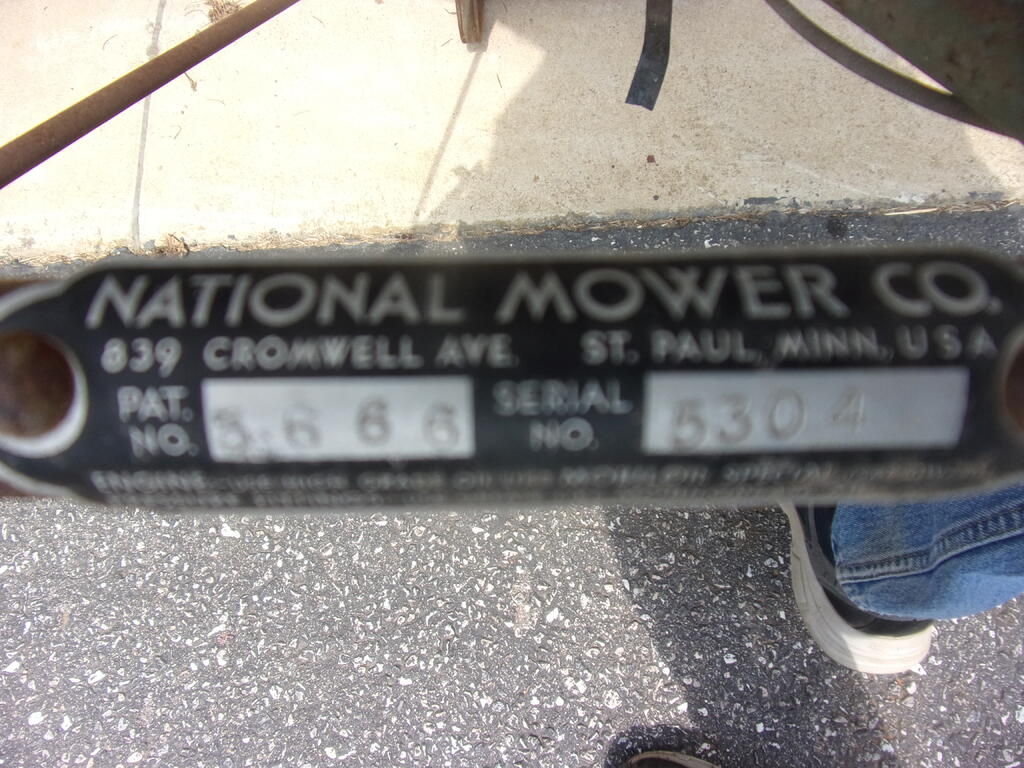

1mor Project 104 #15 Posted April 8, 2021 I've got one just like it. In the 50's through 70's my uncle built those and ran their service department on week ends. All my cousins worked there also over the years. Due to this affiliation I also have two 84 inch cut Triplexes and two 30 inch riders. The offset on your sickle bar allows cutting under fence lines, so that is handy. That's about all I use it for. The Triplex cuts grass like crazy, but one needs engine work and the other sat outside for 10 plus years before I got it, and a couple years since, so who knows. I've got Wheel Horses that I enjoy working on and cruising on, so the Nationals sit. 2 1 Share this post Link to post Share on other sites

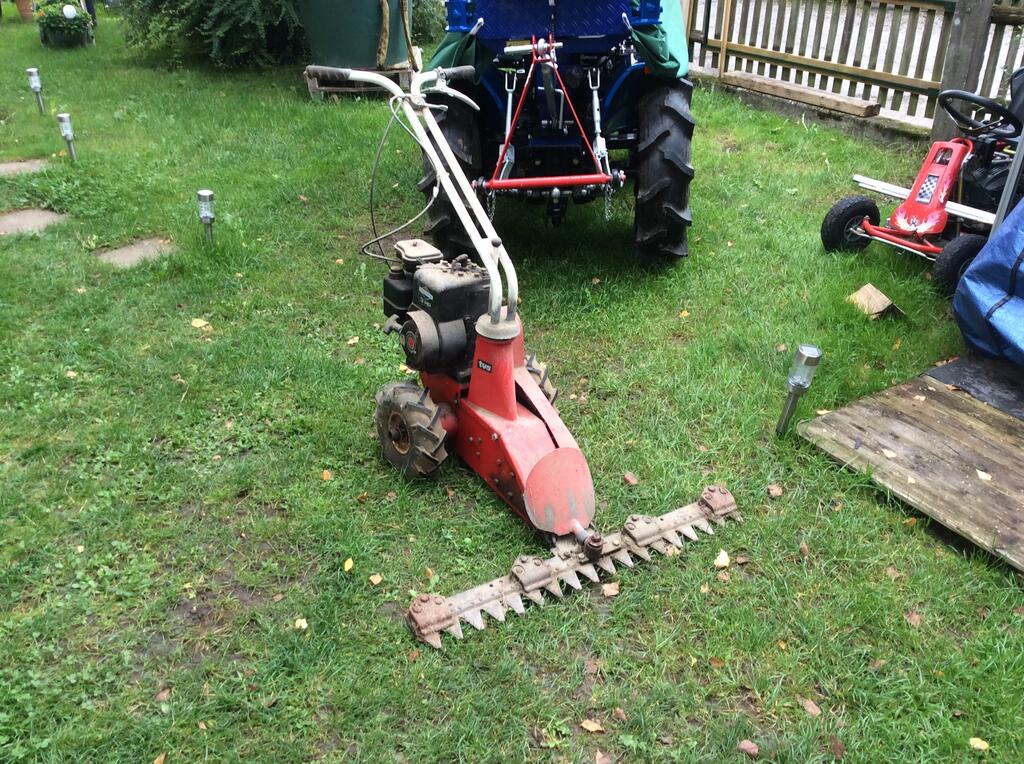

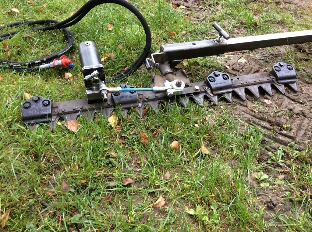

Tractorhead 9,217 #16 Posted April 8, 2021 10 hours ago, Ed Kennell said: If the Briggs decides to be a non-runner.....This may end up on the front of a plow frame Mad Max style. I like to reuse Things in a Way they don‘t imagine what they can simplify for you.. A Basic Sicklebar Mower with a defect Engine becomes with a few pieces of Steel and a added Hydraulic motor a complete new Challenge, that works like a Charme.. Sorry for the Woobly Vid, i mounted the Gopro on a bad vibrating section. 2 2 1 Share this post Link to post Share on other sites

Ed Kennell 47,254 #18 Posted April 8, 2021 7 hours ago, 1mor Project said: I've got one just like it. In the 50's through 70's my uncle built those and ran their service department on week ends. All my cousins worked there also over the years. Due to this affiliation I also have two 84 inch cut Triplexes and two 30 inch riders. The offset on your sickle bar allows cutting under fence lines, so that is handy. That's about all I use it for. The Triplex cuts grass like crazy, but one needs engine work and the other sat outside for 10 plus years before I got it, and a couple years since, so who knows. I've got Wheel Horses that I enjoy working on and cruising on, so the Nationals sit. For sharing this family history. Now I am more likely to restore and preserve this machine. Looks like mine is a 1963...does that seem correct? 1 Share this post Link to post Share on other sites
WHX?? 58,052 #19 Posted April 8, 2021 11 hours ago, 1mor Project said: my uncle built those Where were they built 1 more? In MN or WI? 1 Share this post Link to post Share on other sites
Ed Kennell 47,254 #20 Posted April 8, 2021 Looks like mine was built in Minn. Jim. Share this post Link to post Share on other sites
