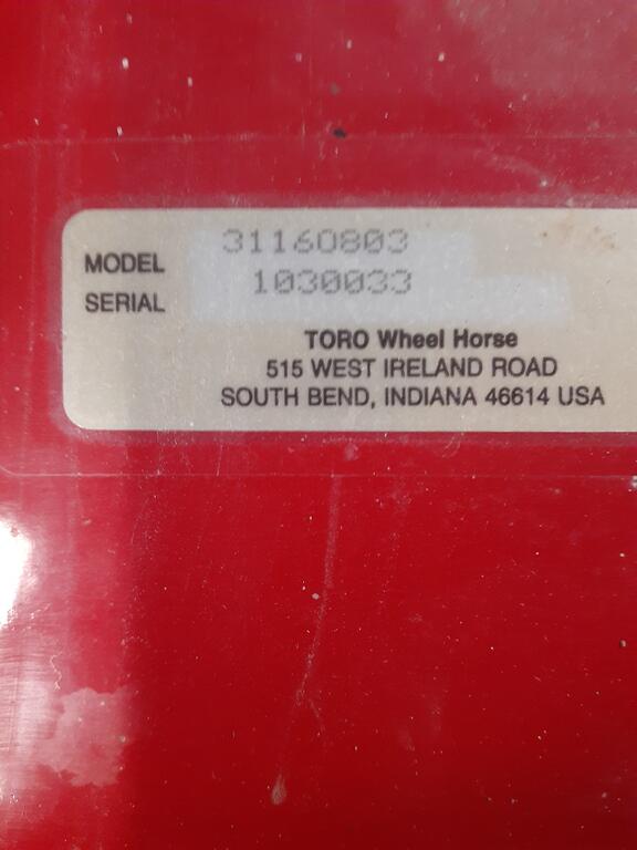

Unclekato 0 #1 Posted April 7, 2021 I have a 1991 416-8 with the onan and a 42" side discharge deck. I'm looking for the oem mule belt to the deck part #. Thanjs in advance Share this post Link to post Share on other sites
8ntruck 9,218 #2 Posted April 7, 2021 to the forum. I think there is a belt size list I'm the manuals section of the forum. Having the model number of the tractor and deck will be a help. Lots of good folks here on this forum. I'm sure somebody will come along with an answer for you soon. Share this post Link to post Share on other sites
Unclekato 0 #3 Posted April 7, 2021 There are a lot of choices on the Toro site. I would not want to guess Share this post Link to post Share on other sites
lynnmor 9,012 #4 Posted April 7, 2021 You likely have this deck.. Download the manuals for your tractor, engine and attachments found in the manuals section. 1 Share this post Link to post Share on other sites
gwest_ca-(File Mod) 12,453 #5 Posted April 7, 2021 Click on the fuzzy picture in the link Garry 2 Share this post Link to post Share on other sites
Unclekato 0 #7 Posted April 7, 2021 I appreciate the downloads but I need the oem part number for the belt that connects the motor clutch to the mower deck ( I thought that's what they called via the mule). Share this post Link to post Share on other sites
SadieCoonhound 8 #8 Posted April 8, 2021 The gentlemen gave you good information. Everything you asked for were in the down loads. However, if you couldn’t view them for some reason, the answer is: drive belt # 102742 replaced by 94-2501. Size is 1/2 x 103 in. I bought one today at Tractor Supply. Share this post Link to post Share on other sites
Unclekato 0 #9 Posted April 8, 2021 My bad. I did not see the last picture. Thanks everyone Share this post Link to post Share on other sites
