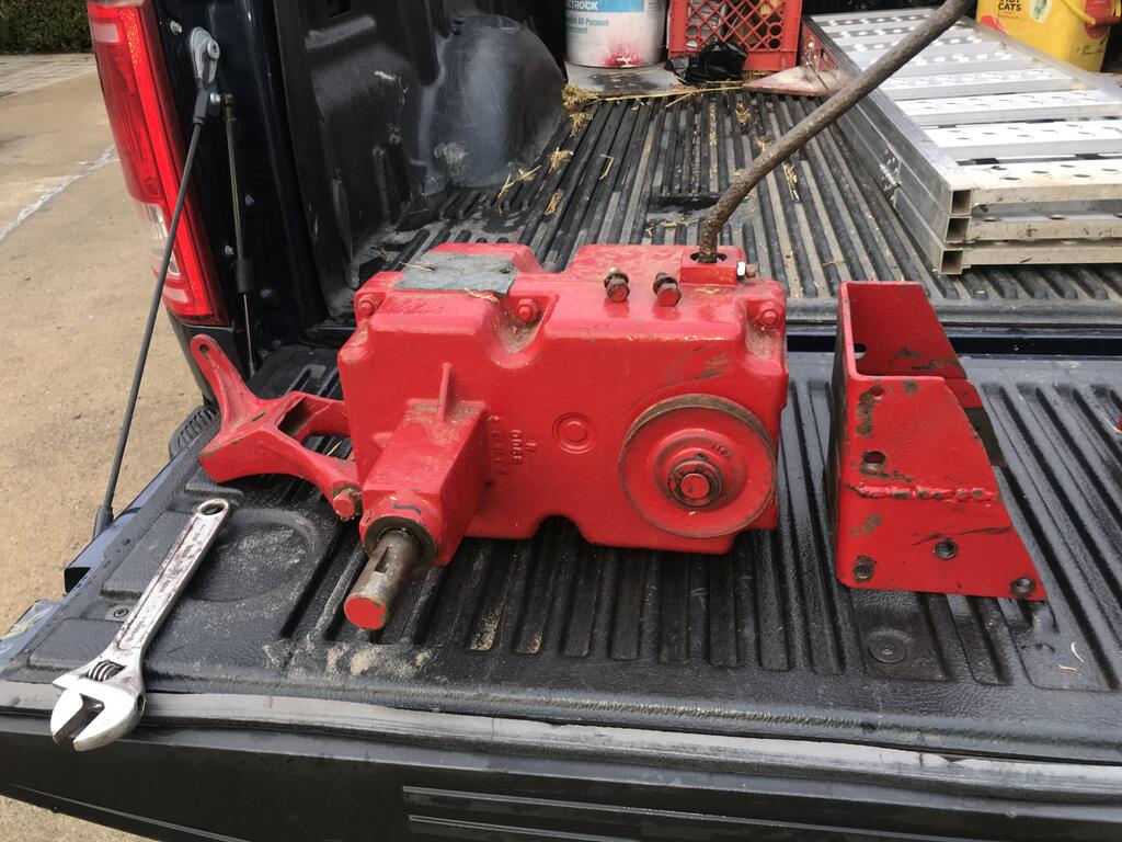

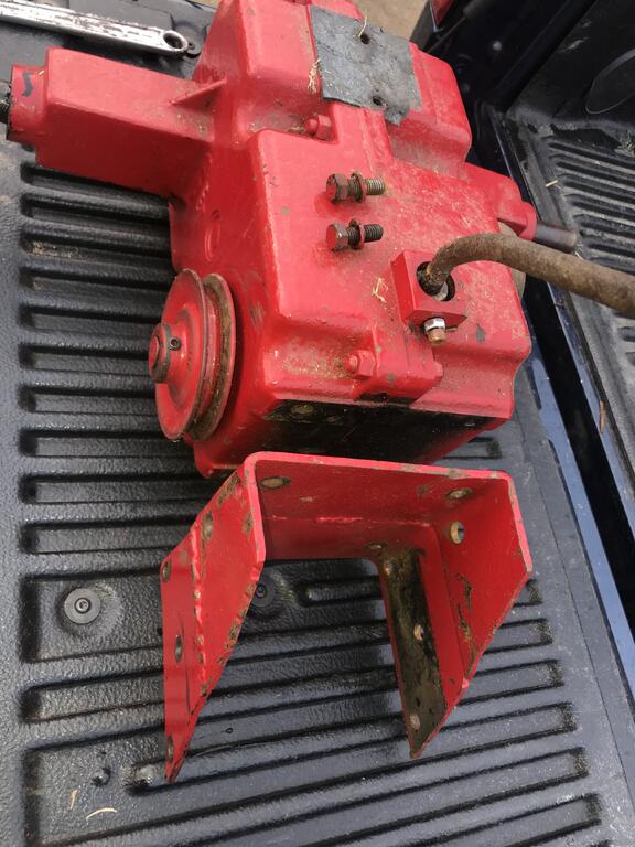

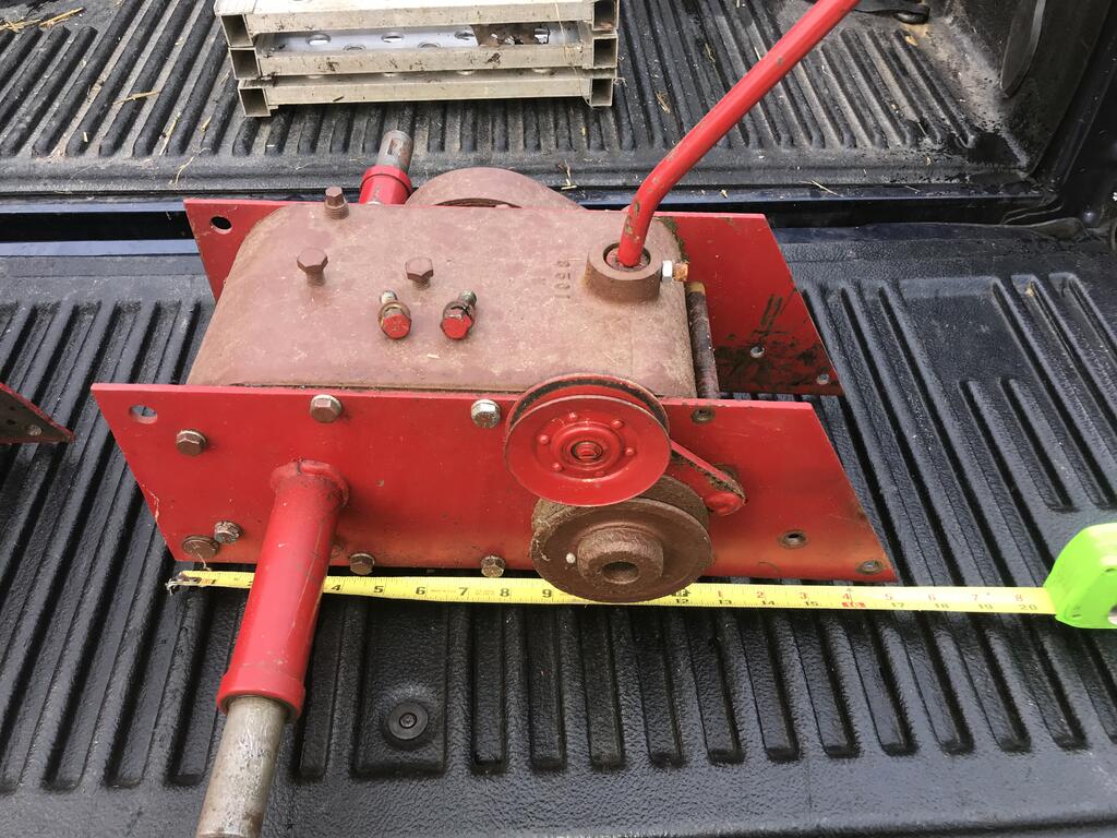

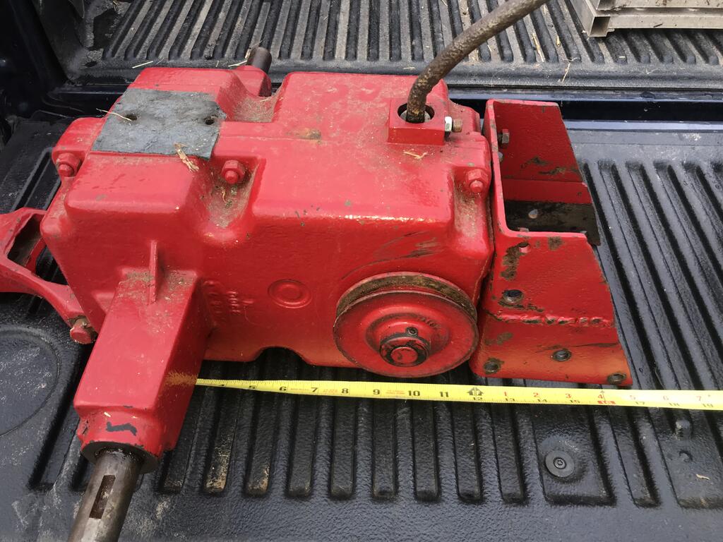

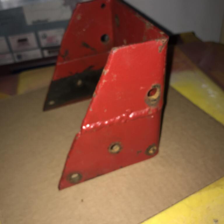

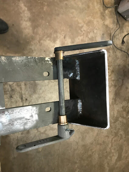

Lane Ranger 12,131 #1 Posted April 7, 2021 (edited) I bought this transmission and homemade plate last year. I gave the plate to a friend but this plate was made by someone who fabricated and welded it well to attach a two piece transmission to an RJ or Suburban Wheel Horse tractor. May be a necessary move as the parts for three piece transmission rebuild becomes more scarce and unusable. Edited April 7, 2021 by Lane Ranger 2 1 Share this post Link to post Share on other sites

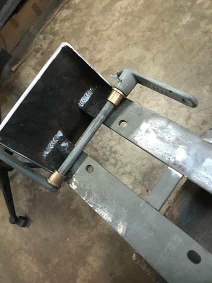

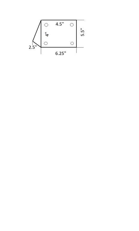

oliver2-44 11,767 #2 Posted April 7, 2021 I've had similar thoughts. That plate is similar to the replacement transmission mounting plate I made for my 551 Suburban Project ] Note, the sketch below is as close as I can determine the exact size of the original Suburban 551 Transmission Mounting Plate. Whem I made my new one, I added 1" to the top and bottom of the 2.5" side dimension. This gives a little more metal around the hole for the clotch rod. 2 Share this post Link to post Share on other sites
