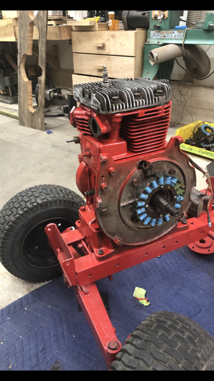

Achto 32,111 #5 Posted April 7, 2021 I paint my engines with the same acrylic enamel that I use to paint the rest of the tractor. The main part of the block gets 3 coats of paint, the cooling fins get 2 coats. I have never had issues with the paint or with cooling. No matter what paint you use, it will discolor by the exhaust port. I always leave my cylinder heads bare aluminum. 5 Share this post Link to post Share on other sites
pacer 3,180 #6 Posted April 7, 2021 14 minutes ago, Achto said: I paint my engines with the same acrylic enamel that I use to paint the rest of the tractor. The main part of the block gets 3 coats of paint, the cooling fins get 2 coats. I have never had issues with the paint or with cooling. No matter what paint you use, it will discolor by the exhaust port. I always leave my cylinder heads bare aluminum. Sounds like @Achto does almost exactly the way I do it. Prolly catch some flack for saying that I 'sand' blast the engine (coal slag) -- I bolt the head on with old gasket, put an old plug in, bolt the pan on, valve cover with gasket, double mask all the 'openings' -- in other words keep the 'sand' out, and get it cleaned. Last couple I've done I left the head in its nicely cleaned aluminum look. If care is taken with masking/blocking inlets it works just fine. And since I use "sunrise red" I put about 3 coats on for a really nice looking engine. As mentioned there will be some browning around the exhaust and somewhat around the head, with whatever you use. Share this post Link to post Share on other sites
The Tuul Crib 7,354 #7 Posted April 7, 2021 I did the same thing on my sixteen as @Achto did.Left the head bare aluminum Color on the rest. 1 1 Share this post Link to post Share on other sites

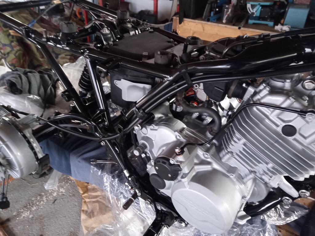

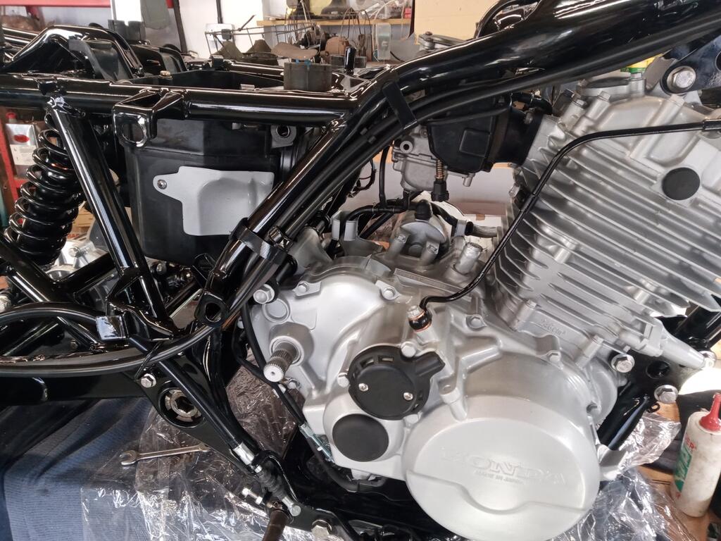

oliver2-44 11,632 #11 Posted April 7, 2021 4 hours ago, pacer said: Sounds like @Achto does almost exactly the way I do it. Prolly catch some flack for saying that I 'sand' blast the engine (coal slag) -- I bolt the head on with old gasket, put an old plug in, bolt the pan on, valve cover with gasket, double mask all the 'openings' -- in other words keep the 'sand' out, and get it cleaned. Last couple I've done I left the head in its nicely cleaned aluminum look. If care is taken with masking/blocking inlets it works just fine. And since I use "sunrise red" I put about 3 coats on for a really nice looking engine. As mentioned there will be some browning around the exhaust and somewhat around the head, with whatever you use. Share this post Link to post Share on other sites
