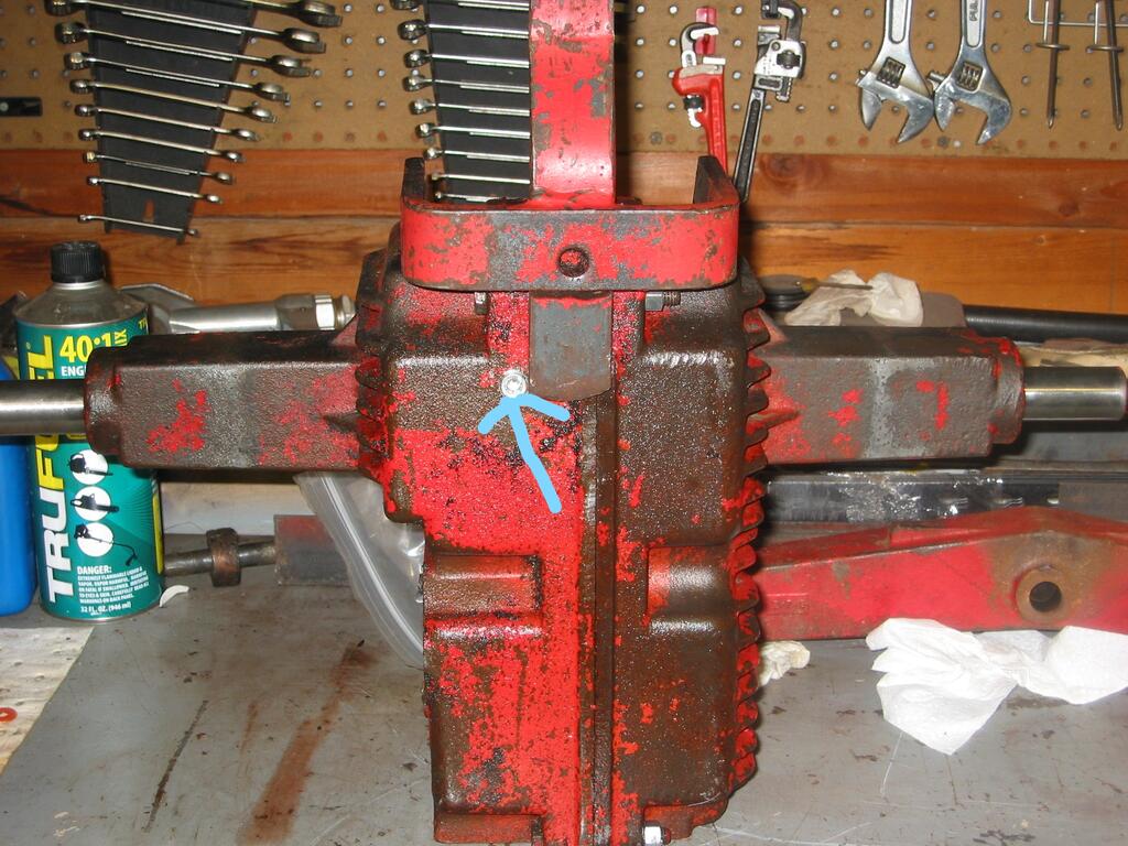

cat man 137 #32 Posted April 6, 2021 ok i got my motor oil drained ok but i cant tell where to drain the automatic trans on my C-120 can i get a pic from someone that shows me the right drain plug thanks Share this post Link to post Share on other sites
cat man 137 #33 Posted April 6, 2021 i got my motor oil drained but im not sure where the drain plug is on my automatic trans is can i get a pic of a c-120 automatic trans on where it is thanks Share this post Link to post Share on other sites
pfrederi 19,941 #34 Posted April 6, 2021 Bottom of tranny. You need a 1/4" Allen wrench. Make sure you clean the crud out of the hole first 1 Share this post Link to post Share on other sites
lynnmor 8,644 #35 Posted April 6, 2021 41 minutes ago, cat man said: i got my motor oil drained but im not sure where the drain plug is on my automatic trans is can i get a pic of a c-120 automatic trans on where it is thanks We could call in @krystolo who just graduated and now can be on the advisory panel. 2 1 Share this post Link to post Share on other sites
cat man 137 #36 Posted April 6, 2021 well i found the drain plug and got it drained and the filter changed where do i fill the trans back up at is there a plug or do i use the dip stick hole Share this post Link to post Share on other sites
cat man 137 #37 Posted April 6, 2021 30 minutes ago, pfrederi said: Bottom of tranny. You need a 1/4" Allen wrench. Make sure you clean the crud out of the hole first Share this post Link to post Share on other sites
cat man 137 #38 Posted April 6, 2021 where do i fill it back up at is there a plug or put it in the dip stick hole? Share this post Link to post Share on other sites
ebinmaine 77,508 #39 Posted April 6, 2021 12 minutes ago, cat man said: dip stick hole That's the one. Just take it slow..... 1 1 Share this post Link to post Share on other sites
Handy Don 15,997 #40 Posted April 7, 2021 58 minutes ago, ebinmaine said: That's the one. Just take it slow..... REAL slow. The first two or three or almost four quarts go in easy. After that, the level gets close to the bottom of the dipstick tube and the air has trouble getting out. If that happens, it "burps" oil all over as an air bubble comes up the tube. Be ready with cardboard, newspapers, or some other protection under the tractor. Did this just last weekend and put the last two quarts in with a funnel going into a ¼" tub that I put down the dipstick hole. Propped up the funnel and every 10 minutes or so I put another 8 oz in the funnel then when off to do other tasks. Only two burps. 3 Share this post Link to post Share on other sites
krystolo 504 #41 Posted April 7, 2021 1 hour ago, lynnmor said: We could call in @krystolo who just graduated and now can be on the advisory panel. Haha! I sure did!! I even jacked up the front to get the last drops out. Filling it back up was a challenge, though. Kept burping and my “extension tube” piece of rolled up paper didn’t work so great. Going to add the last three quarts tomorrow. Kitty litter all over my driveway. Lol 1 Share this post Link to post Share on other sites
Jeff-C175 7,207 #42 Posted April 7, 2021 11 hours ago, Handy Don said: REAL slow. And do NOT get directly over the funnel to look down inside to see what the hold up is! At the exact moment that you do it will 'burp' and regurgitate a blob of oil right into your eye! Don't ask how I know this! 2 Share this post Link to post Share on other sites
