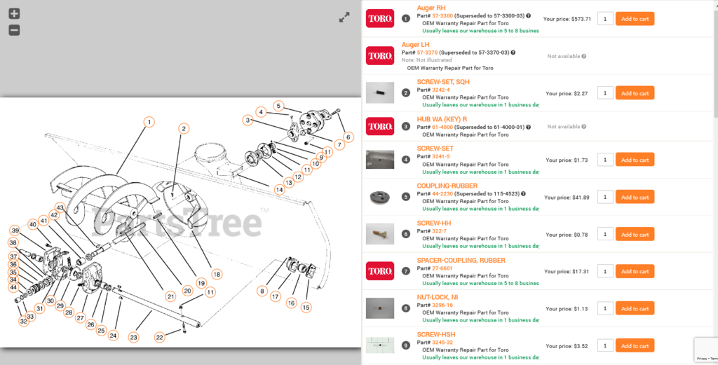

kajamo240 3 #1 Posted April 6, 2021 Hey guys. Got a new to me Toro Groundsmaster 120. Came with a mower deck and snowblower. (Model 30761, S#590323) I'm looking for a parts diagram for this snowblower. Does anyone have one that I could get? The shaft just behind the snowblower turns but its not spinning with the spindle from the engine. They're acting as if they are 2 different shafts. It's not snowing but no guarantee it won't since its only April. I verified that the differential IN with the blades works good and everything is fine. Just once the shaft is outside, it doesn't catch. (I can find manuals for all the other models but can't find this one for the life of me.) 1 Share this post Link to post Share on other sites
1995 520H+96+97 935 #2 Posted April 6, 2021 https://www.partstree.com/models/30761-toro-44-two-stage-snow-thrower-proline-118-120-groundsmaster-120-sn-210000001-210999999-2001/auger-assembly-0/ 1 Share this post Link to post Share on other sites
