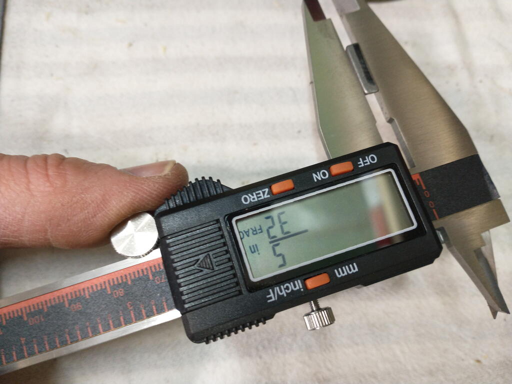

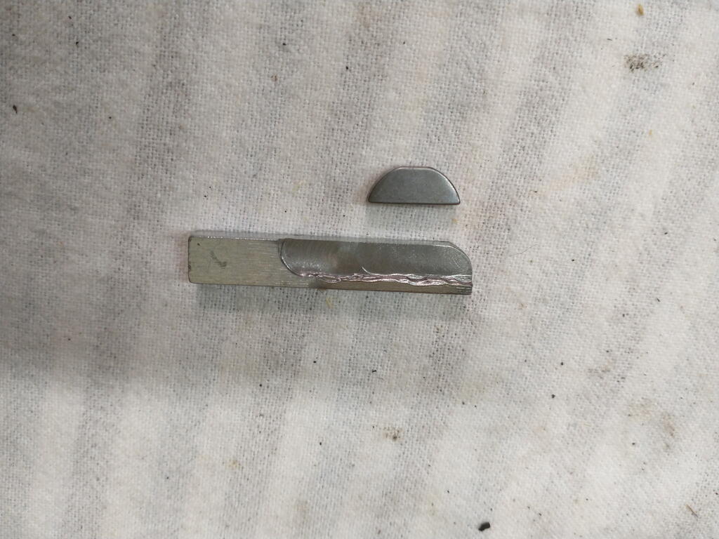

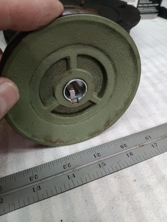

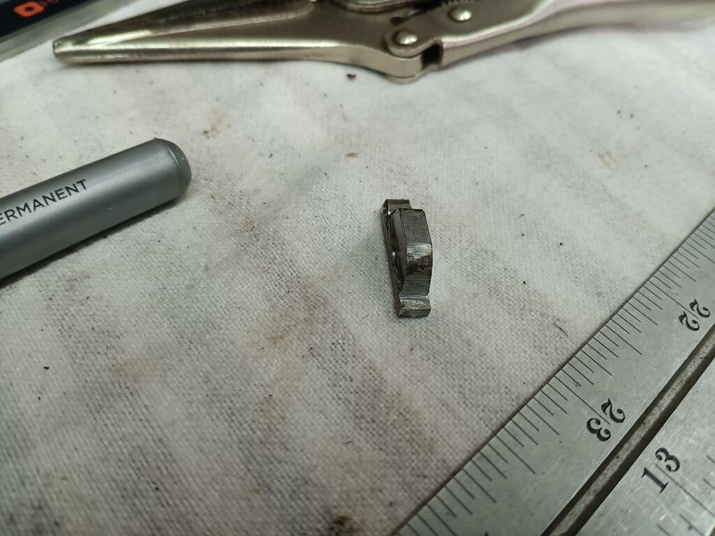

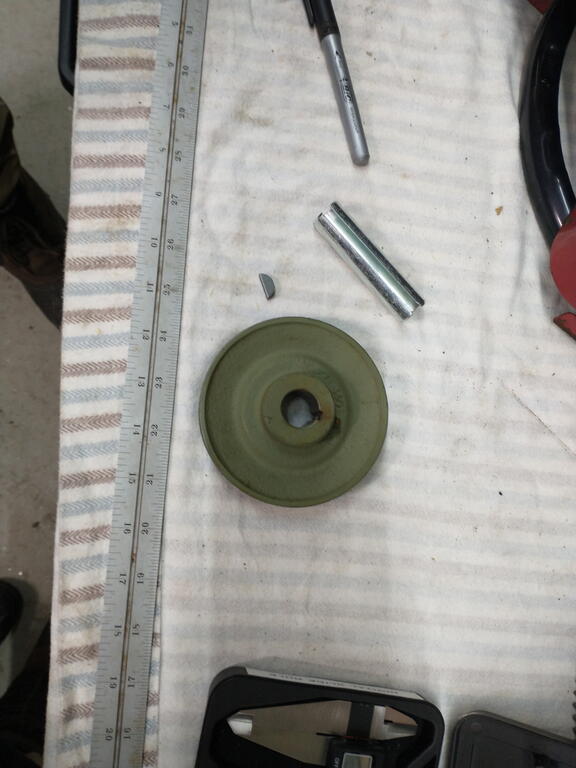

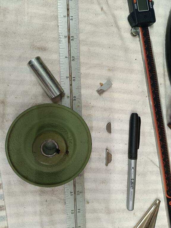

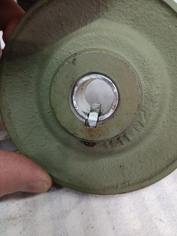

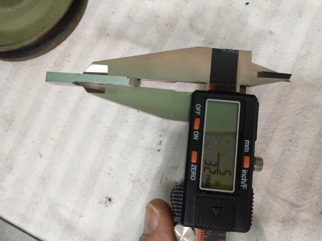

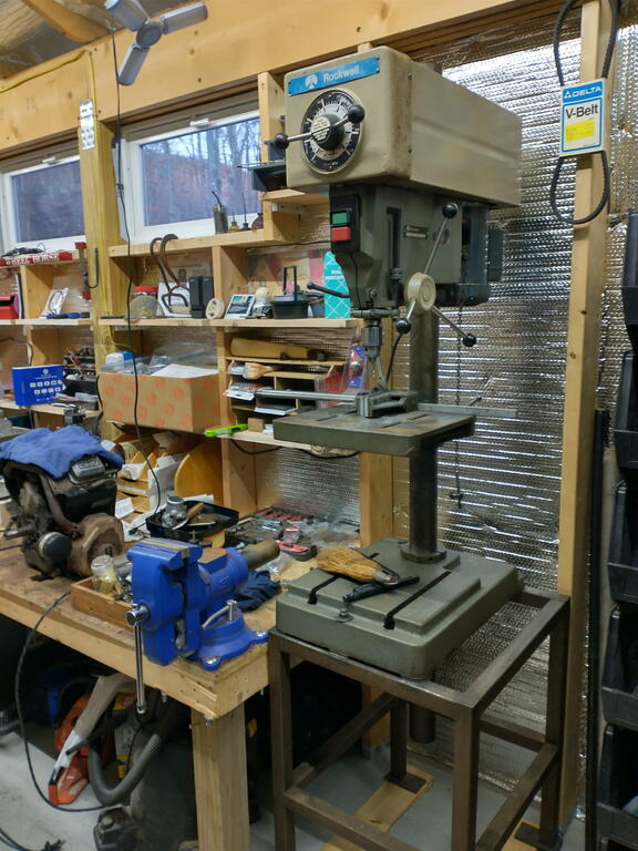

ebinmaine 80,974 #380 Posted January 3 A few weeks ago the BBT removed the S/G belt and replaced it. She also attempted replacement of the main drive belt. Turns out that transmission pulley was a semi universal that would accept either a 4L (1/2") or a 5L (5/8") wide belt. When using a 4L the belt sets lower in the V groove. The belt we had put on a year or three ago was an inch shorter than stock. No new belt that size handy so she put it all back together. A week later Trina disassembled the side of the tractor again so we could install the correct pulley and belt. Wrong size pulley bore. She put it all back together. Thanks to @Achto I ordered the correct sleeve. Trina disassembled the side of the tractor again so we could install the correct pulley and belt. Wrong size steps on the keyway. She put it all back together. I looked at 6 million ways to Sunday for the correct key. Nope. Well fine. I figured I'd test my skills with the new to me drill press. The adapter sleeve came with a metric key. I shaved ONE 128th off one side and shaved it from 3/16" to 5/32" for the small part of the step. I did the "shaving" by taking several dozen tiny downward cuts with a four fluted flat bottom mill bit. Effectively used it as a drill bit. Very slow. Very careful. Got it done. Here's some pics of the project. 6 Share this post Link to post Share on other sites

Handy Don 17,571 #382 Posted January 3 Nicely innovated, there. It’s for jobs like that I’ve got a cross-slide drill press vise on my wish list! 3 Share this post Link to post Share on other sites
ebinmaine 80,974 #383 Posted January 3 1 hour ago, Handy Don said: Nicely innovated, there. It’s for jobs like that I’ve got a cross-slide drill press vise on my wish list! I've been looking a little for a decent one. That'll be a tool I add for sure. Share this post Link to post Share on other sites
lynnmor 9,051 #384 Posted January 4 18 hours ago, ebinmaine said: I figured I'd test my skills with the new to me drill press. The adapter sleeve came with a metric key. I shaved ONE 128th off one side and shaved it from 3/16" to 5/32" for the small part of the step. I did the "shaving" by taking several dozen tiny downward cuts with a four fluted flat bottom mill bit. Effectively used it as a drill bit. Very slow. Very careful. Got it done. Here's some pics of the project. Now if we could just get you to use thousandths of an inch. 1 Share this post Link to post Share on other sites
ebinmaine 80,974 #385 Posted January 4 13 minutes ago, lynnmor said: Now if we could just get you to use thousandths of an inch. I'd like that precision, given proper tools. Share this post Link to post Share on other sites
lynnmor 9,051 #386 Posted January 4 13 minutes ago, ebinmaine said: I'd like that precision, given proper tools. The thing is working in fractions you might be off 1/64th (.015") one way or the other, if your calipers will read in thousandths at least you will know where you are. I just did a job for a greenhorn engineer and he drew everything in fractions with a plus or minus 1/64th tolerance. That thing would not have gone together if I even used half the tolerance. For about a century all machine tools have dials in decimals. 1 Share this post Link to post Share on other sites
ebinmaine 80,974 #387 Posted January 4 2 minutes ago, lynnmor said: The thing is working in fractions you might be off 1/64th (.015") one way or the other, if your calipers will read in thousandths at least you will know where you are. True. I stuck to fractions here because it's really more of a long term experiment and learning experience. I'd like to find and learn to use a decent quality cross slide vise with this drill press. I know I still won't have a mill but I certainly could be more precise about drilling locations. This drill press is a HUGE jump in precision from my older cheaper one but maybe not a tool I could use down to a thousandth. It does have a threaded depth stopper but it's a little worn. Share this post Link to post Share on other sites
