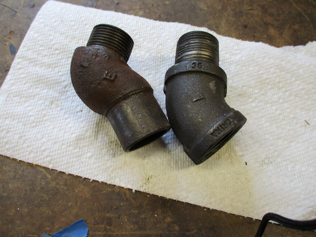

Raposo 532 #1 Posted April 4, 2021 Looking for an exhaust elbow that will fit on the factory cast fitting that comes off my magnum 12. I’d like to just put an elbow on it and run a chrome tip. I can’t seem to find anything that fits it tho! Share this post Link to post Share on other sites
pfrederi 20,891 #2 Posted April 4, 2021 You could remove the factory fitting (left) substitute a 1 " close nipple and 45. If I remember correctly a street ell 45 wind up bumping in to something 1 Share this post Link to post Share on other sites
Kenneth R Cluley 689 #3 Posted April 4, 2021 take a piece of tubing(possiblyEMT) cut a slit lengthwise, expand slightly, slip over and clamp to fitting. Share this post Link to post Share on other sites
