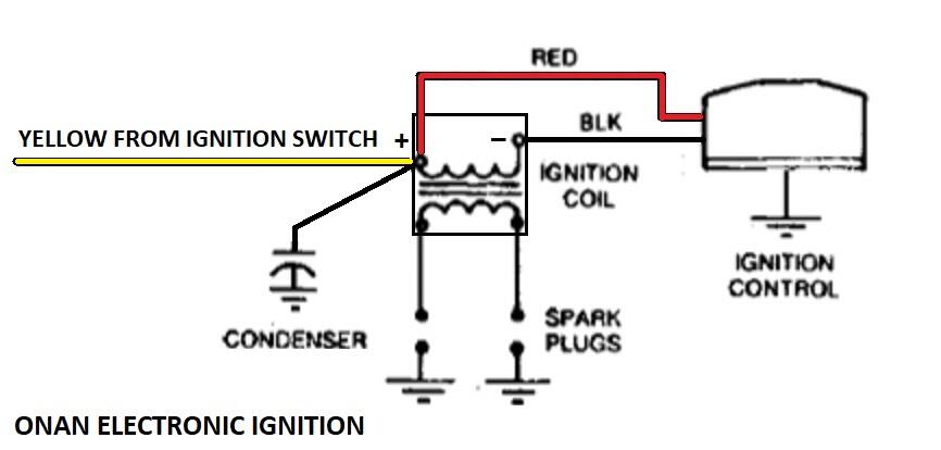

Virgil Fouts 1 #8 Posted April 12, 2021 Ok I can’t figure it out new key switch,fuses,relays and cleaned all the ground connections. Nothing has fixed the problem. I have a new coil but I’m not sure if the wires going to it are right. I have looked at the wiring stuff on line and none show what wires go where. The coil has two posts and was removed at some point but not sure what wires go where. And I did replace the condenser to but hooked it up the way the old one was. Any ideas thanks for the help. Share this post Link to post Share on other sites
gwest_ca-(File Mod) 12,322 #9 Posted April 12, 2021 Just one yellow wire from the tractor harness ignition switch goes to the coil (+) along with the condenser. No ground wire required. Share this post Link to post Share on other sites
gwest_ca-(File Mod) 12,322 #10 Posted April 12, 2021 On 4/4/2021 at 2:16 PM, Virgil Fouts said: Yes I just turned on the key and the pto switch doesn’t light up when it is engaged but it does light up when I hit the test button could that be the problem I don't think that is your problem. With the ignition key in START or RUN and the pto OFF you should have constant battery power at the ignition coil (+) Garry 1 Share this post Link to post Share on other sites
