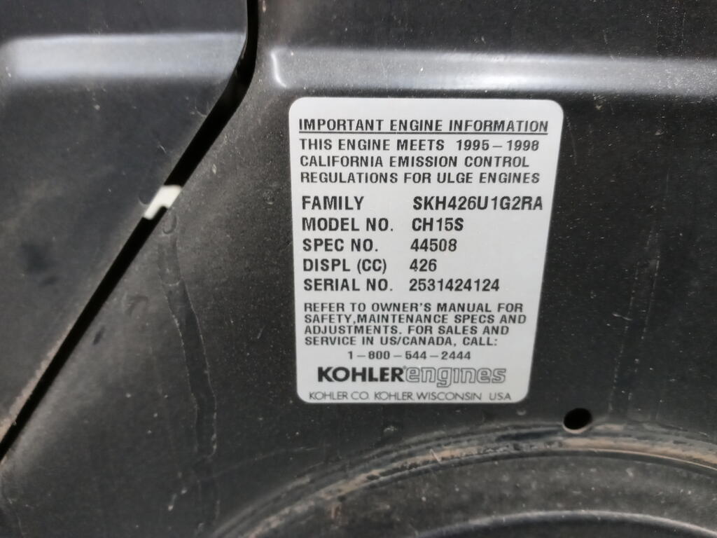

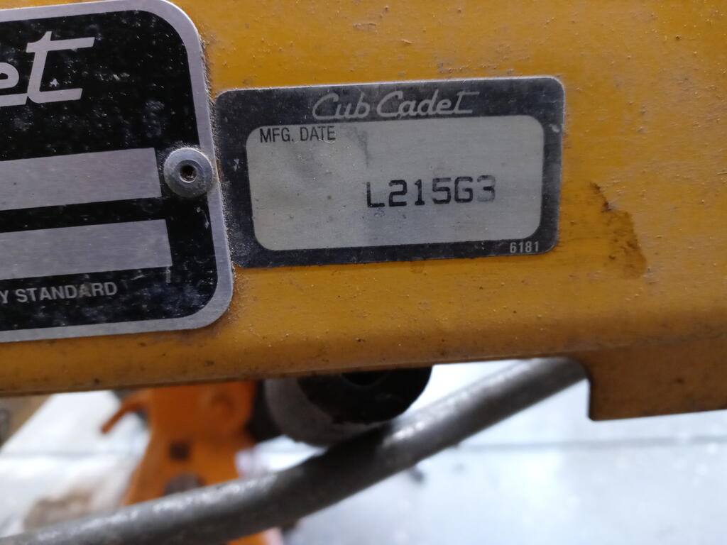

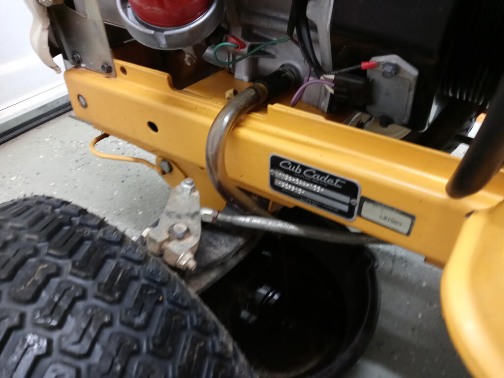

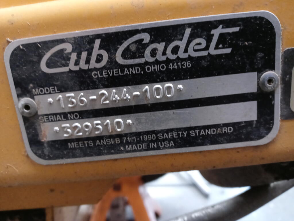

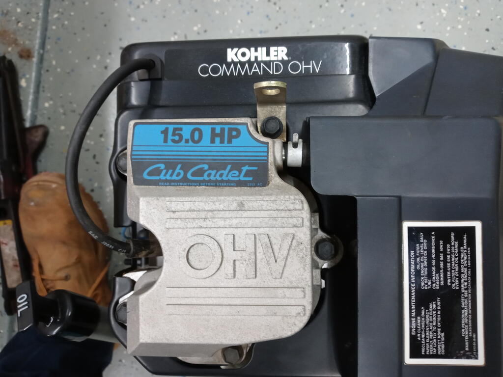

Horse Newbie 7,393 #1 Posted April 3, 2021 (edited) Okay guys, looks like I'll be ordering parts soon for my Cub Cadet tractor...can you all give me any info. on what year it may be by these pics of the manufacturer plates ? Edited April 4, 2021 by Horse Newbie Share this post Link to post Share on other sites

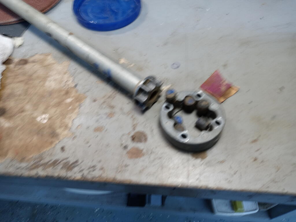

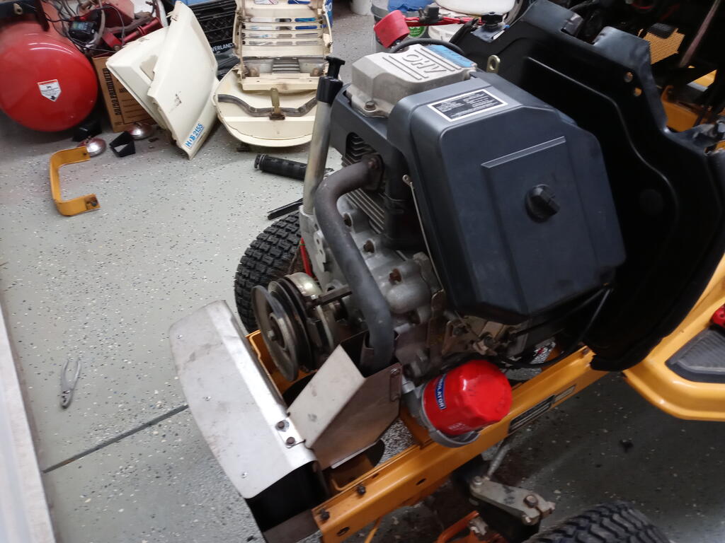

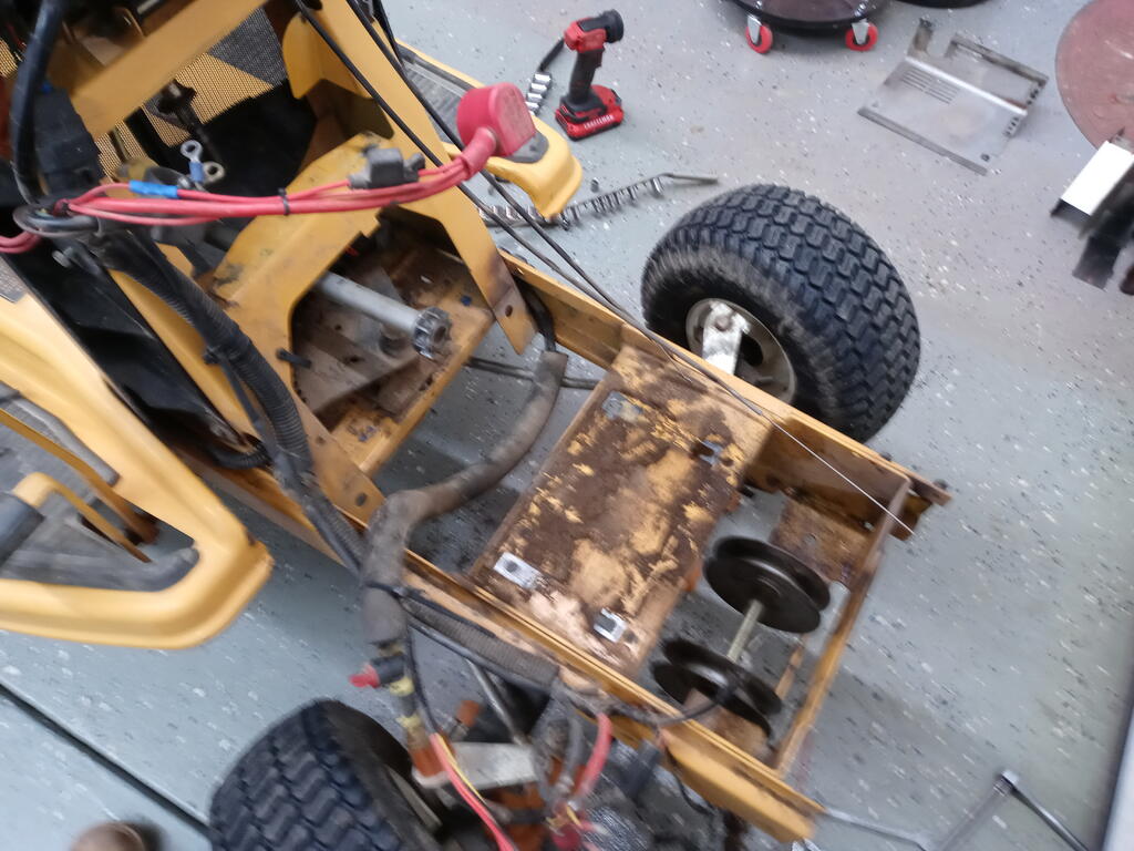

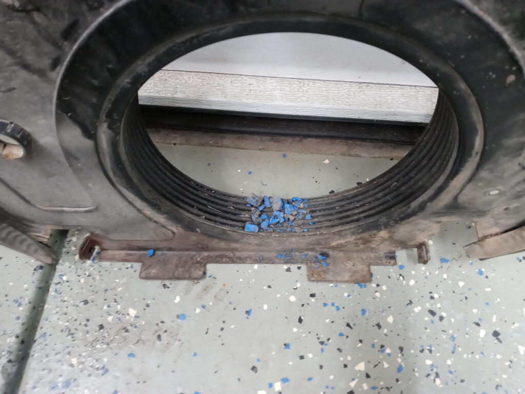

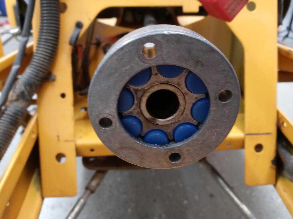

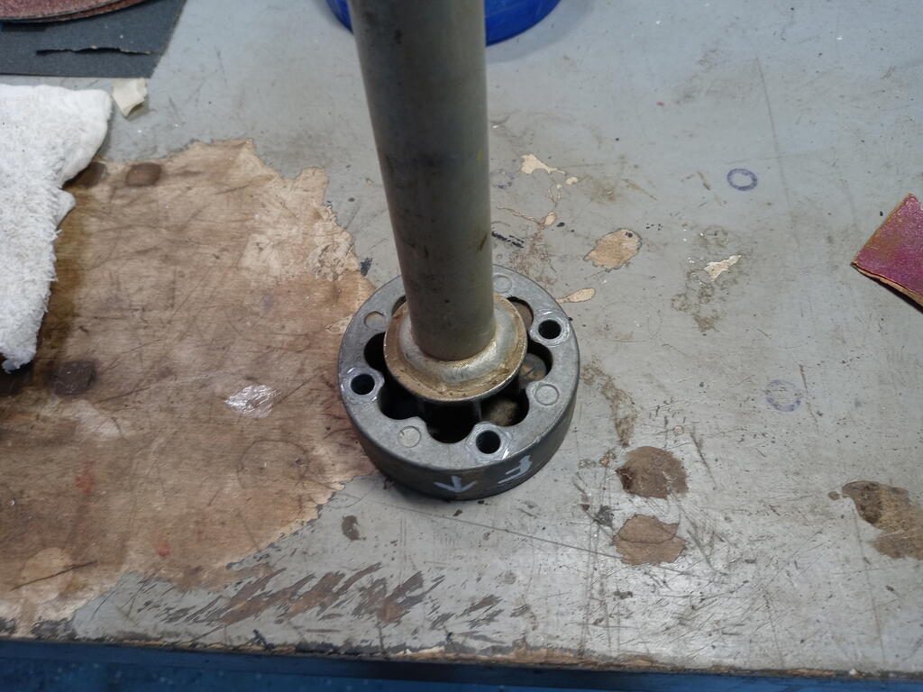

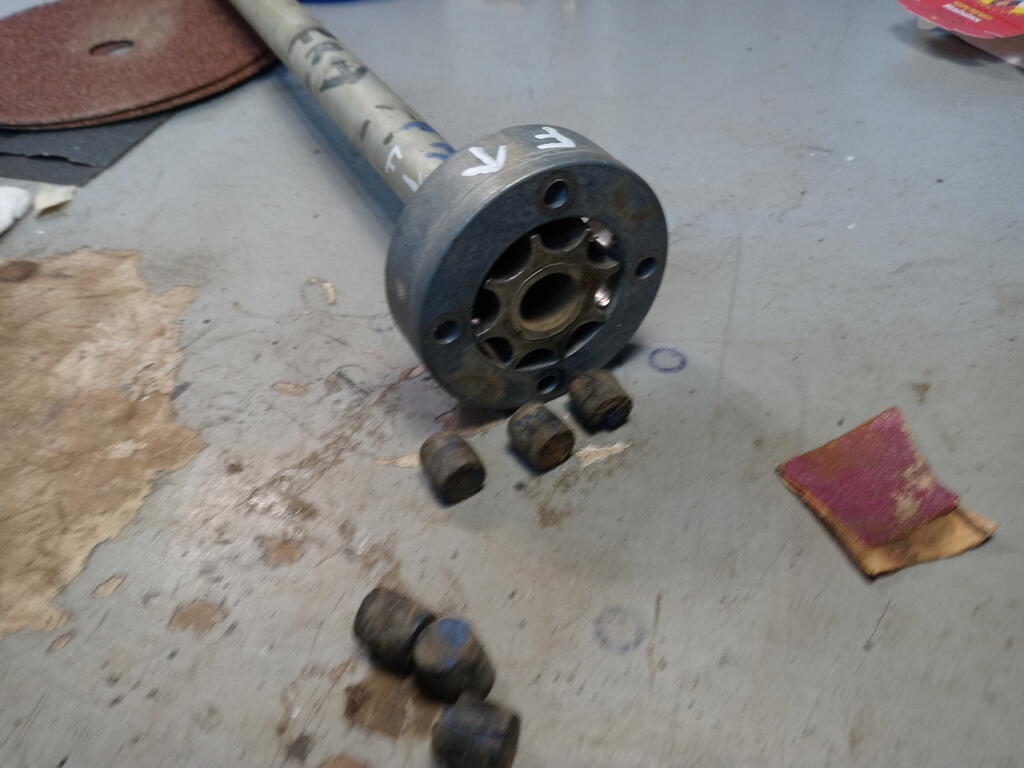

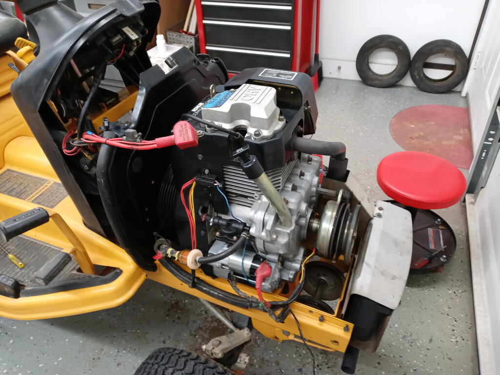

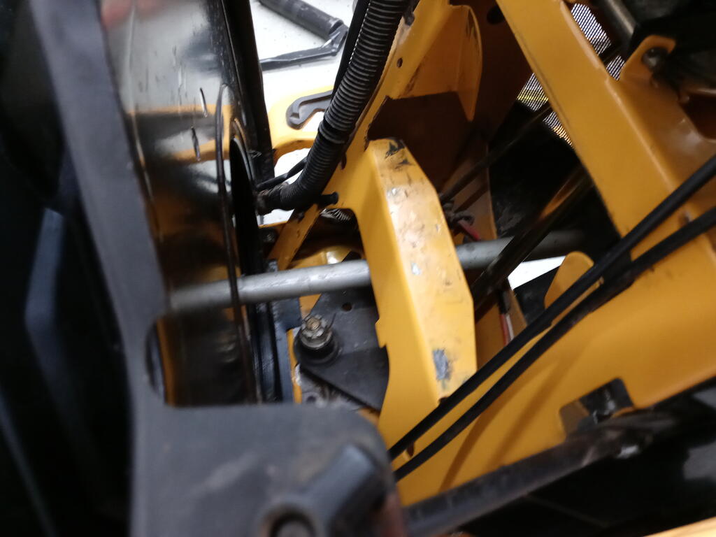

Horse Newbie 7,393 #2 Posted April 3, 2021 Seems my drive shaft adapter "barrel" thingys took a dump, and I had to pull the engine to get the driveshaft out. Share this post Link to post Share on other sites
T-Mo-(Moderator) 4,598 #3 Posted April 4, 2021 These were made in the mid to late 90s. I would have to dig into my hard drive to find the year break down. But in the meantime, how about the service manual? 2000service.pdf 1 Share this post Link to post Share on other sites

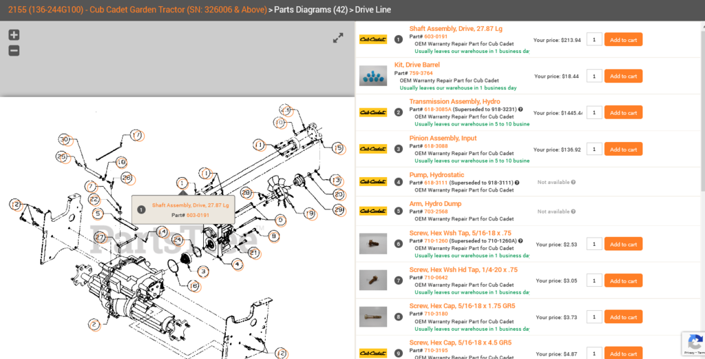

JoeM 8,229 #4 Posted April 4, 2021 (edited) Looks like Dec 21 1995 would be considered a 96. https://www.partstree.com/models/2155-136-244g100-cub-cadet-garden-tractor-sn-326006-above/drive-line-13/ Edited April 4, 2021 by JoeM 2 Share this post Link to post Share on other sites

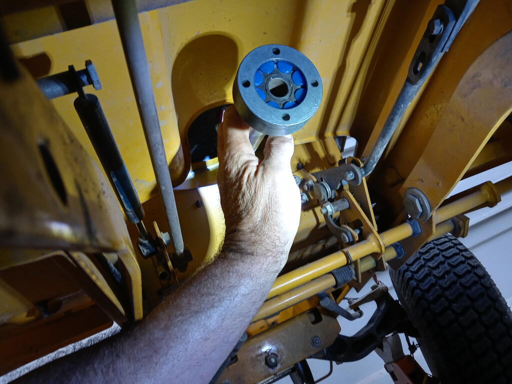

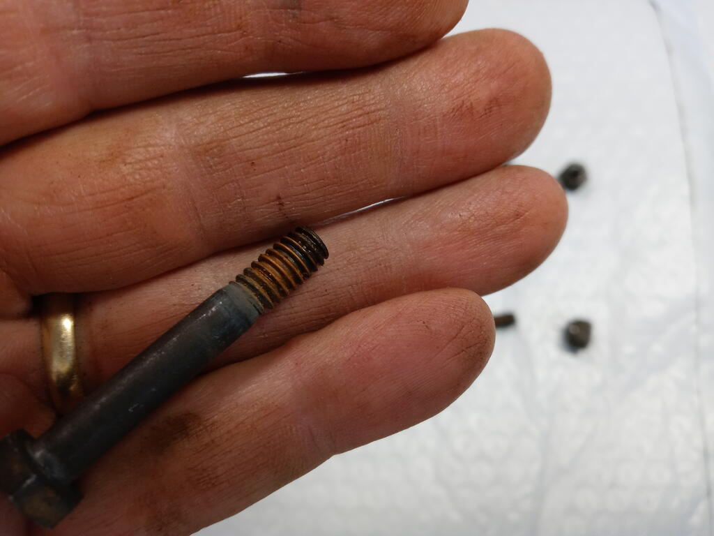

Horse Newbie 7,393 #6 Posted April 9, 2021 Today my Drive Shaft Barrels came in the mail... Got them put in the drive shaft (front and rear) and got the drive shaft back in... The nuts and bolts looked like they had red Loctite on them...I'll be going back with blue Loctite... Cleaned the engine... Next I'll be setting the engine back in... I've got grass to cut ! 1 1 Share this post Link to post Share on other sites

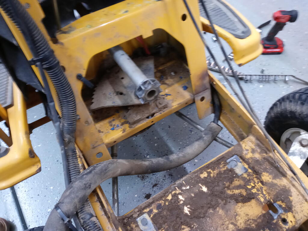

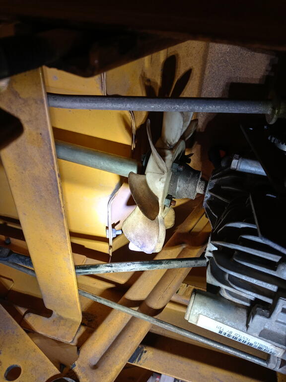

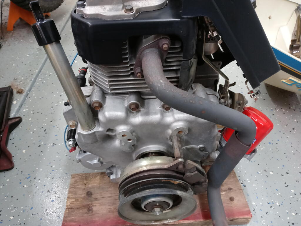

Horse Newbie 7,393 #7 Posted April 10, 2021 (edited) Came home today and worked on the Cub 2155... Got most of the replacing drive shaft "barrels" project done... Got the driveshaft back in, steering column back in, engine back in, muffler painted and back in, most wires and fuel line reconnected, throttle and choke cable reattached. All I have to do is the hood and hood side panels, and I'm gonna change the oil... While I'm on this tractor, I'm gonna change the oil...she's due. Edited April 10, 2021 by Horse Newbie 1 1 Share this post Link to post Share on other sites

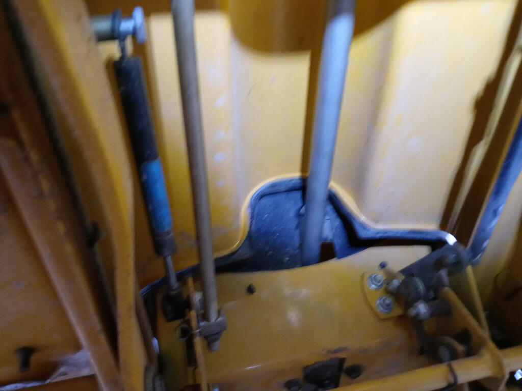

Horse Newbie 7,393 #10 Posted April 11, 2021 Got the hood back on today after my road trip to get the Workhorse...warmed the engine oil and drained for oil change tomorrow... I keep a log book of all maintenance and repairs on my equipment... 1 1 1 Share this post Link to post Share on other sites

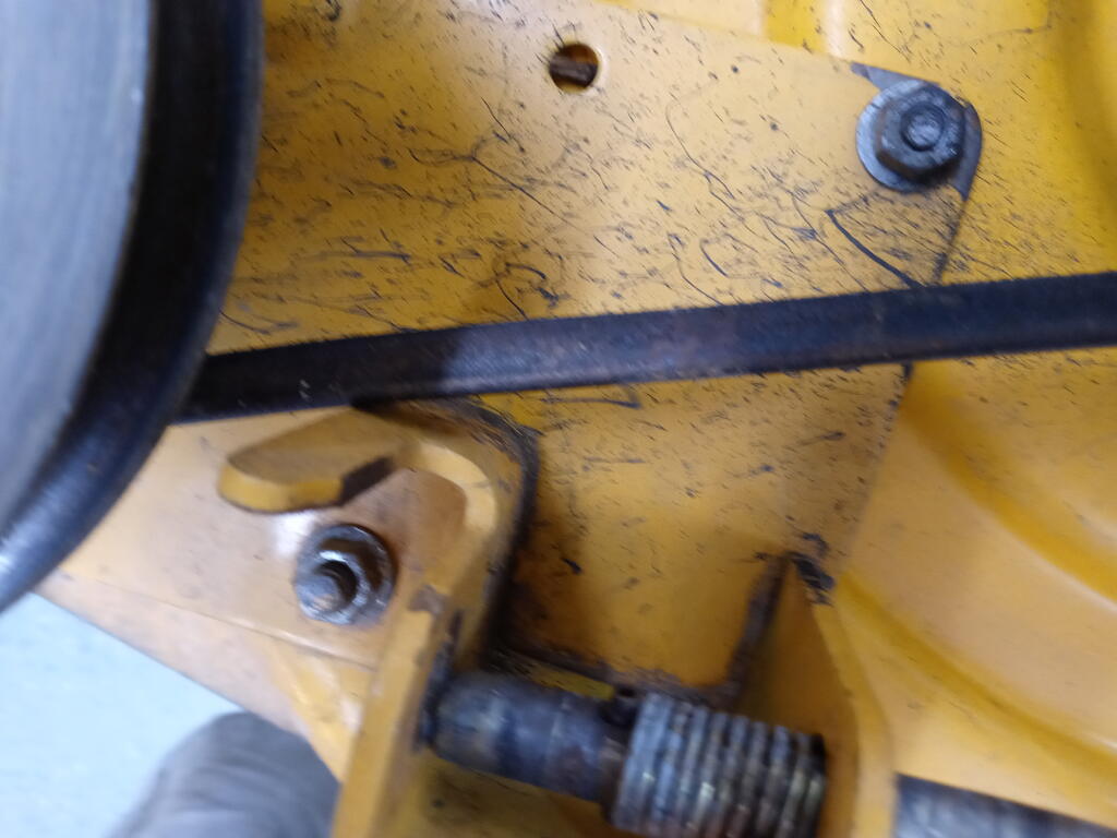

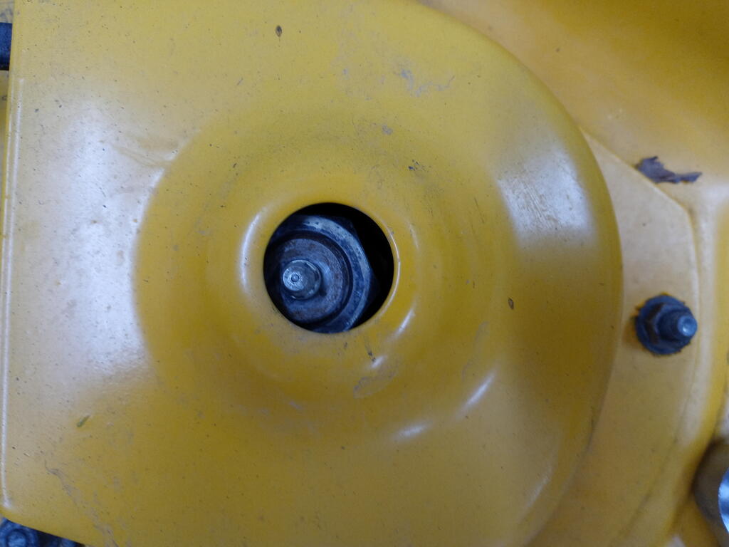

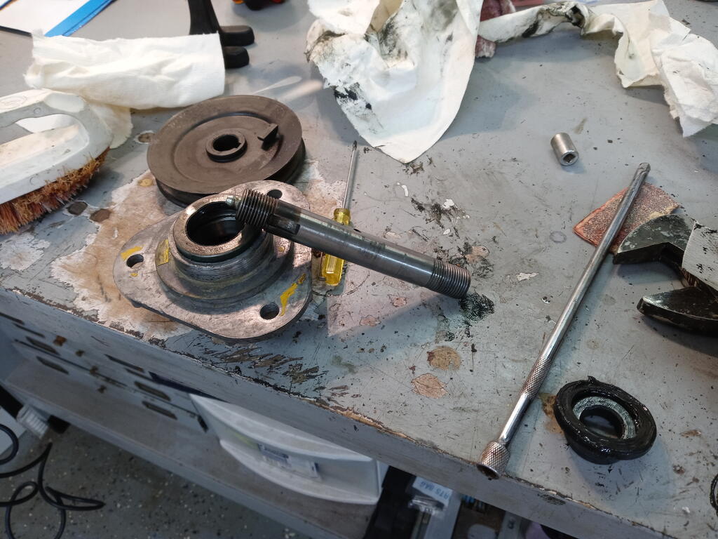

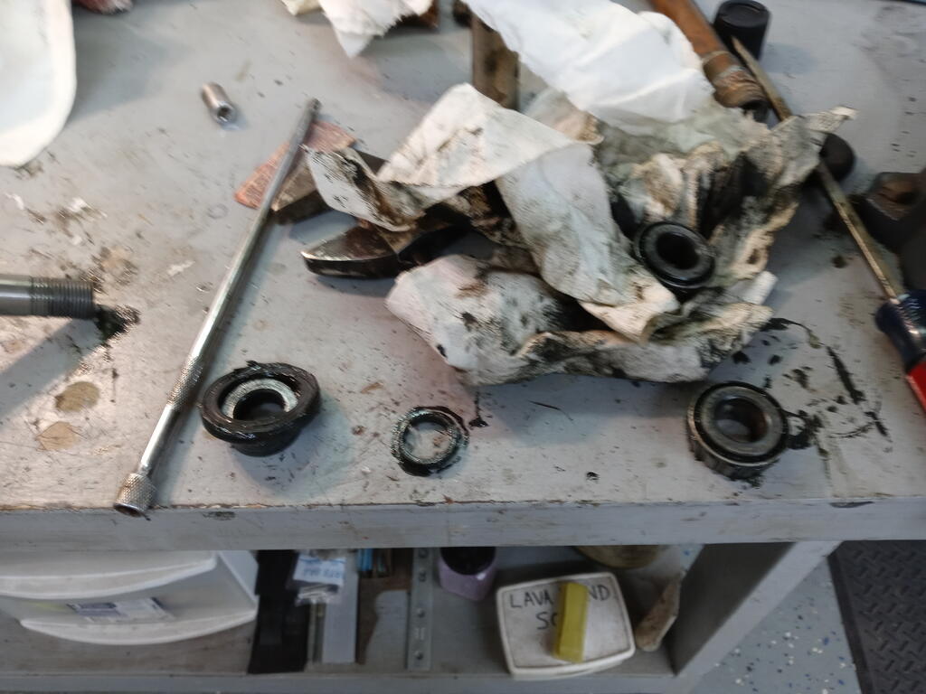

Horse Newbie 7,393 #11 Posted April 13, 2021 (edited) I guess I'm gonna goa hair...but while I was repairing the drive shaft barrels on my 1996 Cub Cadet 2000 Series 2155 HDS, and putting it all back together I figured I would give the deck a good once over since I was gonna sharpen the blades. I noticed the deck belt was rubbing a bracket and the grease zert was off center of the pulley guard. I have been wondering why I was never able to get it to cut grass level... Well as it turns out I have a bent spindle shaft on the right side...ordered a new shaft, bearings, and grease seals from PartsTree... Then I should be ready to scare some gophers ! Edited April 14, 2021 by Horse Newbie Share this post Link to post Share on other sites

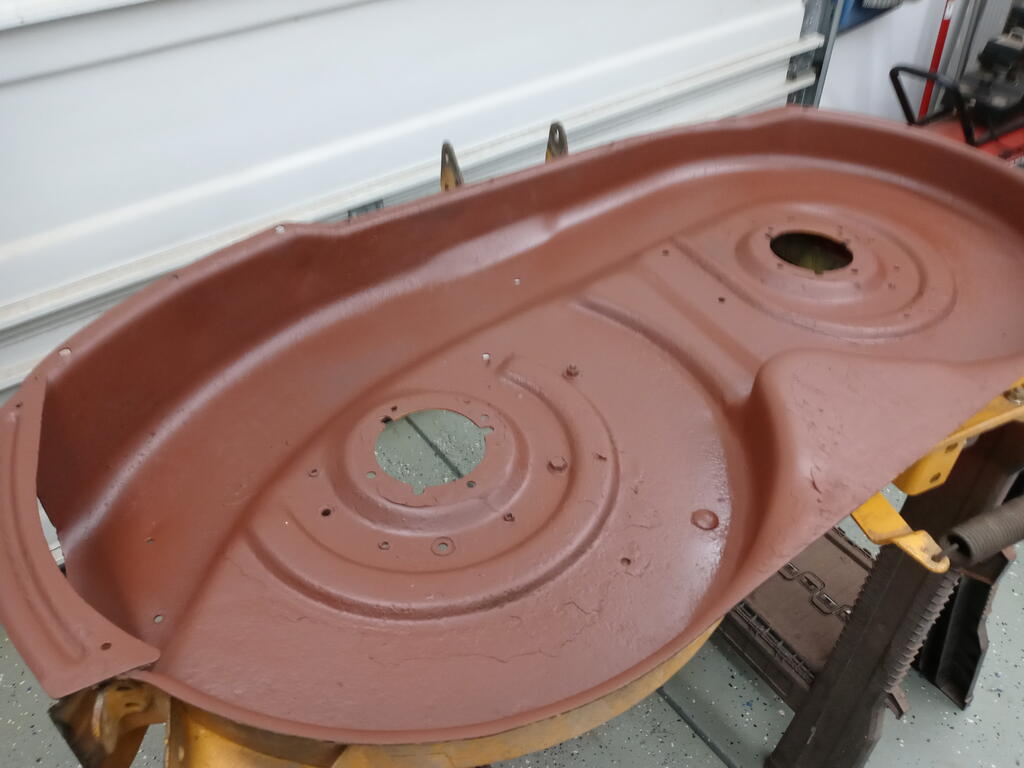

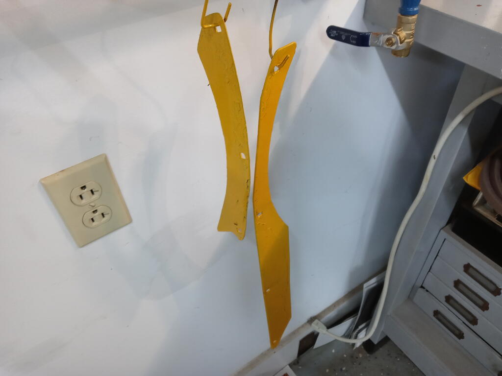

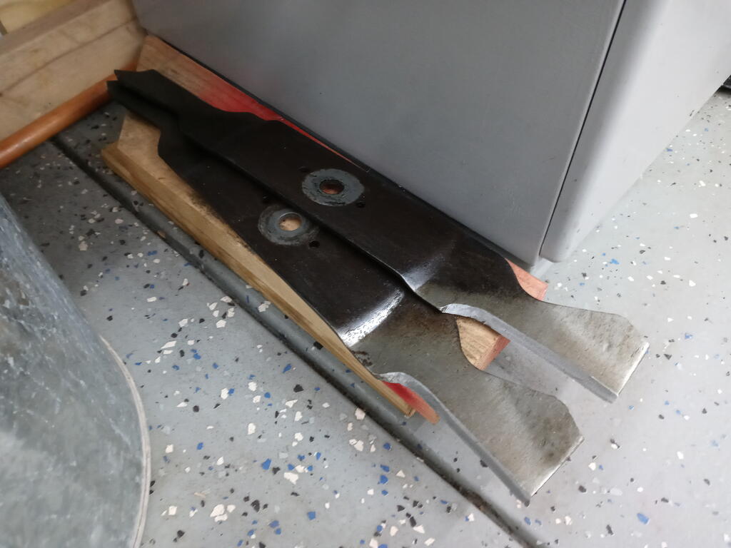

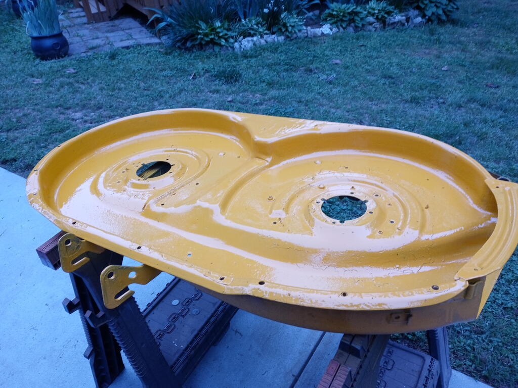

Horse Newbie 7,393 #12 Posted April 14, 2021 Sharpened the blades and primed the underside of the deck while I'm waiting on the new spindle, spindle bearings, and seals... Share this post Link to post Share on other sites
Horse Newbie 7,393 #13 Posted April 15, 2021 (edited) Painted the underside of the deck, and laid out all my parts and hardware for when the new spindle arrives... Edited April 15, 2021 by Horse Newbie Share this post Link to post Share on other sites

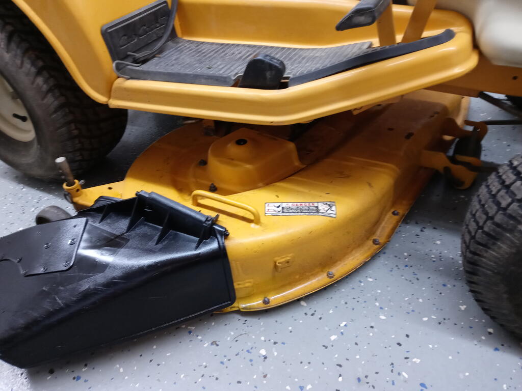

Horse Newbie 7,393 #14 Posted April 17, 2021 Got my new spindle shaft for the Cub Cadet 42 inch deck...got the spindle reassembled and put back on the deck...deck back on the tractor...will be scaring the gophers tomorrow... 1 1 Share this post Link to post Share on other sites

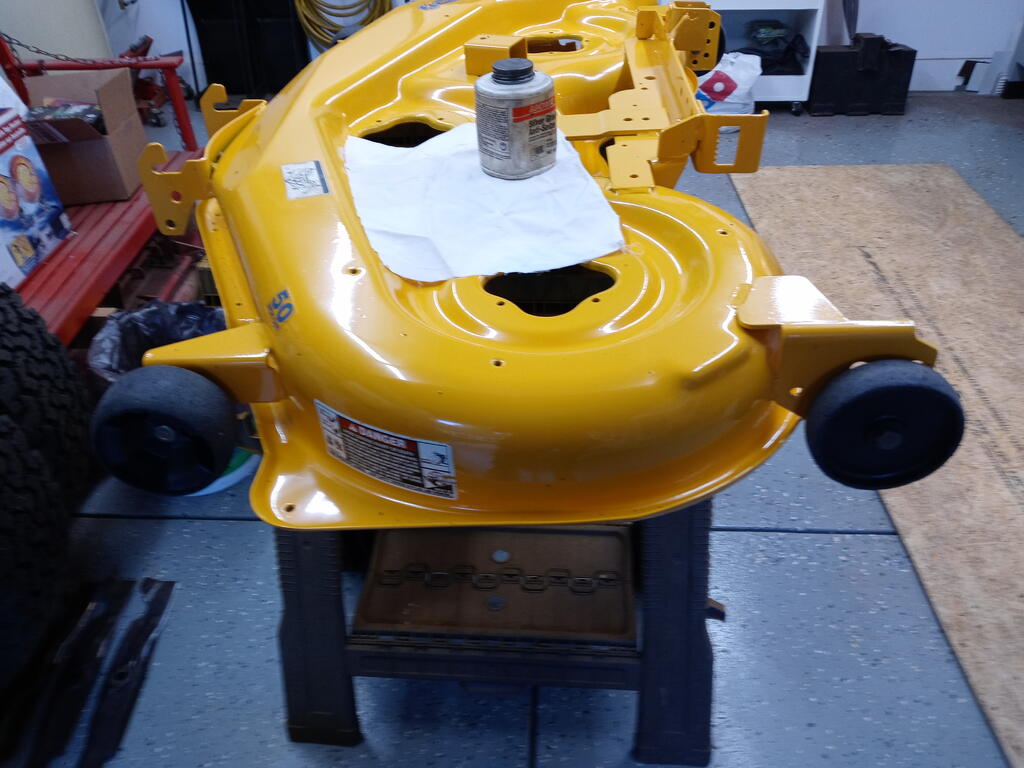

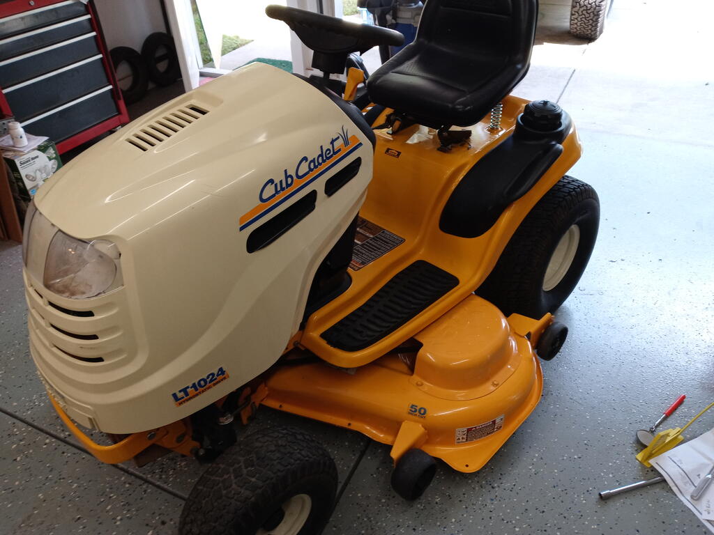

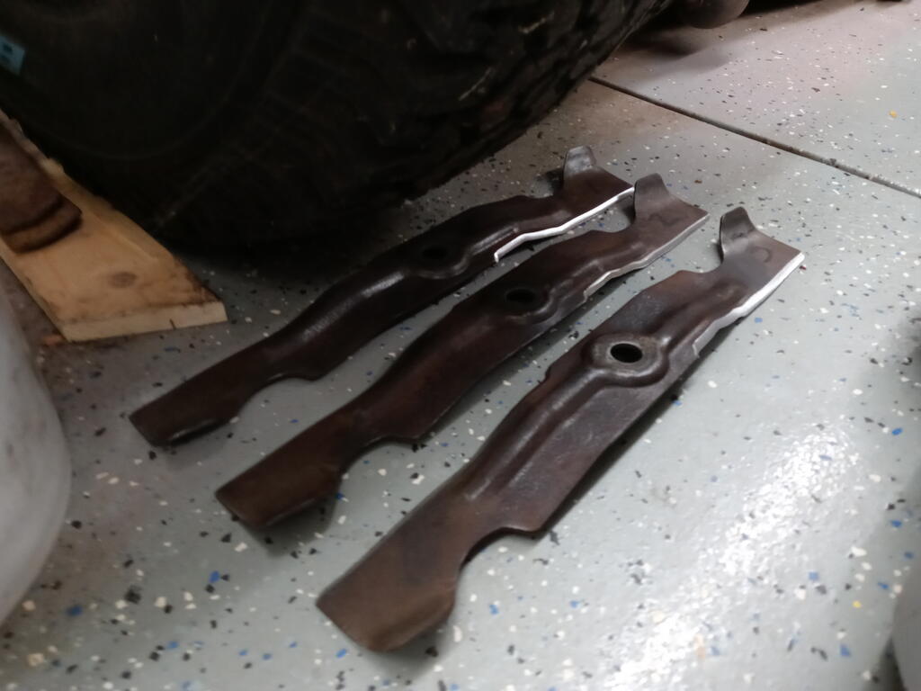

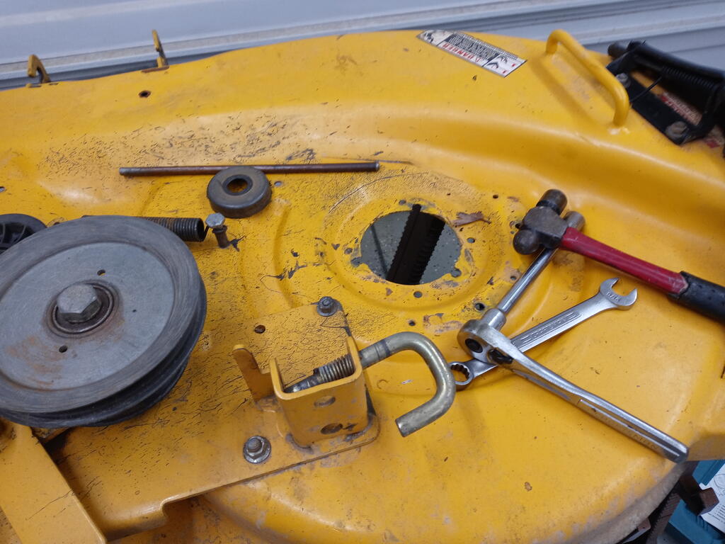

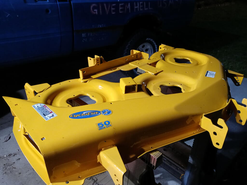

Horse Newbie 7,393 #18 Posted April 27, 2021 I know I'm way off topic as this thread started with me replacing the drive shaft barrels on my Cub 2155 HDS...but this is Cub related so I'll let you guys know what I've been doing to my big box store Cub Cadet LT 1024... I have been going through the 50 inch deck, sharpening the blades, cleaning and painting the deck, and cleaning and greasing the spindles... Admins, if I am really messing up by putting all this Cub related stuff under this one thread, by all means, let me know! Share this post Link to post Share on other sites

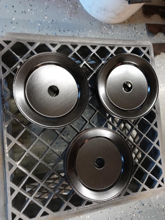

Horse Newbie 7,393 #20 Posted April 29, 2021 Painted some idler pulleys and bolted on a few anti- scalp wheels Share this post Link to post Share on other sites

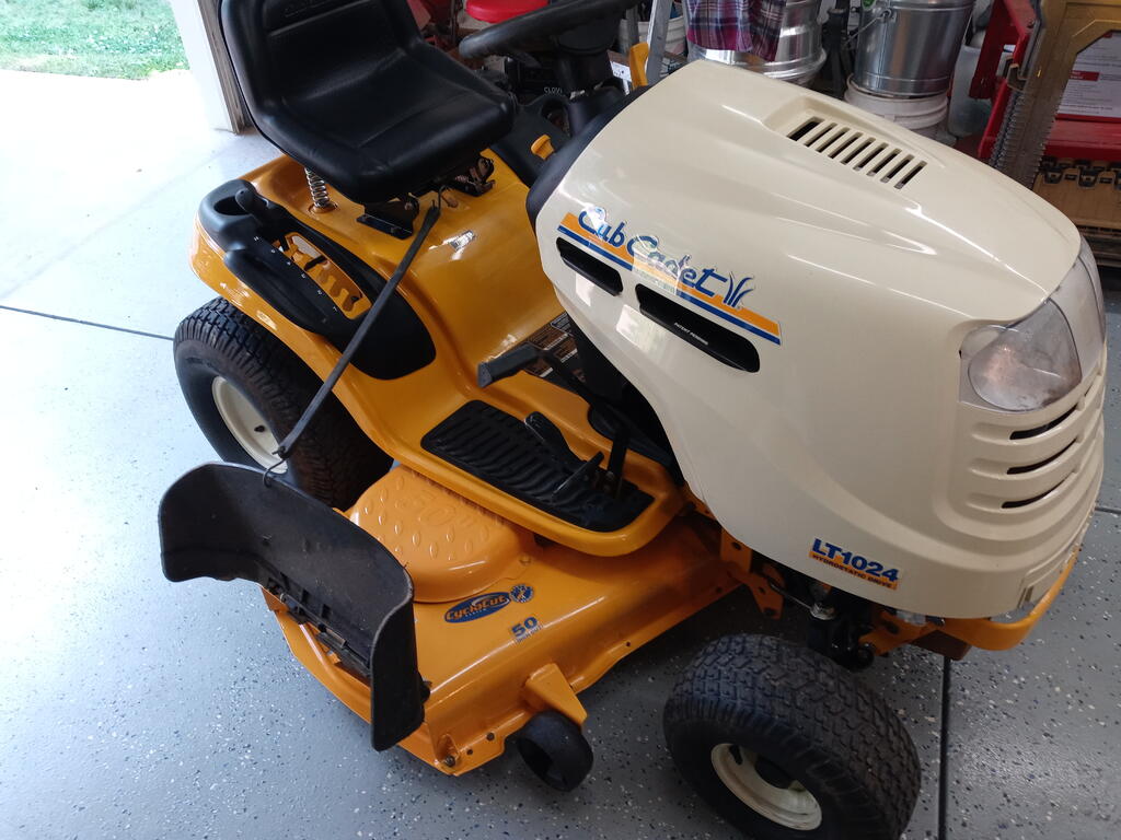

Horse Newbie 7,393 #21 Posted May 9, 2021 (edited) I should have named this thread "Messing with the Cubs", because I am covering way more than what the title says... I am keeping all my non- Wheel Horse stuff here...so I finally got the 50 inch deck finished and put back on the CC LT1024. Edited May 9, 2021 by Horse Newbie Share this post Link to post Share on other sites
