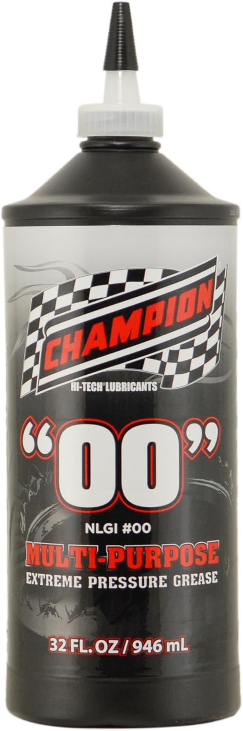

squonk 45,633 #3 Posted April 3, 2021 (edited) A lot of those old tanks used some kind of grease. I put 90w in an old Wizard tiller my Grandfather had and half of it leaked out thru the gaskets. Ariens and Oregon sells a 00 grease for their snowblower gear boxes. That's what I would use if it were my tiller. https://www.amazon.com/Oregon-4049H-00-Grease/dp/B0018U0A4C/ref=asc_df_B0018U0A4C/?tag=hyprod-20&linkCode=df0&hvadid=167146984279&hvpos=&hvnetw=g&hvrand=12263711158379401854&hvpone=&hvptwo=&hvqmt=&hvdev=c&hvdvcmdl=&hvlocint=&hvlocphy=9005158&hvtargid=pla-340483408204&psc=1 Edited April 3, 2021 by squonk 2 1 Share this post Link to post Share on other sites
Handy Don 16,022 #4 Posted April 3, 2021 1 hour ago, squonk said: A lot of those old tanks used some kind of grease. I put 90w in an old Wizard tiller my Grandfather had and half of it leaked out thru the gaskets. Ariens and Oregon sells a 00 grease for their snowblower gear boxes. That's what I would use if it were my tiller. https://www.amazon.com/Oregon-4049H-00-Grease/dp/B0018U0A4C/ref=asc_df_B0018U0A4C/?tag=hyprod-20&linkCode=df0&hvadid=167146984279&hvpos=&hvnetw=g&hvrand=12263711158379401854&hvpone=&hvptwo=&hvqmt=&hvdev=c&hvdvcmdl=&hvlocint=&hvlocphy=9005158&hvtargid=pla-340483408204&psc=1 I agree. Ariens snowblower and Snapper rider both use the "00" grease. Not expensive, easy to inject. 1 Share this post Link to post Share on other sites
rustyedge1 183 #5 Posted April 3, 2021 TSC has a Super S cotton picker OO spindle grease for 6.00 bucks a quart i've been looking at.. Seems the same . 1 Share this post Link to post Share on other sites
