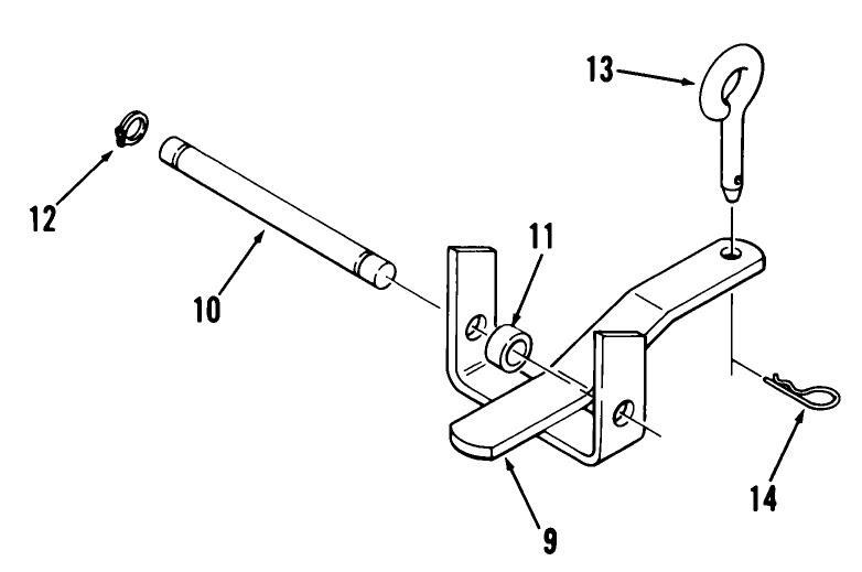

gwest_ca-(File Mod) 12,453 #3 Posted April 2, 2021 This is what would have come on a 417-8 and used to pull towed attachments. Is that what you have now? Sorry - forgot to add the drawing This is what the clevis hitch kit is like. Click on the fuzzy pictures in the links This is the last version that should fit Garry Share this post Link to post Share on other sites

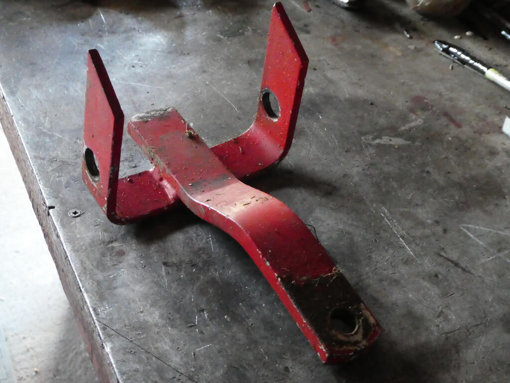

Stormin 9,988 #4 Posted April 2, 2021 This is the alternative to the clevis hitch. It's what I use for towing a roller etc. 1 Share this post Link to post Share on other sites
